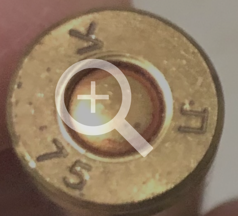

    No.4T Tav.
    Quote Originally Posted by jonnyc View Post
    @Blimey...
    That doesn't look like any Hebrew letter of IDF marking to me.
    Cheers.
    The rifle is supposed to be a Hagenah capture from the Britishicon in the period 1945-1948 and pre-date the IDF. Could the marking on the butt could be a "Tav"? One of meanings of this letter is "Life or death" which certainly applied to Israel pre 1948.
    Same as the Tav marking on this pistol round.

    "One of meanings of this letter is "Life or death""
    Where did you get that from?!?!?
    I speak and read Hebrew, and I don't see any Tof there.

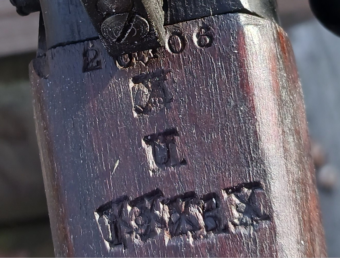

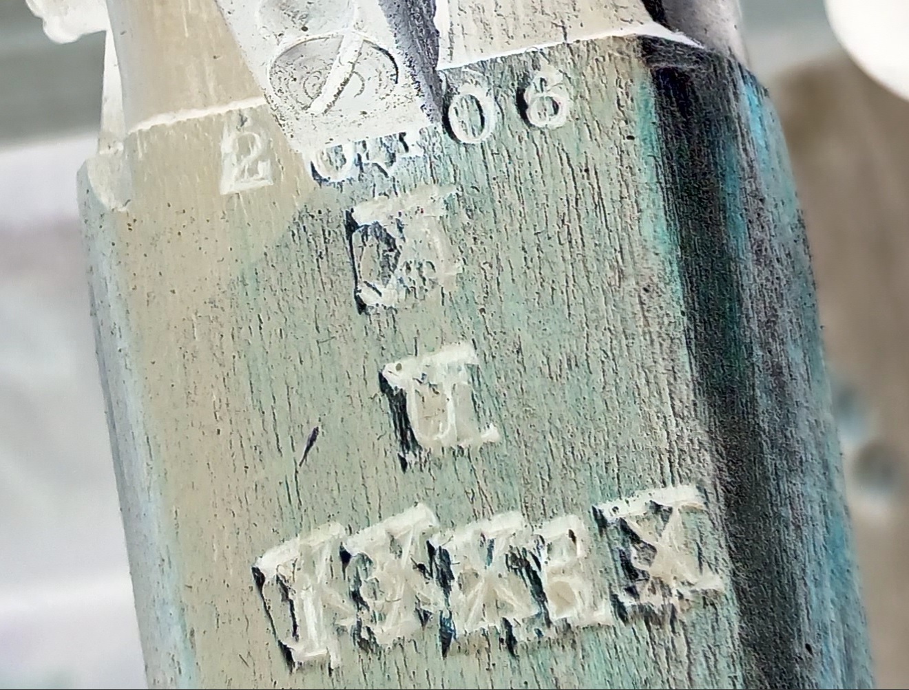

    Anyone see the Enfield examiner's mark? I don't.
    The marking on the cuttoff block is obviously fake as well.
    "TR" is wrong and I don't see a "T" either.
    The over-stamping of purported numbers is probably just bubbas attempt at creating a "history".
    Could be an Israeli conversion I suppose, but don't know enough about those to say. Certainly was never a Britishicon conversion IMHO.
    What is 20 06 suppose to represent?

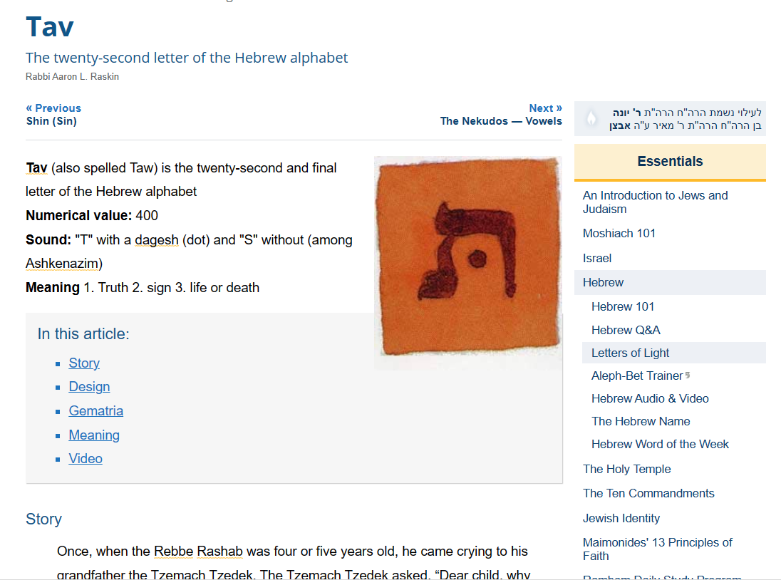

    Jonny - I got it from this website. Isn't it correct?

    Quote Originally Posted by Blimey View Post
    At a minimum - the letter (n with a stop on the left hand side) on the cartridge rim bears no resemblance to the letter you show in the picture (n with a stop in the centre of the two legs)
    So, if one of them was a Tav then the other one isn't.

    That source is so esoteric that it verges on the useless. That 'meaning' never would have made the leap from a rabbinical seminary to an armorer.
