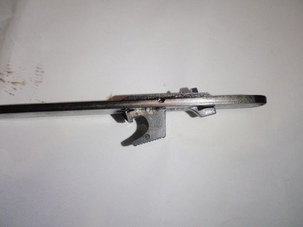

    What I would very much like to see clear pictures of is the 'Ejection Opening Cover Catch'.
    Don't know if it's easy to remove, hope it is.
    The one I've modeled now would probably work, but it isn't based on solid, detailed information.

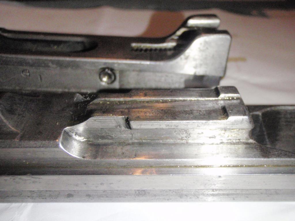

    Seems like there is always one more pic I should take. A stop screw in the lower keeps the the latch pin from lining up with a hole in the lower. Remove the screw, align the holes, and push the pin out. Can you "stamp" the E in the D on your latch?

    @SNAFU22 Thank you very much for those photo's !
    They are of a newer version of the catch than the more curved Mk1 model, but functionally they should be very similar.
    There is a small vertical projection, or pin, in the sliding cover itself that I haven't seen before.
    Haven't got a clue what that is for, but I assume it is some kind of improvement.

    There were several variations of the catch, cover, ejection opening. The last version was one of the last modifications for the L4 gun. I seem to recall that it had a longer 'catch' part so it would engage and hold open a few mm's sooner.
