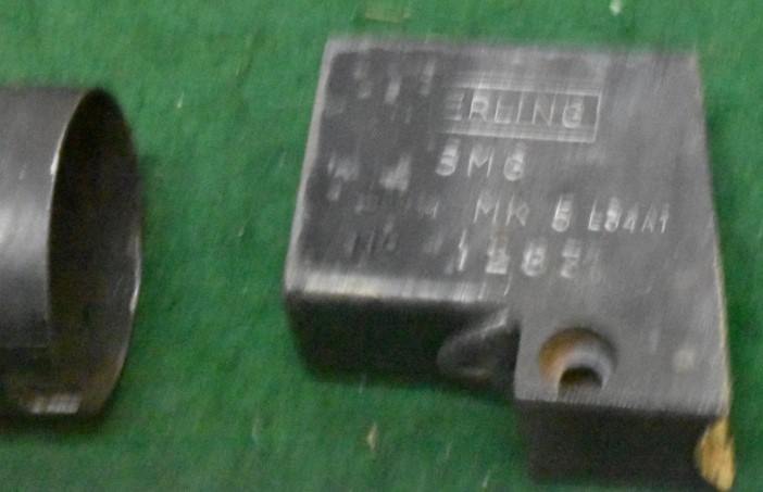

    notice the marking overwritten below the Mk5 designation

    Ah, yes..... Well spotted. The L designation, such as L2A3 or L34 was often - but NOT always - stamped after the commercial Mk type designation to indicate the gun was in fact identical to the UKicon Military L2 or L34 gun and as a result, the spare parts, and what you were getting/buying were one and the same. It also informed UK Armourers where ordnance resources were pooled, such as Malaya etc, that a 'foreign' gun that came through was a big standard L2 - or L34.
    The miscellaneous instructions EMER did mention that in operational theatres where Ordnance stocks came from pooled resources, Armourers and quartermasters should be aware that gun serial numbers would not always conform to the accepted standard. We did see quite a few RNZN, New Zealandicon Navy, marked commercial L2A3's from the Naval dockyards at Sembawang

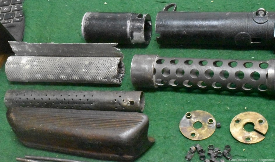

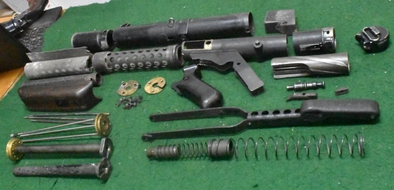

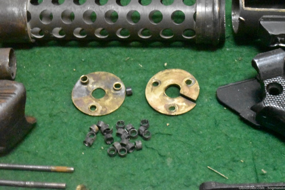

    1283 demilled in USAicon on Gunbroker.
    https://www.gunbroker.com/item/1011695123
    there are 2 muzzle supports and 6 tie rods, indicating that perhaps, 2 guns were destroyed.
    odd that the diffuser wrap and diffuser tube show signs of being destroyed/damaged.
    really interesting photos showing the spacers between the baffles. and the 2 brass end baffles.

    Looks to me, looking on as an amateur, that this is a made-up gun. Made up from an Mk4 casing. Can't say for sure but the blurry indistinct image of the magazine housing says a lot
    Says Mk 5 L34A1

    Yep, I can see that Jim, but it ain't engraved or roll pressed in as I am used to seeing one or two of them. And what is lurking elsewhere....., that we can't read?

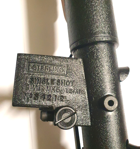

    11:46 AM
    S4212
    Edit: not mine. UKicon dealer pic.

  10. #78
    06-08-2025 @ 08:51 AM
    out there
    1,863
    03:46 AM
    S4212

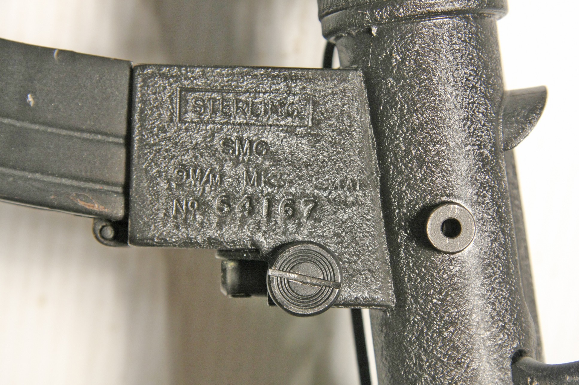

    Thank you for the photo - that is a large step from S4167 (the previous high number noted).
    Attachment 123526
    Here are the two currently highest known serial numbered commercial Sterling Mk5's serial # 1597 & # S 4212. The (Guns of Dagenham) book estimates 3500 commercially manufactured, but these serial numbers confirm that estimate as being quite low.
    1597 + (S) 4212 = 5809 (by adding the two highest serial numbers);
    However PL below states that he believed that Mk5 serial numbers may have restarted at S 1001, if this is the case, the known extant serial numbers would indicate that there were at least 4,809 commercial Mk5's manufactured.
    In GoD, PL & DH show (in the early 1970's) 50 unit conversion batches of Mk5 SMGs, if that remained true for all production, possible totals would be 4,850 (based on restarting at S 1001).
    now we just have to watch for serial numbers "no letter pre-fix" above 1597 and "S" prefix serial numbers below S 1001 and above S 4212.

  11. #79
    Oct 2009
    Europe
    1,889
    11:46 AM
    I'd want to point out that the inscription additionally carries a "SINGLE SHOT" marking atop the designation that you do not find on the next lower number known. The original description to the pictured sample btw reads as:
    Fires from closed bolt, folding stock, semi-auto, raised sight blocks
  12. #80
    out there
    1,863
    03:46 AM
    It would be very interesting to confirm that it is closed bolt.
