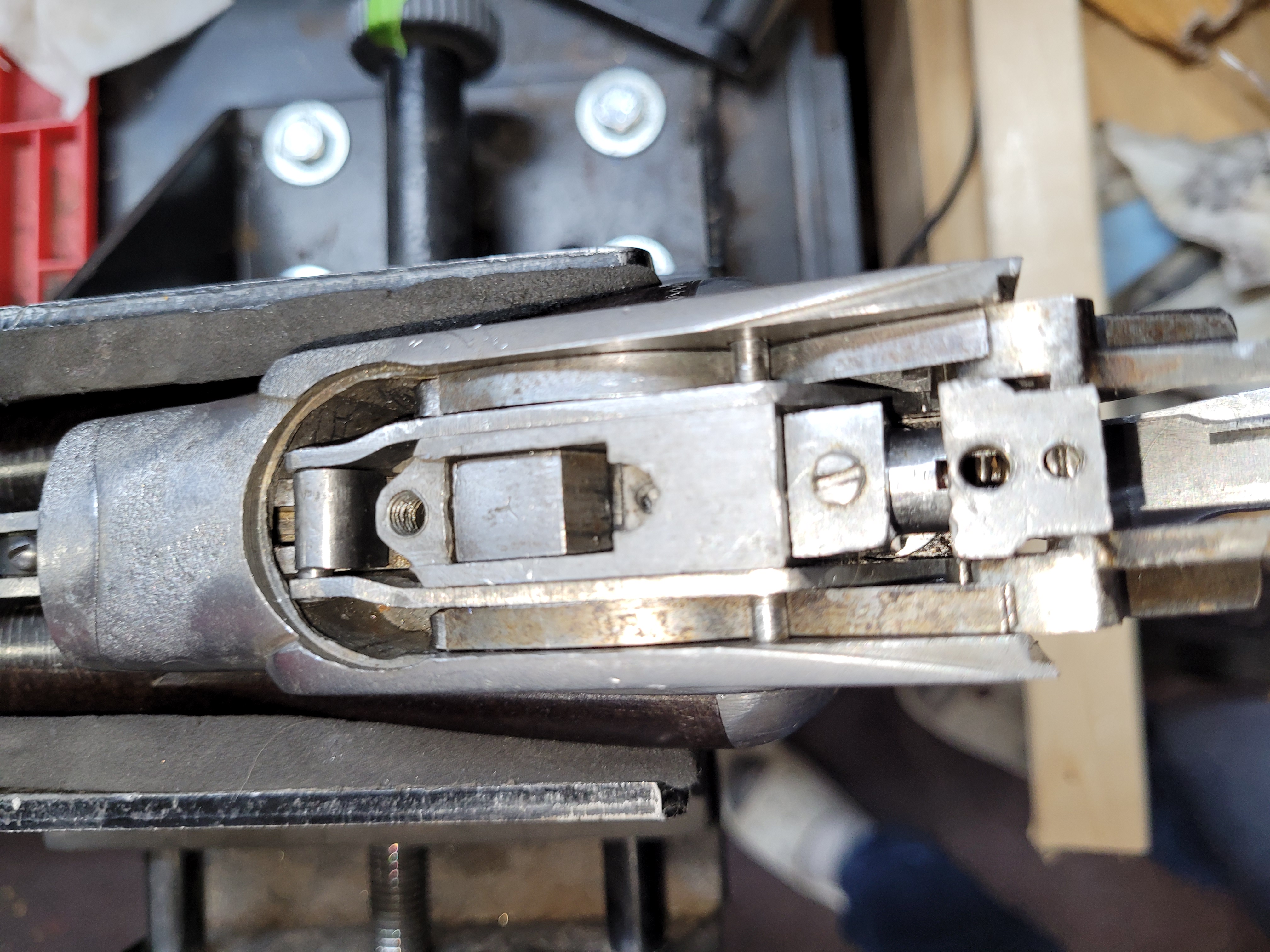

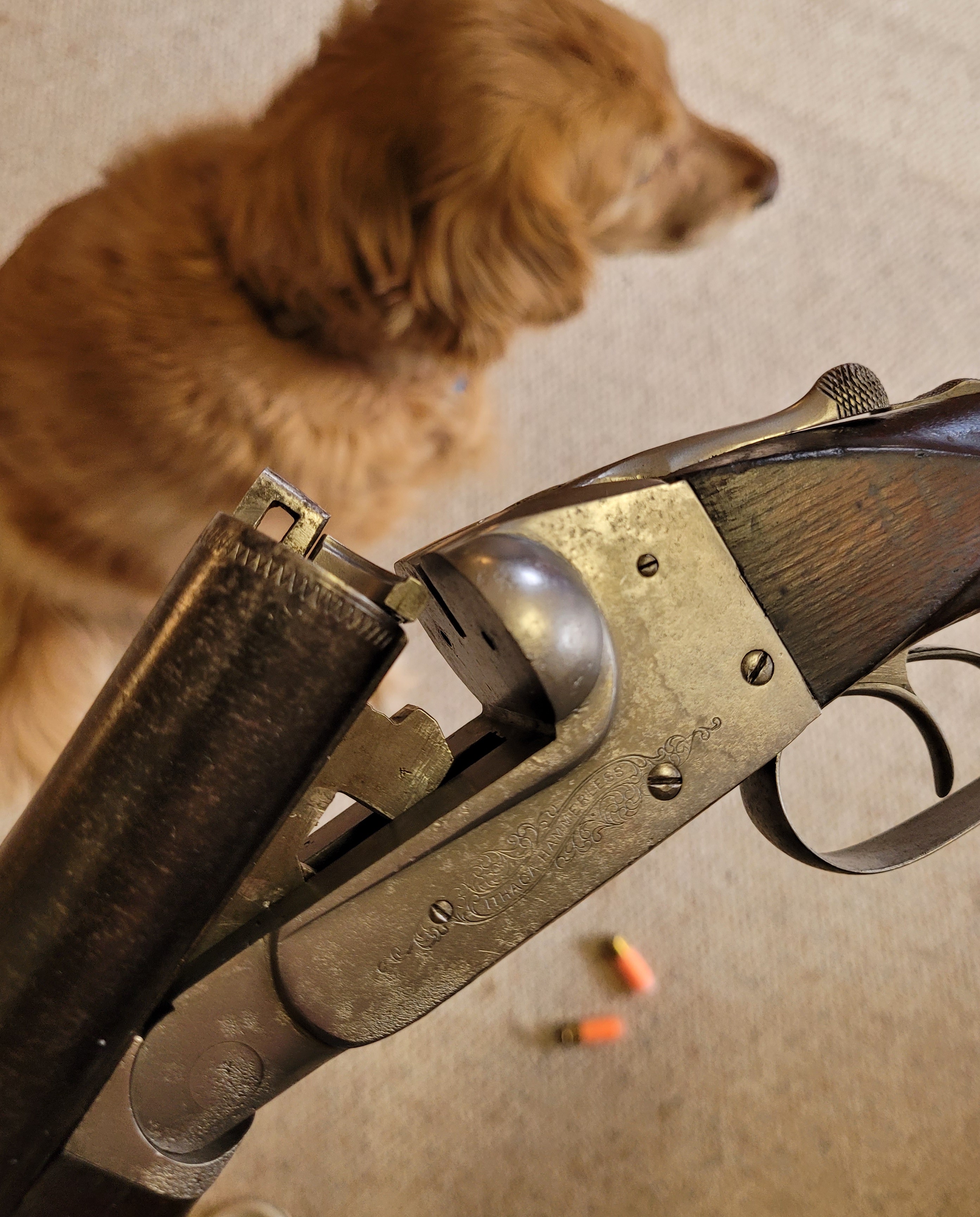

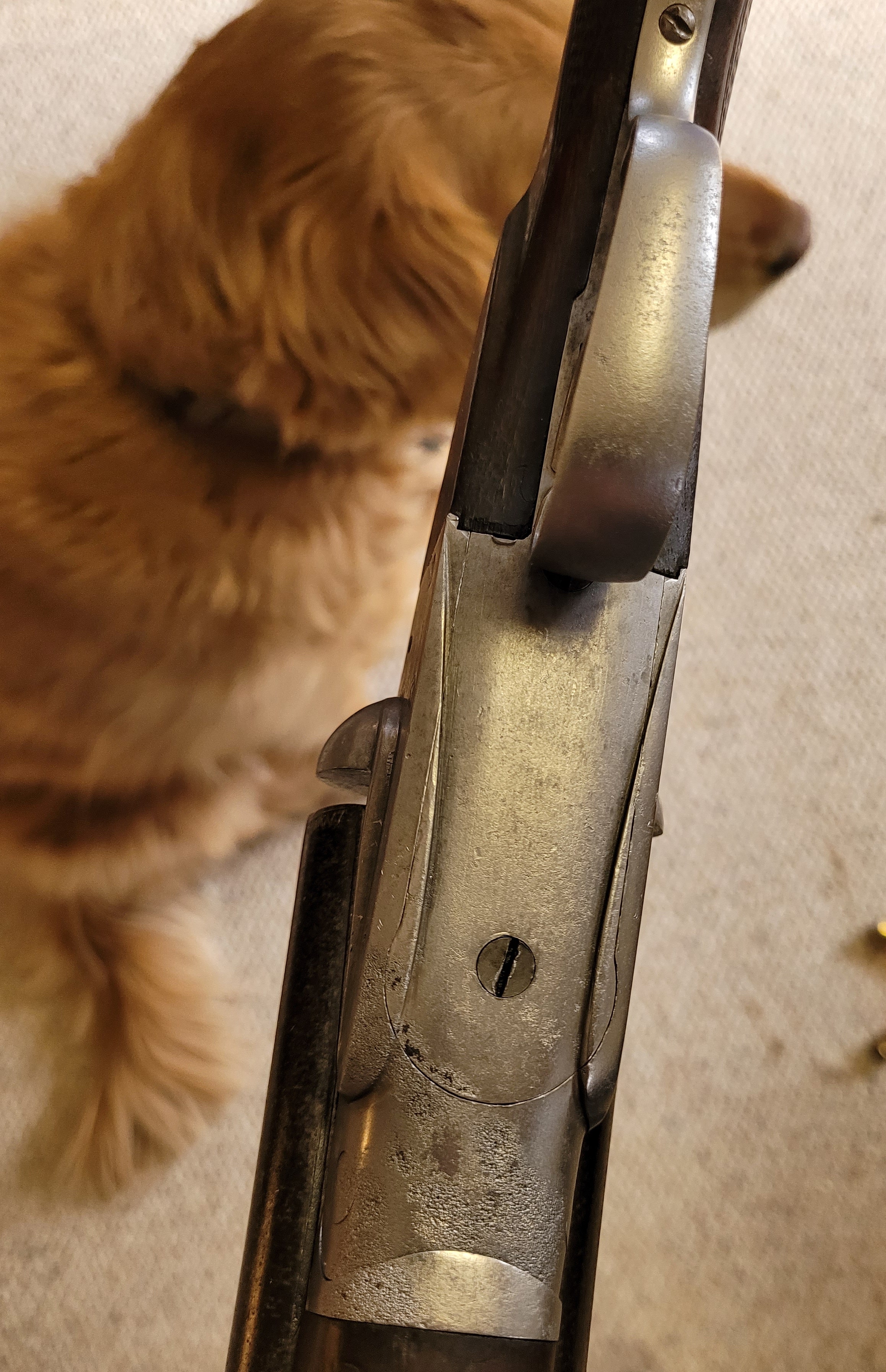

    spent several evenings this past weak soaking parts that weren't originally blued in evaporust overnight and cleaning them up. Today's goal was then to figure out how it all goes together in order to make sure sure I had everything. Well, I certain it is all servicable, but I am missing a couple minor parts.
    - The top-lever tension spring I already mentioned. I have what I think will work from the older crass model on the way from Numrich. No big deal. There is some backlash in the top lever with out it, but is of no consequence
    - I'm missing the trip pin and flat trip spring, which locks the top lever to the right when opening, and automatically release to lock when closing. I think I can make these myself pretty easily.
    - I'm missing the safety bar and the safety T-bar which make the thumb safety work, and automatically engages the safety as the hammers cock during opening. This doesn't affect safely shooting or test firing from a bench, but I would never carry it loaded afield without. I have a picture of what I need. The T-bar I can make easily enough. The safety bar has some bends in it. I would need some measurements from someone to make one.
    That's it! all else is in working and serviceable order. The main spring install threw me for a loop last night and all morning. But once that was figure out, it's all actually pretty simple.
    Some pitting on the underside receiver to polish out. I'll 3d print some special sanding blocks to preserve the edges and contours. Now that it's stable and no longer deteriorating, I will likely take my time to finish it, given the couple missing parts and all.

    Nice looking dog too!

    The safety bar - the part that would be the most impossible to make - was found at Numrich. Much of the parts for the Crass hammerless and Lewis are the same. It wasn't expensive, so worth a try. Still much to do get things working - including the dog. She is itching to get out, literally

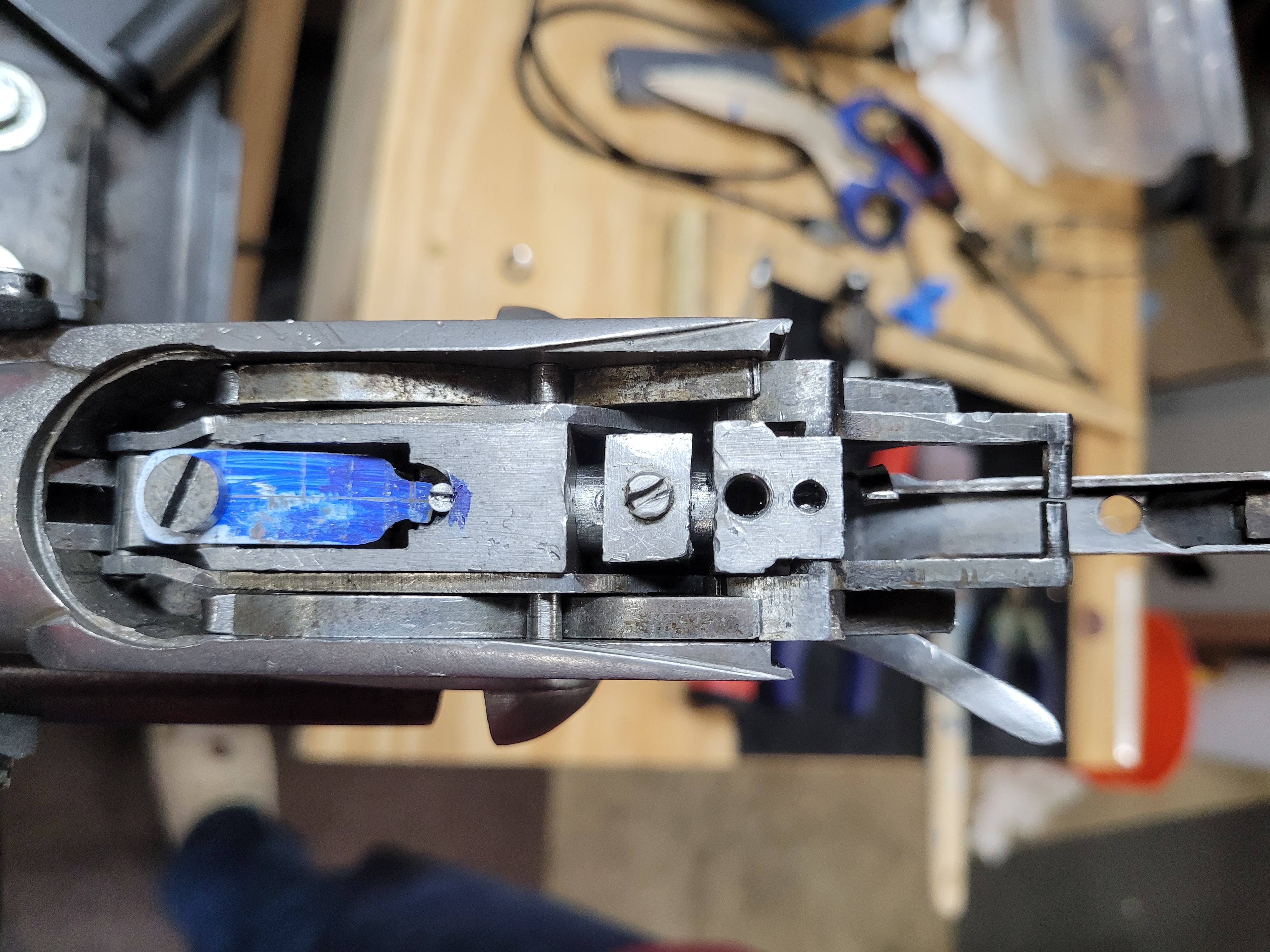

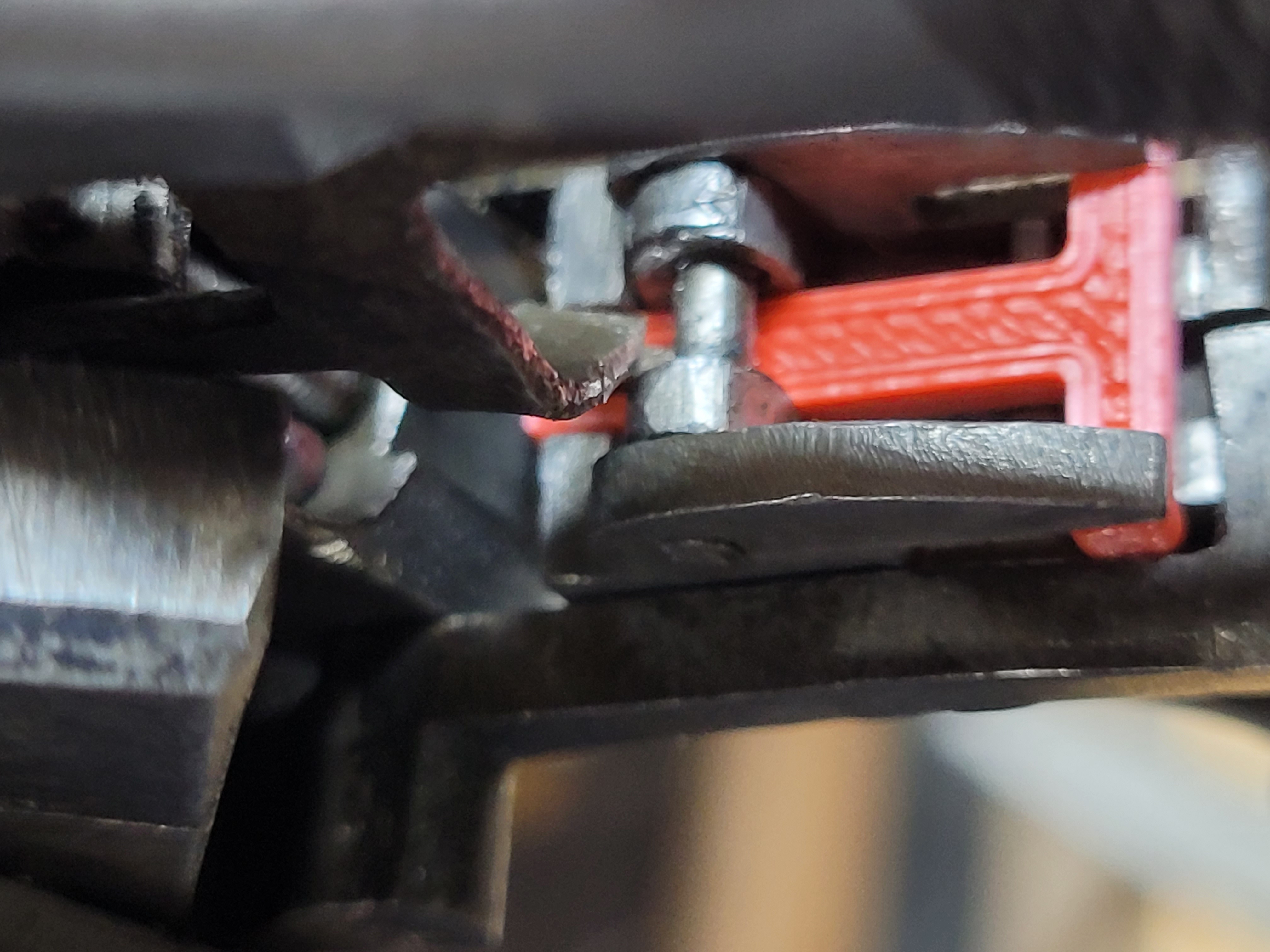

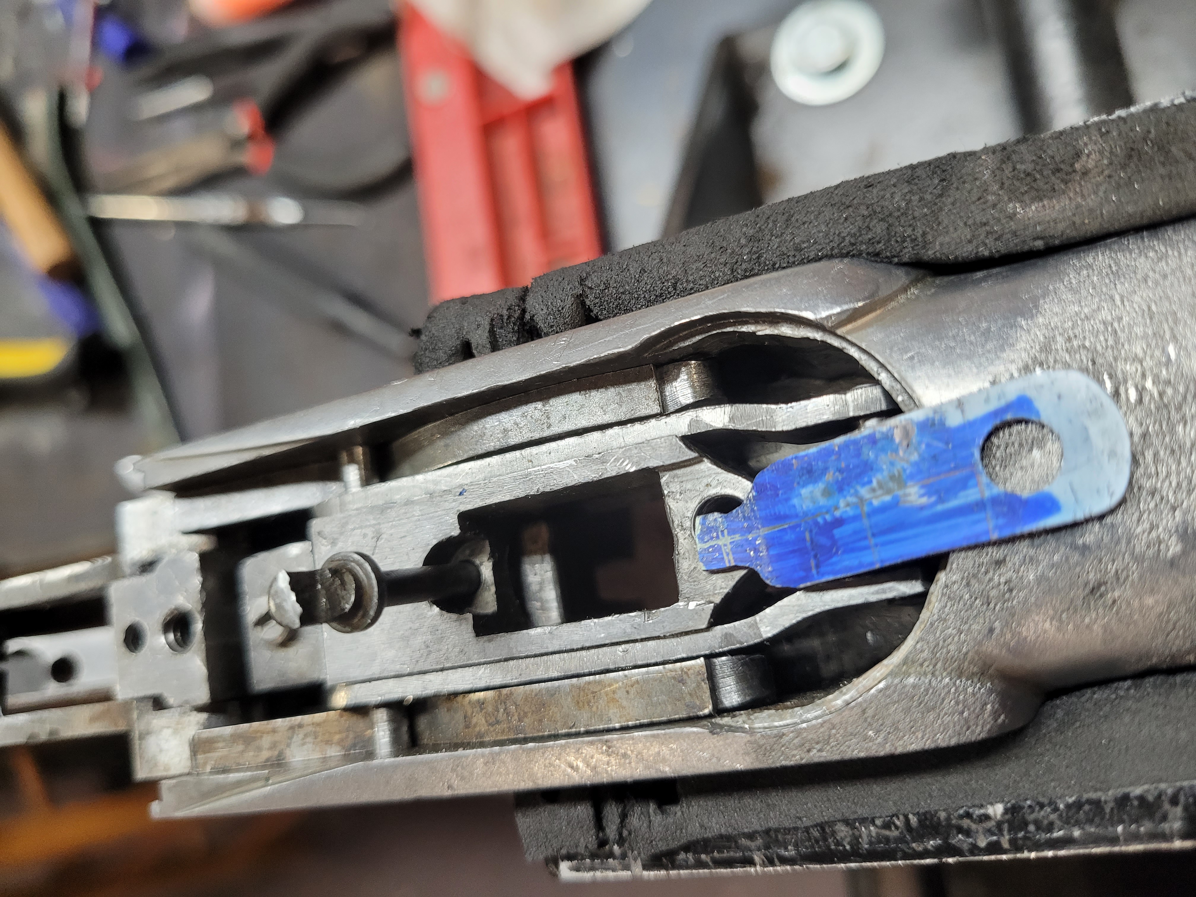

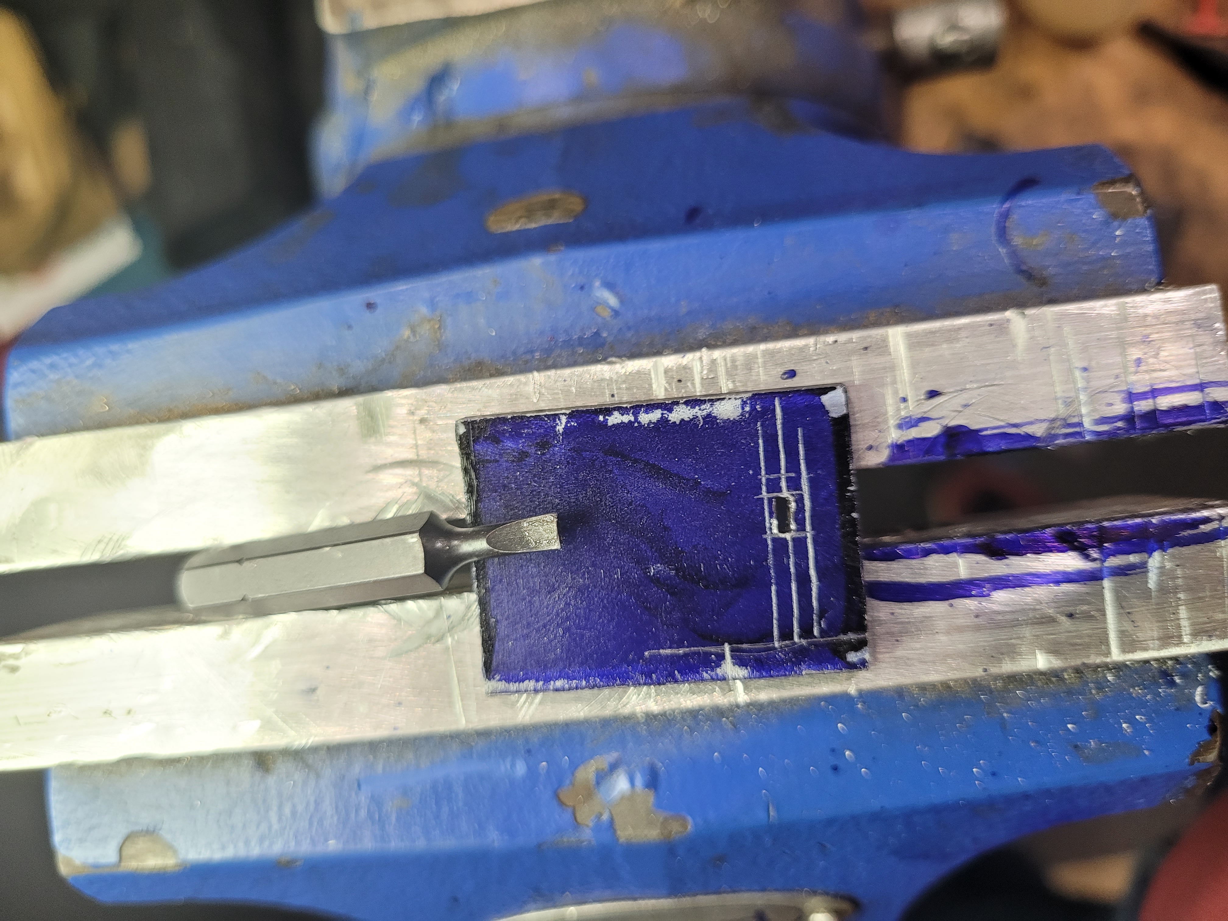

    I was able to fit the safety connector. I made a trigger lock (T-bar) from scratch and fit it up by first 3d-printing several attempts just to figure out how everything is supposed to function, and then use as a pattern to make a permanent one out of steel. I found a good picture of one next to parts I already had so I could get some relative measurements to start with. In this process, I figured out that these old side-by-sides have a 3 position safety. Forward is fire+auto-safe-when-opening, middle is safe, and rear is fire without auto-safe. Neat. Anyways, all this works as intended now. After drilling 2 holes for the slot (which is only 0.045 wide) I did the best I could to open up the middle with a small centering bit, and then used some flathead screwdriver bits to break the middle and broach the slot open and most of the way so that cleaning it out with a small centering bit would make get the tab of the safety connector to slip in.
    It was delicate to fit. First I fit the connector so the notch in the tab fits against the trigger pivot pin with the safety in the rear position. This then provides an index measurement for the slot on the trigger lock bar. The hardest part then was evenly removing about 0.040 of thickness from the 1/8" bar stock by hand with a file. In the words of the great Obi-Wan Kenobi...patience. This took me 2 evenings.
    Next up, make a trip spring and pin.
    The spring was made from an old hacksaw blade. It's a bit thin, but I was able to confirm in another forum that the original is 0.038 thick, and my blade was 0.024. I have an old sawzall blade that is 0.040 powder coated, so I will likely make another. I made the trip pin out of the original left firing pin which had a cracked head. Does this count as an original part? The pin has a notch that engages the spring. I slotted the top to make it easy to align the notch when assembling. The trip assembly locks the top lever to the right (bolt unlocked position) when opening, and snaps the bolt closed when closing the action, without the need to touch the toplever.
    So that's basically it. The gun has all its parts now in working and serviceable condition. It will likely sit on the shelf for a while now. Next up will be to fix the stock and/or carve a new one, then raise the dents in the right barrel. I also noticed the muzzle of the right barrel is out of round from bubba dropping it likely. That will need swage out. I might beg one of you guys with a lathe to make me tapered swage once I pull the measurements. Lastly, I'll clean up the screw heads and refinish. The barrels look pretty good. Will probably only need a single rust blue pass, without stripping/polishing, and a quick dunk to re-etch the twist pattern. For the frame, I'm thinking some faux color case, https://steelfxpatinas.com/product-c...-starter-kits/. In my experience, real color case finish is pretty much just as delicate as cold bluing anyway. I don't mind a little lipstick on a pig.

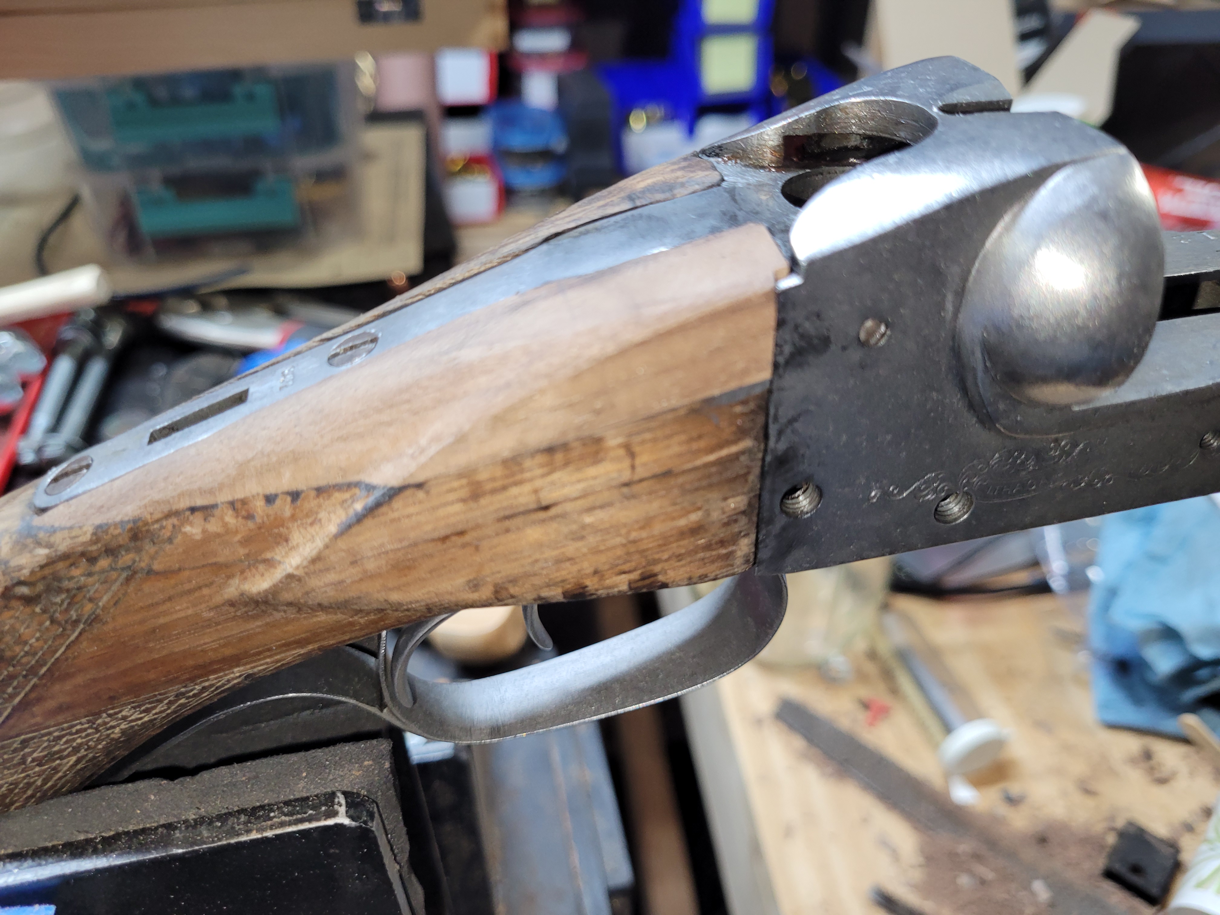

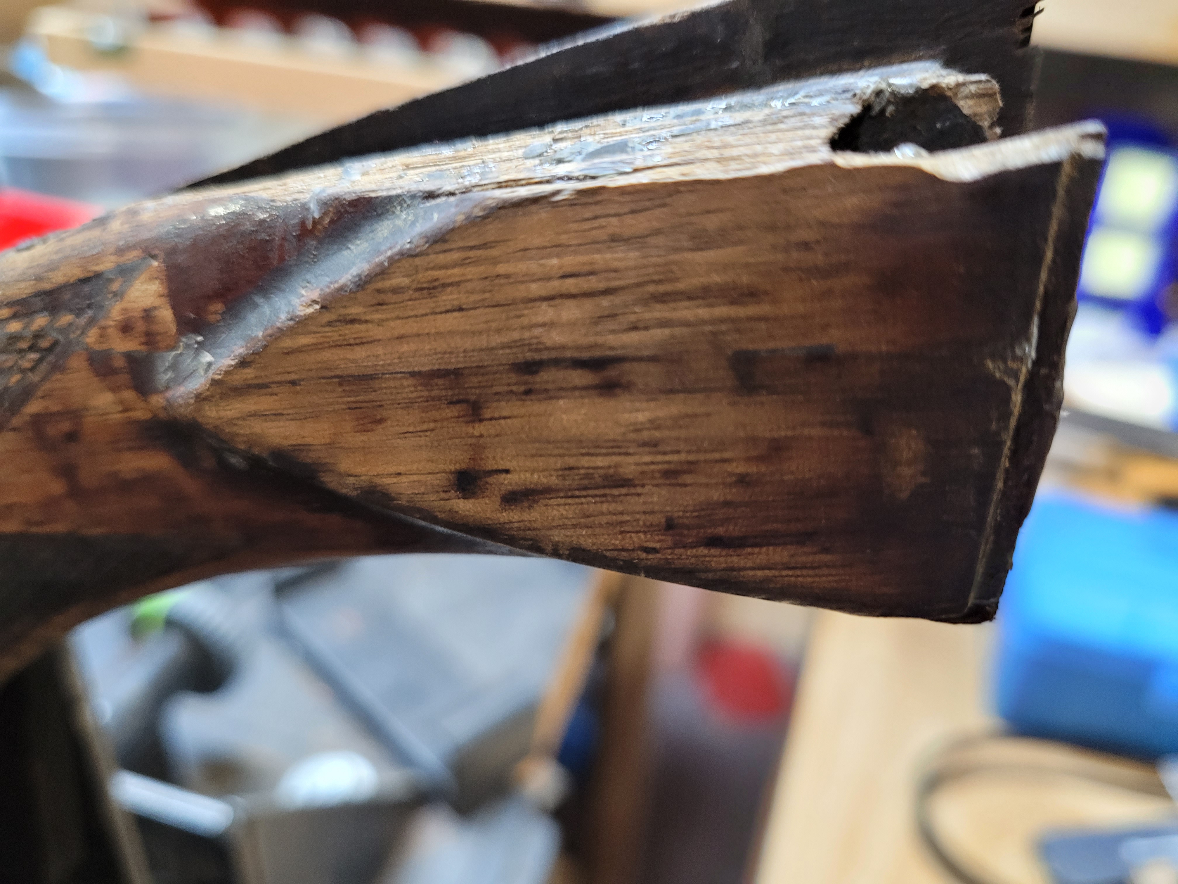

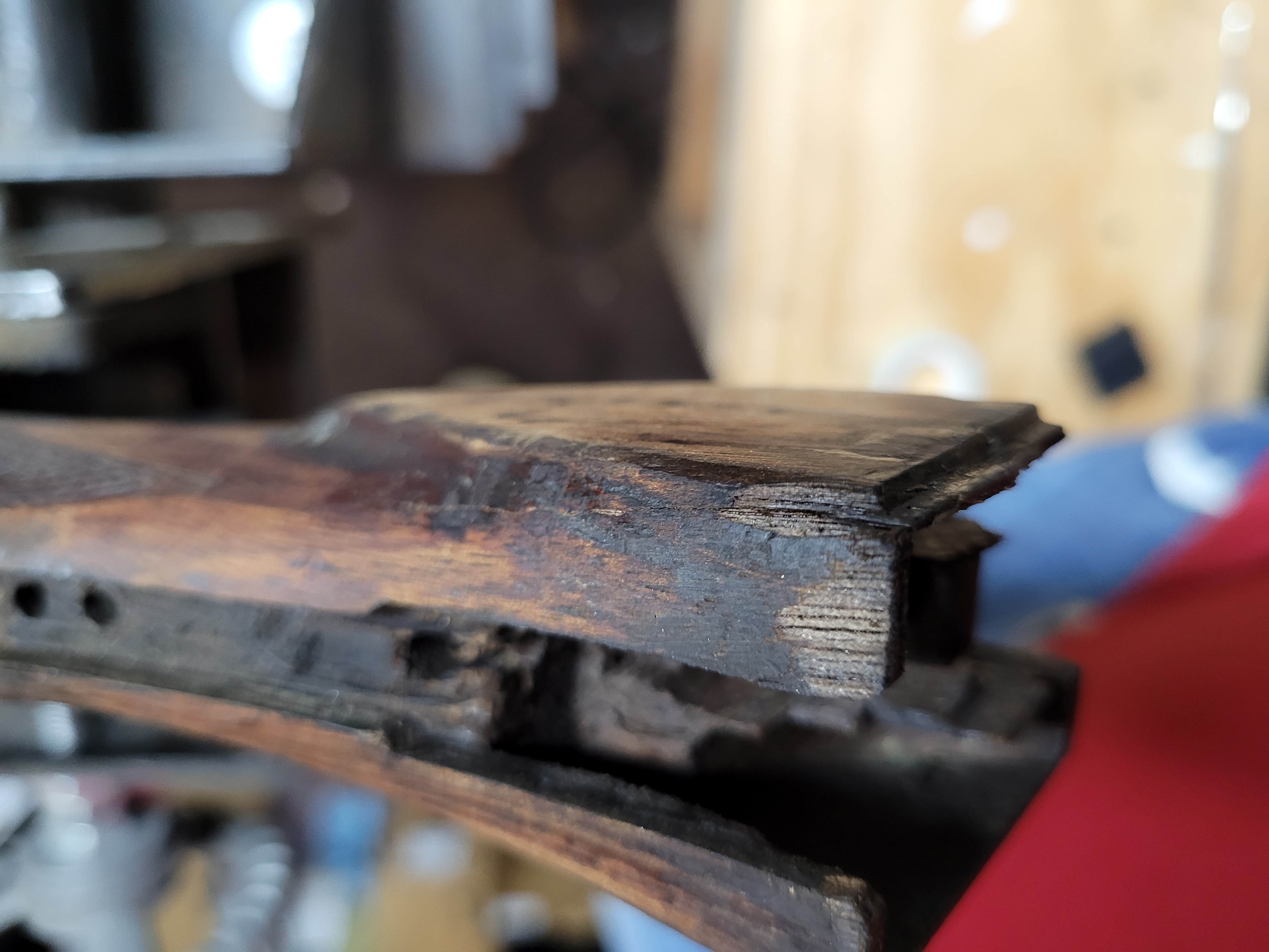

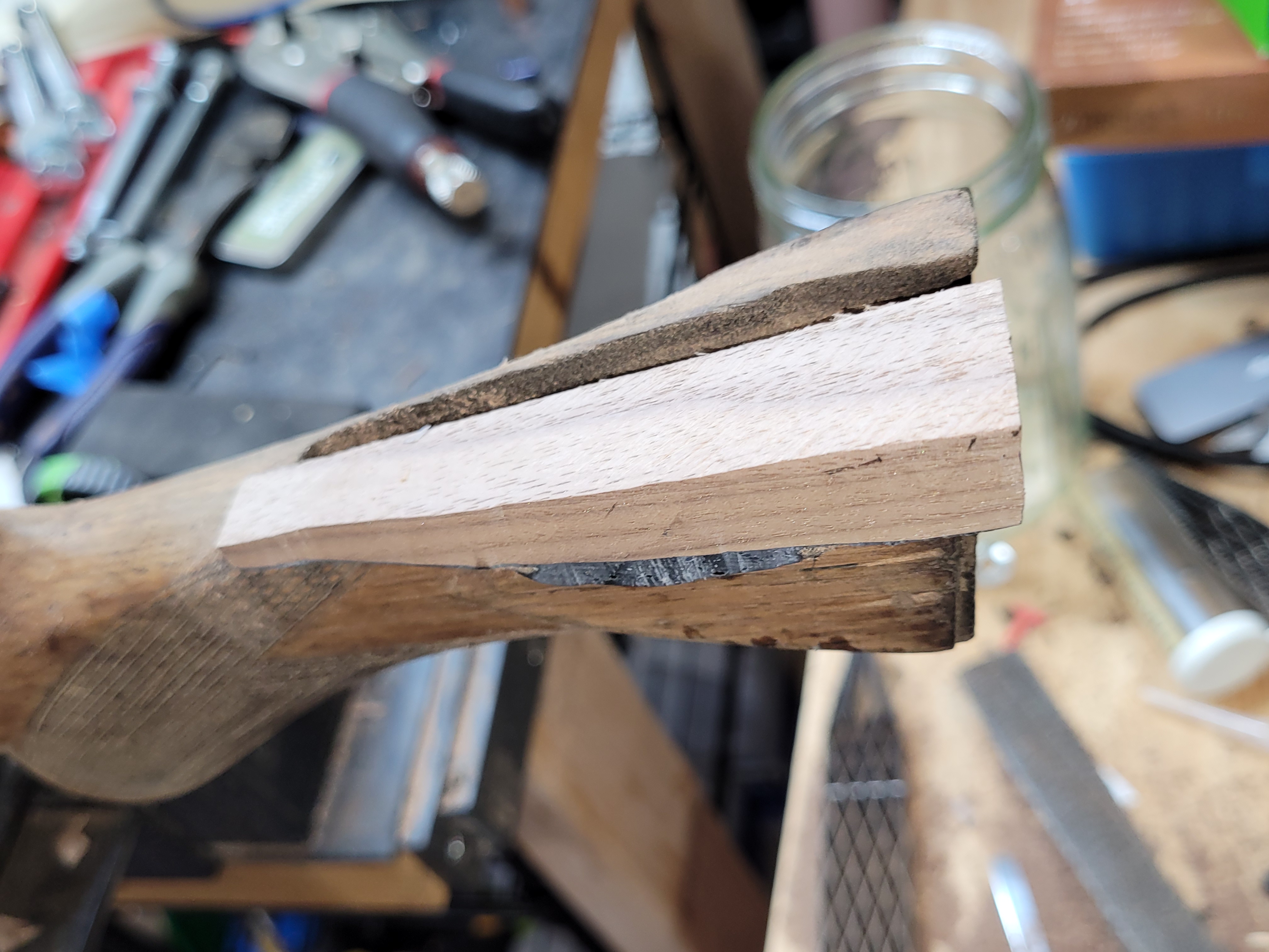

    Stock work this weekend.

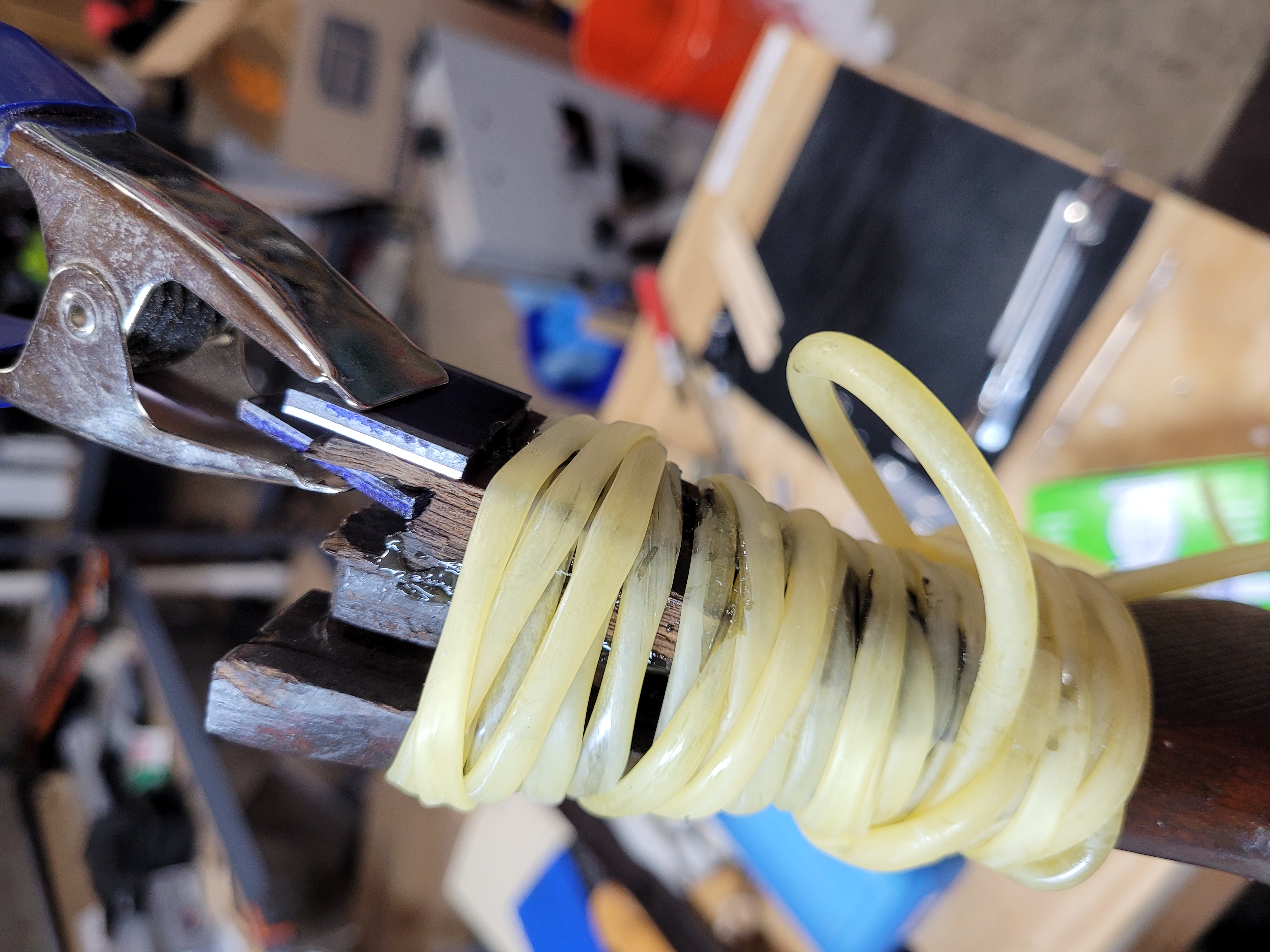

    Got the shard that I had glassed back on. When cleaning up the area today, I went ahead and removed the filth and finish with a cabinet scraper so I could see the grain enough to select a replacement block for the top piece that I am missing.
    There are a couple other small blowouts underneath, either from the same loose stock issue that that created the large blowout up top, or bubba trying to pry off the bottom plate. Too small to fit a replacement piece. I'll probably acraglas those areas (dyed to match) when re-bedding the frame to the stock. Not trying to hide all the damage, just trying to pass the 10ft stare test.
    Next we have a top block to fit, some dents to steam up, checkering to chase,....lots to do.

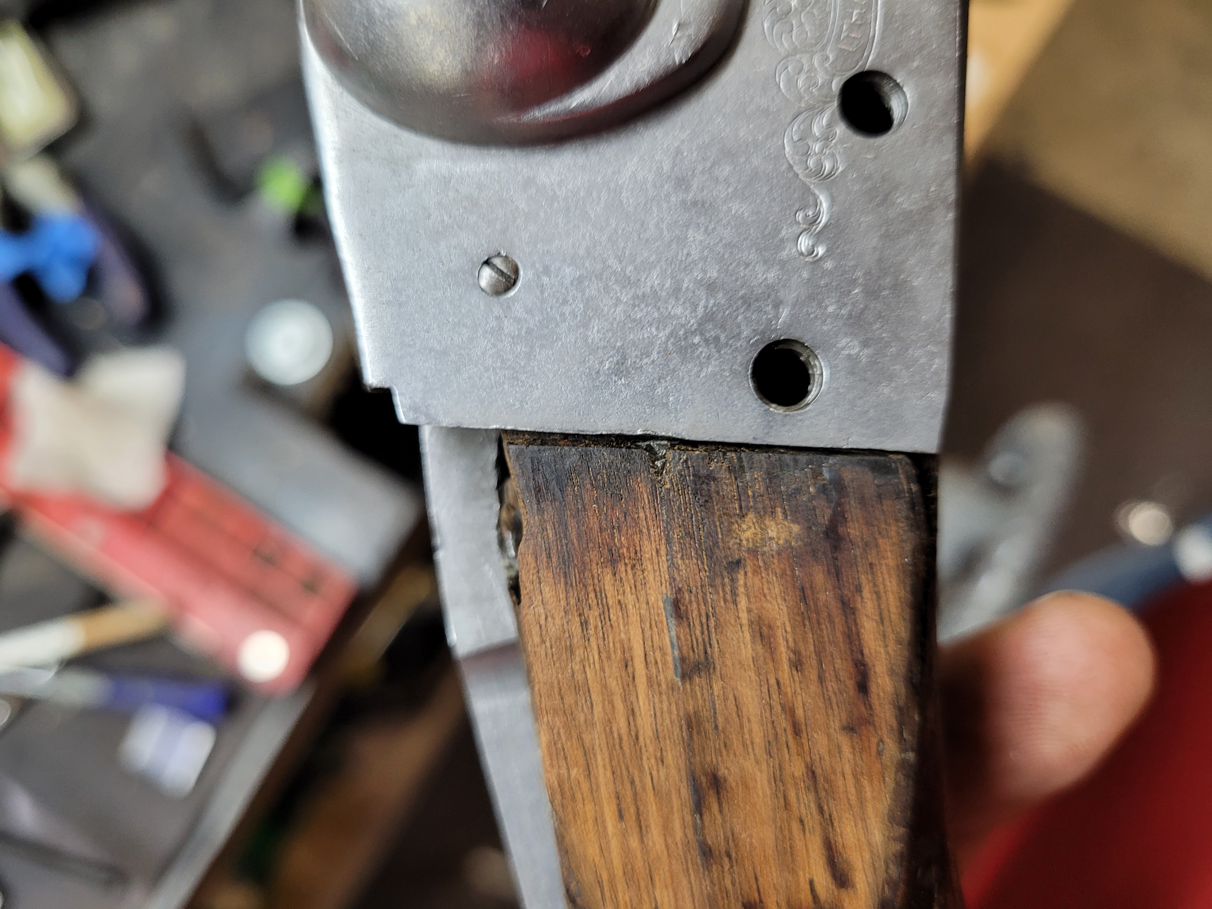

    After scraping, I decided to soak the front half of the stock in acetone to pull out as much oil as I could from the end grain before proceeding.
    I made my replacement block and glassed it on, let it set up overnight then worked it down to rough shape. Lastly, I re-inletting the frame.
    Lot's to do yet. Need to get the gap at the frame edges just right, level the top of the new piece to match the other side - the tang stands proud towards the rear, so we'll match that. I'll glass bed the recoil area inside so the blowout never occurs again. I'll fill in the tiny missing pieces underneath when I do this. Most all the dents should steam up, and the scratches aren't too deep to sand out. There are a couple knicks around the buttplate edge to deal with. I can fill those in with dyed acraglass. I'm planning on a darker staining with reddish undertone to hide the repair as much as possible. The filled in areas will then disappear at the 10ft stare test.

    Looks pretty good, once it's stained or oiled you'll have a hard time seeing the difference.
