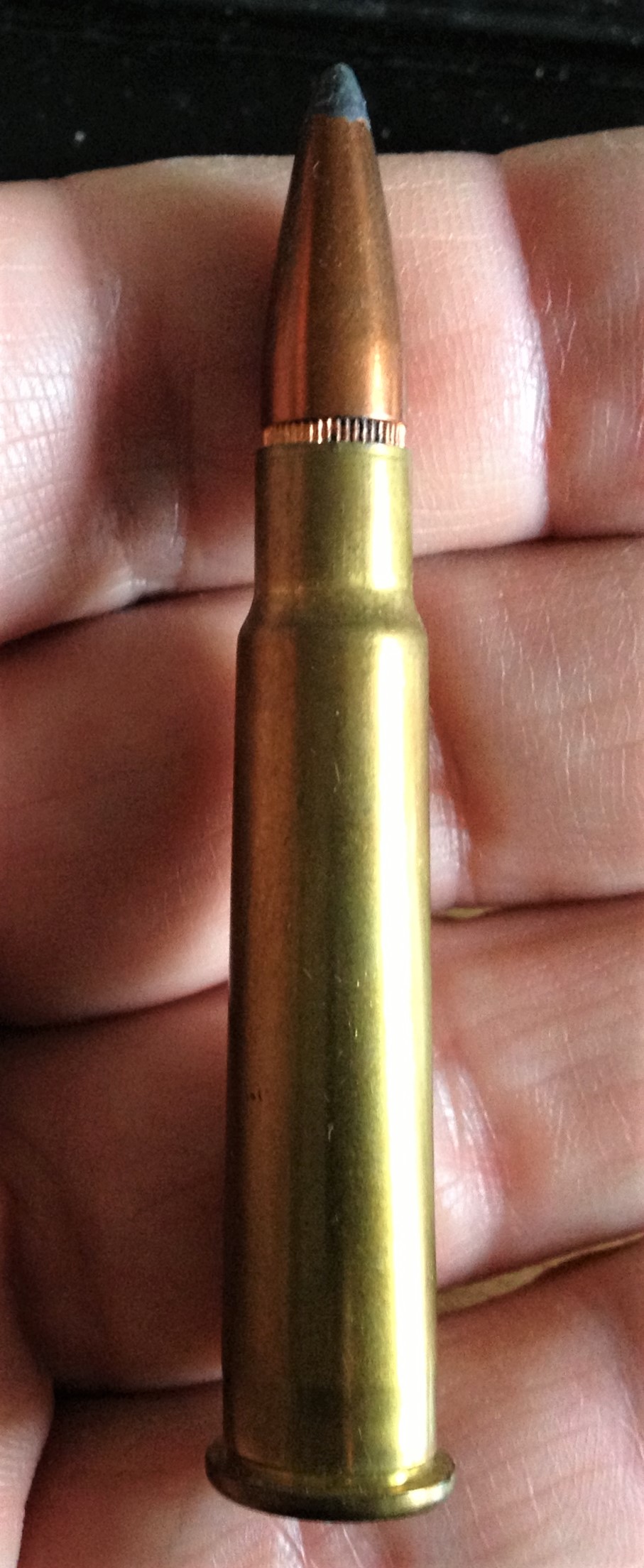

    Try the Hornady 150 gn SPFB .312" Bob.
    I used them for ages in my No.1 MKIII's and my 2 shooter No.4's won comps with them they fly well to 400m and will still knock a hog down if you poke him in the ear not sure on a shoulder shot on a large boar with packed crusty mud and calloused shoulders.
    I shot pet food roo's with them for friends and they just knock the stuffings out of them with chest shots I'll check my load data think I was using BR-2's, R.P cases, 42gns AR 2208 and medium crimp with 2/3rds of the cannular showing.
    See pic of round I'll check my data 42 grains rings a bell but start at 39gns.
    I lost all of my data for all my rifles from 2017 till 2023 by a corrupted xl sheet 6 years of testing etc I now have 2 hard drives in my computer and transfer the data to both of them now.
