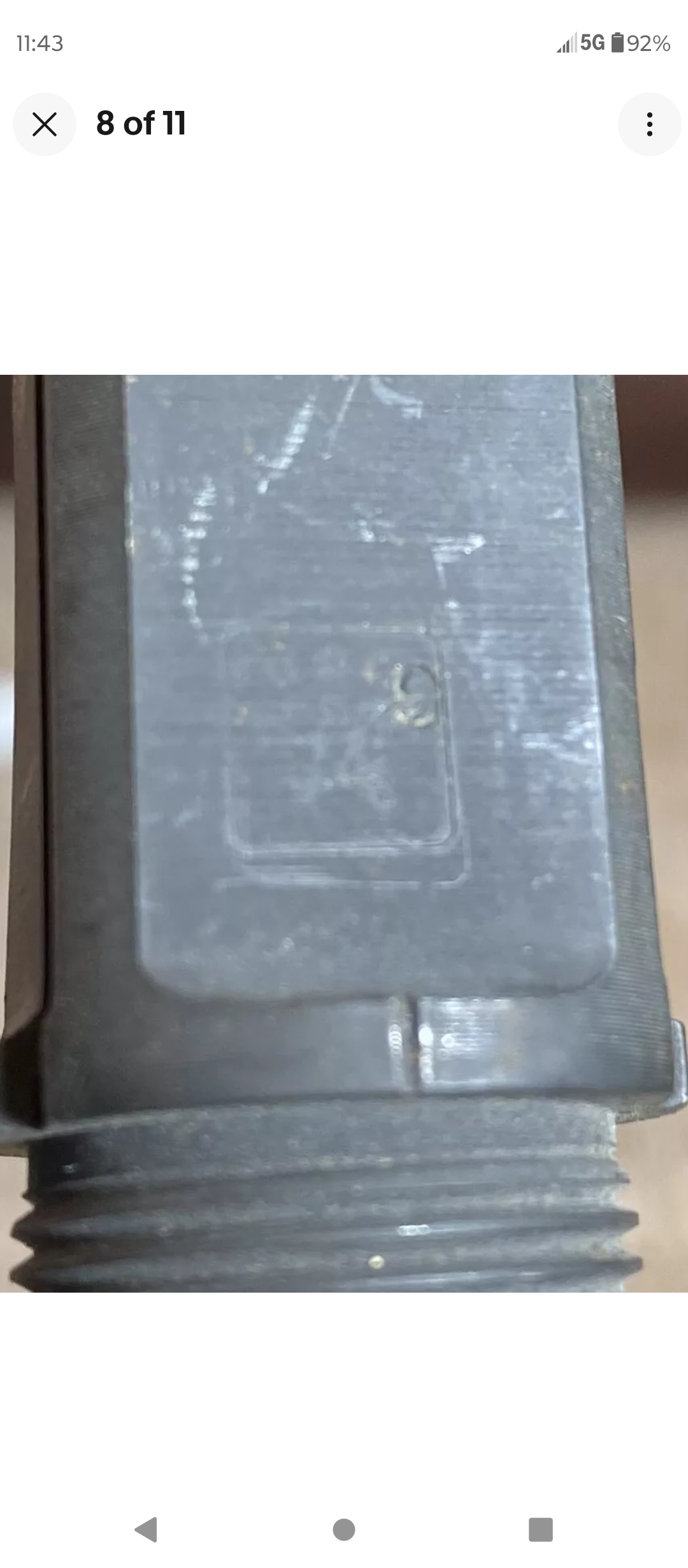

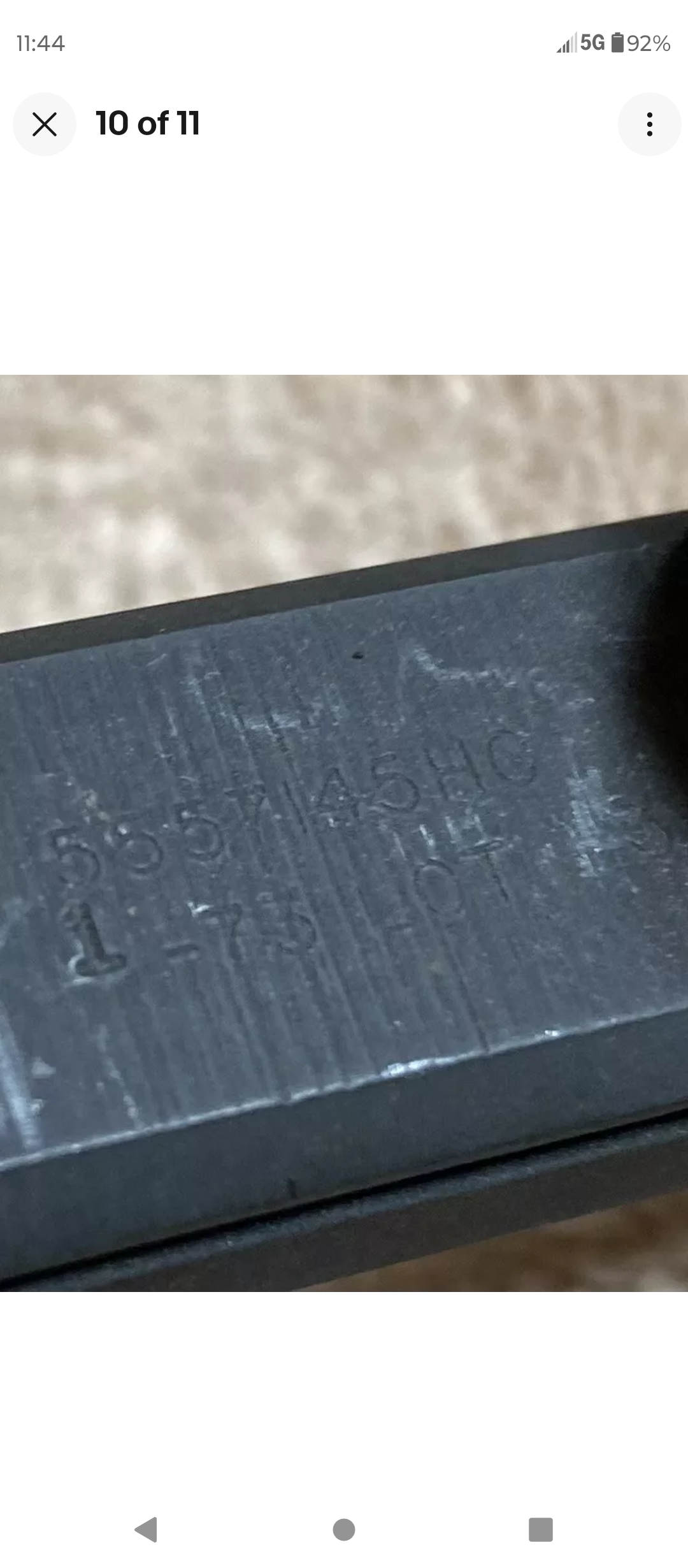

    Speaking of fakes, I ran across this Herlo barrel that has a DOD acceptance stamp on it haha. If they were all rejected by the government, how could it have a DOD acceptance stamp on it?

    jond,
    The DAS does not always mean acceptance by the government, the below quote is from the Federal Register archives. Not saying the stamp on the herlo barrels is legit just saying the presence of the DAS does not always mean what we think it does.
    “When a DOD procurement inspection approval stamp is affixed to any materiel, it shall not be construed to mean that the materiel has or has not been accepted by the government.”
    Federal Register 1956-02-03: Vol 21 Iss 23 : Free Download, Borrow, and Streaming : Internet Archive

    Thanks Wayne, I had no idea. One would think that if a legit stamp is on a legit item,then it was accepted haha. I thought it was only an acceptance stamp. I had no idea it could mean other things too. I read the Herlo section on the carbine club website and it just mentions that others have added stamps to make them look accepted but didn't mention a DOD stamp. Also, happy July 4th Wayne, and thank you for your service
