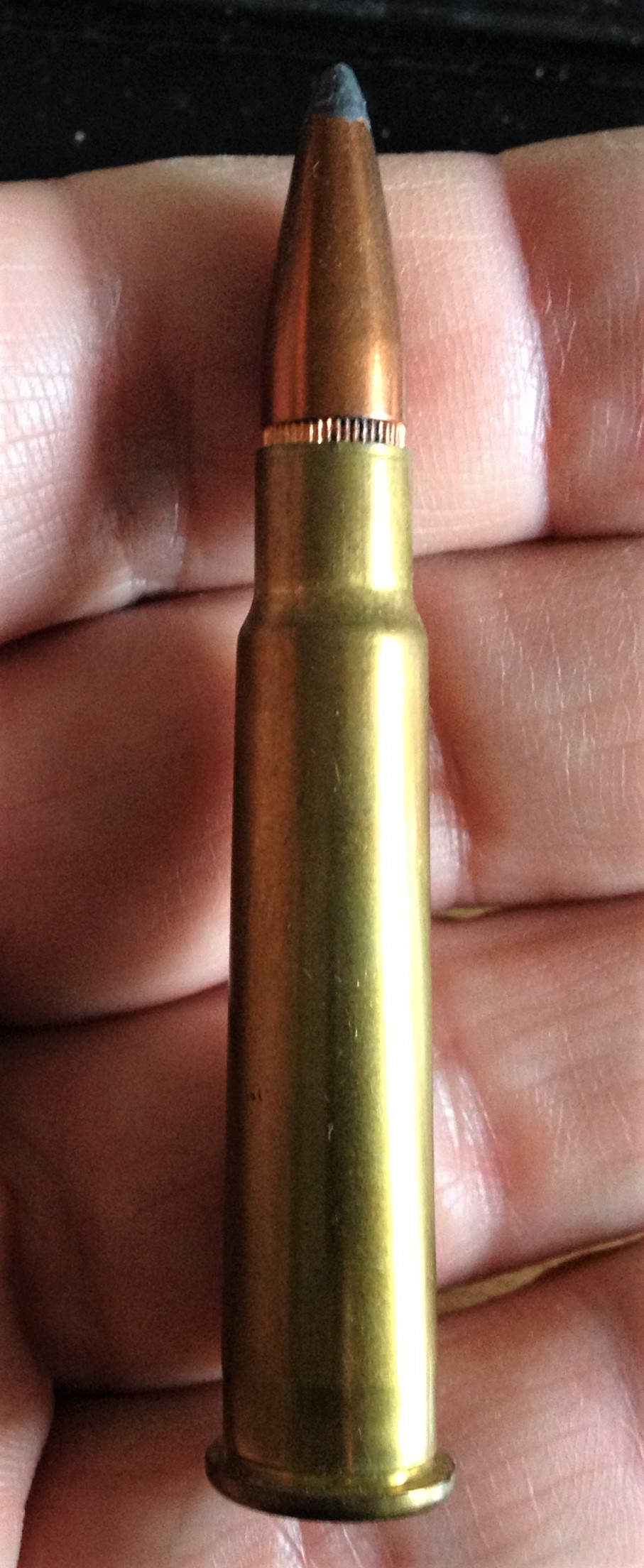

    Use the Hornady 150 gn .312 FBHP they are pretty good shot them for ages I found they fly pretty good up to 400m I used them in my 2 No.4's with 2 groove brls and my 1945 OA No 1 MkIII I seated them with @3/4's of the cannula showing and then medium crimp.
    See pic of one of my rounds just check the fit in the mag allowing enough for functioning & recoil.
