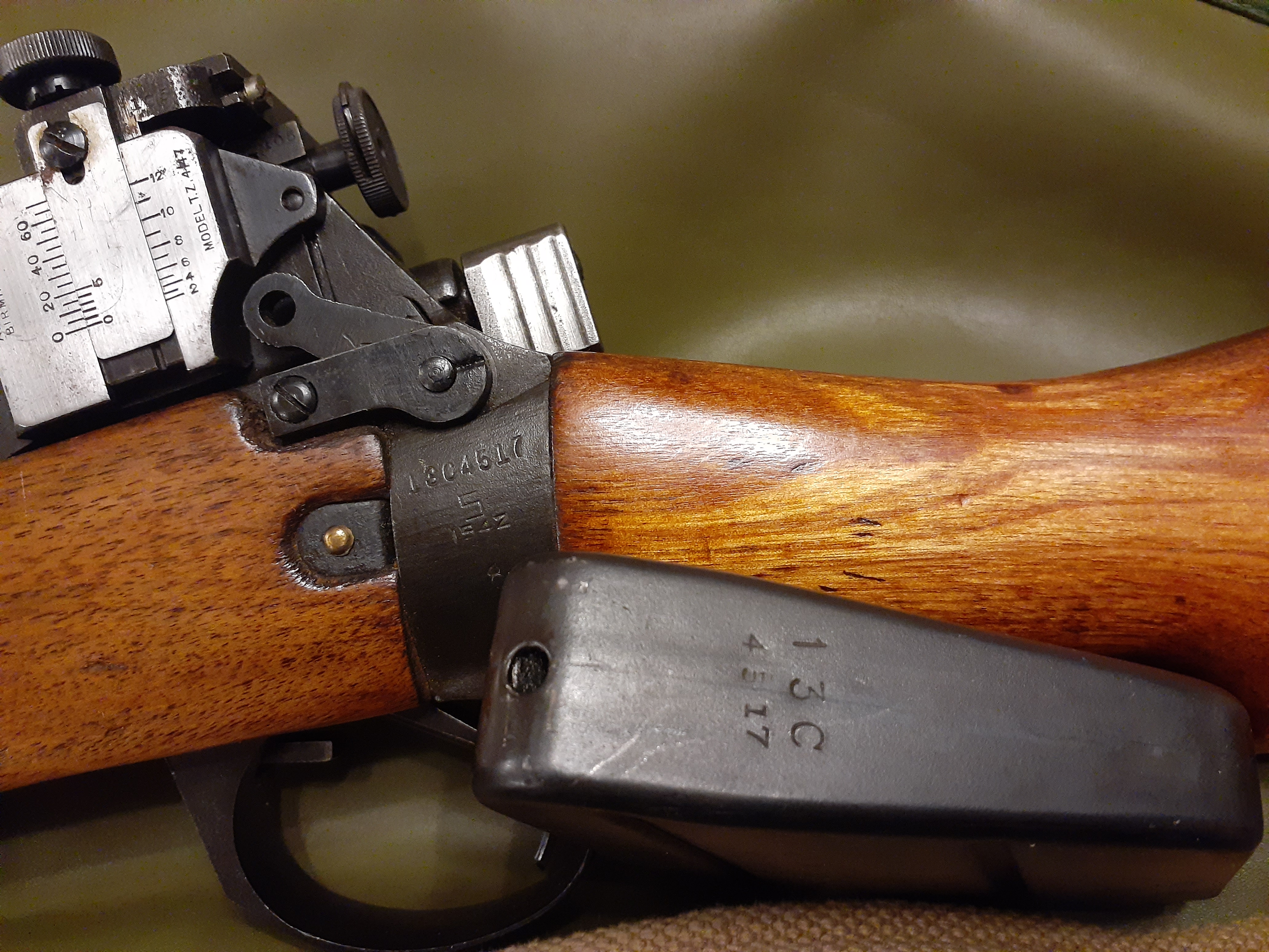

    A 1943 Long Branch.
    From the bottom to the top:
    1. 1943 Mk I* Long Branch (2 groove)
    2. 1944 Mk I BSA (ex Frenchicon, 5 groove)
    3. 1942 Mk I* Savage with an early sight protector (2 groove)
    4. 1955 Mk II Fazakerley (5 groove)
    And, in the corner is a 1923 No. 1, Mk III SMLE, with the magazine cutoff. I did experiment with a Parker Hale rear sight on the Savage, but couldn't get the sight aligned. A Mk III ladder sight worked much better.
    Weather permitting, I'll get these to the range this weekend.

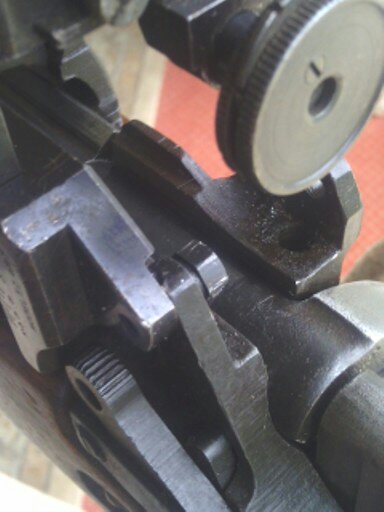

    Quote Originally Posted by Neuraleanus View Post

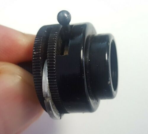

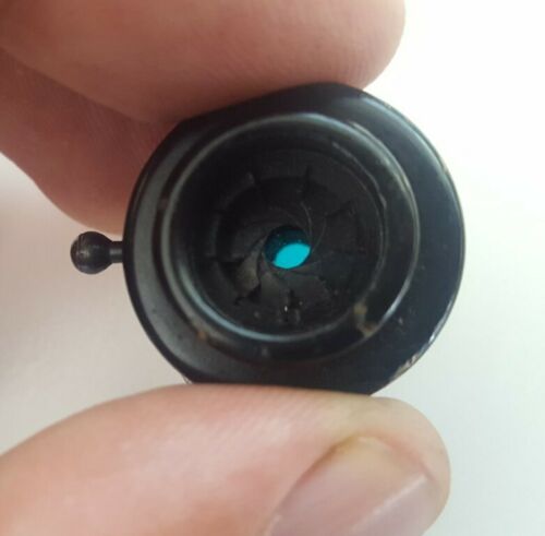

    What was the problem ?
    There isn't much (any) aligning to do, the PH5C simply bolts on in the existing holes.
    Were you using the correct model of sight - you were not trying to fit a PH5A or PH5B were you ?

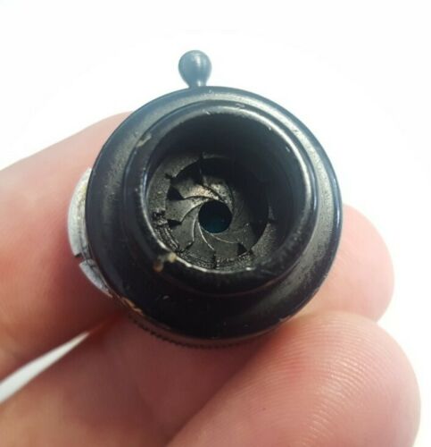

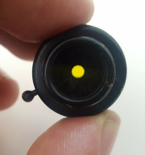

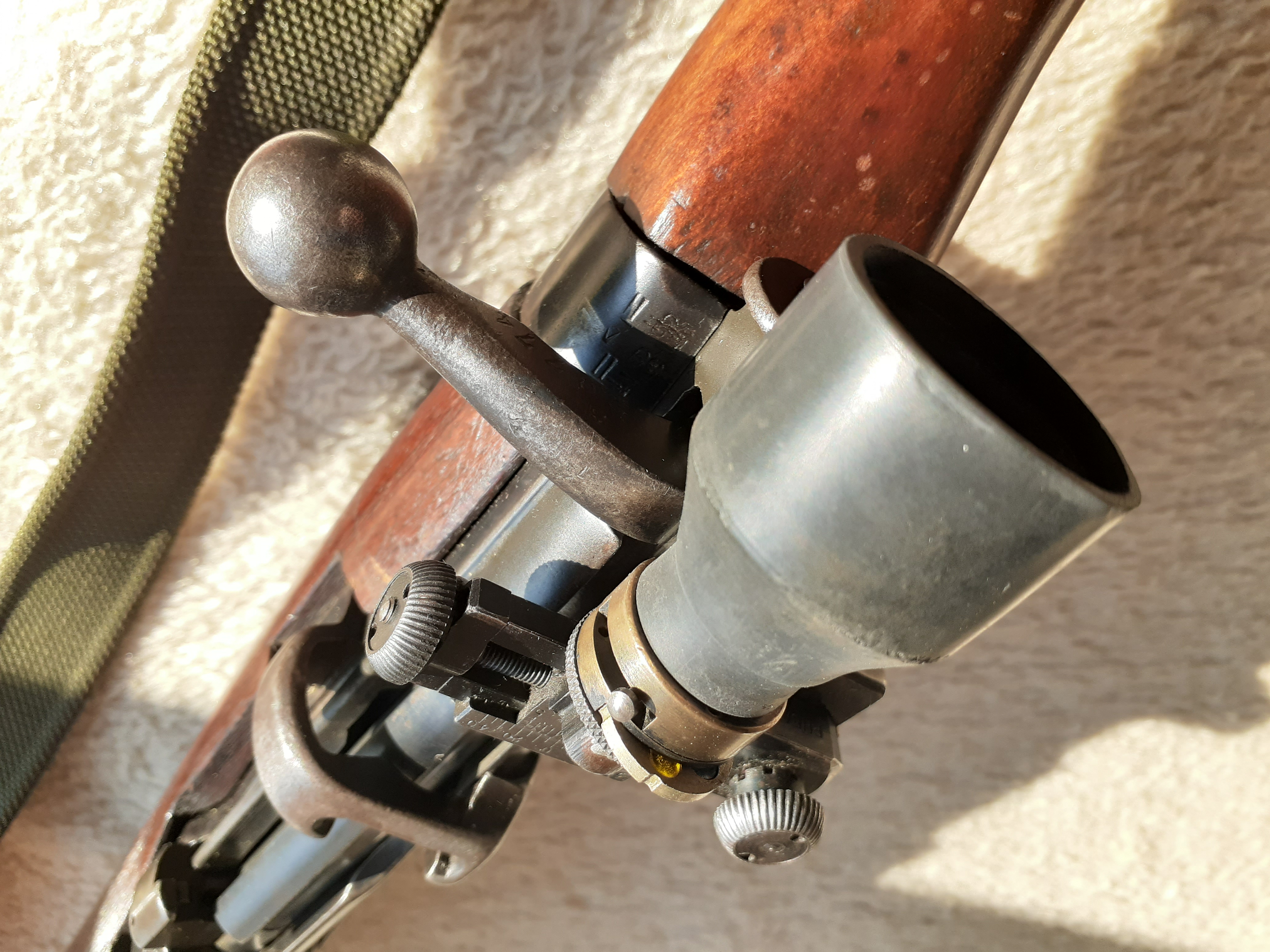

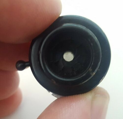

    A 5c with the correct eyepiece (Iris aperture with coloured filters) can make a HUGE difference to your shooting.
    Early morning or late evening, bright sun or hazy light conditions, with the coloured filters & the iris infinitely variable aperture and you get the best sight picture possible.
    Eyepiece interchanges with all PH sights (shown on my MkIII)

    Despite how I adjusted the 5C I could not get the sight to align with the barrel. In contrast, a Mk III ladder sight had no difficulty. Perhaps its how I attempted to mount the sight to the rifle. Maybe spacers are needed.

    Maybe you overtightened the 'long' screw going thru the original rear sight mouting ears - this can tilt the 5C and will certainly pinch the sides of the body together, which can trap the bolt and stop it working (Don't ask .......)
    Use the 'short screw' method going thru the left hand side original sight mouting ear and into the 5C mount - Like this
    You may notice that I use an AJP 4/47 sught as it is a much better engineered sight than the PH5C (although I do have a couple of 5Cs still)
    The TZ4/47 does not pull the elevation screw into engagement in line with the barrel like the 5C (which leads to a twisting effect in engagement of the rising dovetail). Instead a strong spring loaded lever pushes the screw (and the rising dovetail) sideways out from the action. This maintains good bearings on both side of the rising dovetail and equalises wear.
    Unlike the 5C you don't have to undo/retighten the lock screw to adjust the elevation setting. A better functioning and better built sight than the 5C in all respects.
