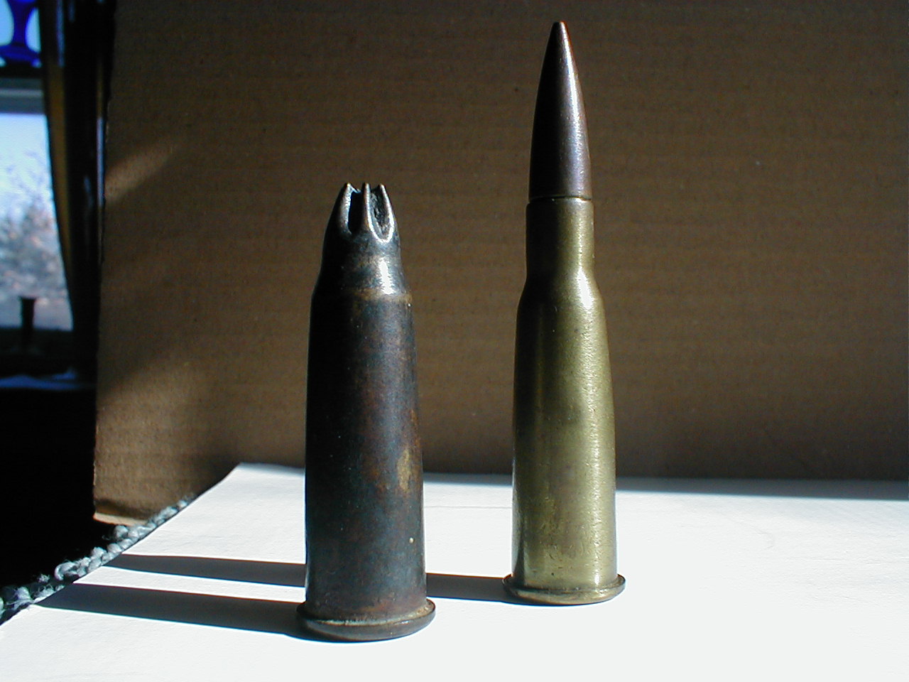

    V B message cartridge
    I have the special message grenade cartridge, not common to find - headstamp is 1917
    Legacy Member RCS's Avatar
    Today @ 08:19 AM
    4,470
    Robert Seccombe
    06-17-2025
    03:47 PM
    I should add that the message grenade was used to send messages from one sector to another in the trenches by the Frenchicon army during WW1. there was also a small parachute attached to the
    message grenade and sometimes a flare to indicate where it landed. Without radios, this was a way to communicate between sectors

    V B message grenade
    The V B message grenade was used by the Frenchicon Army during WW1 to send messages from one sector to another sector as there were no radios. The VB message grenade used a special cartridge designed for this purpose and was not a blank cartridge. There was a small parachute attached to the message grenade and sometimes a flare to indicate landing position.
    These items are not at all common to find and consider somewhat rare
