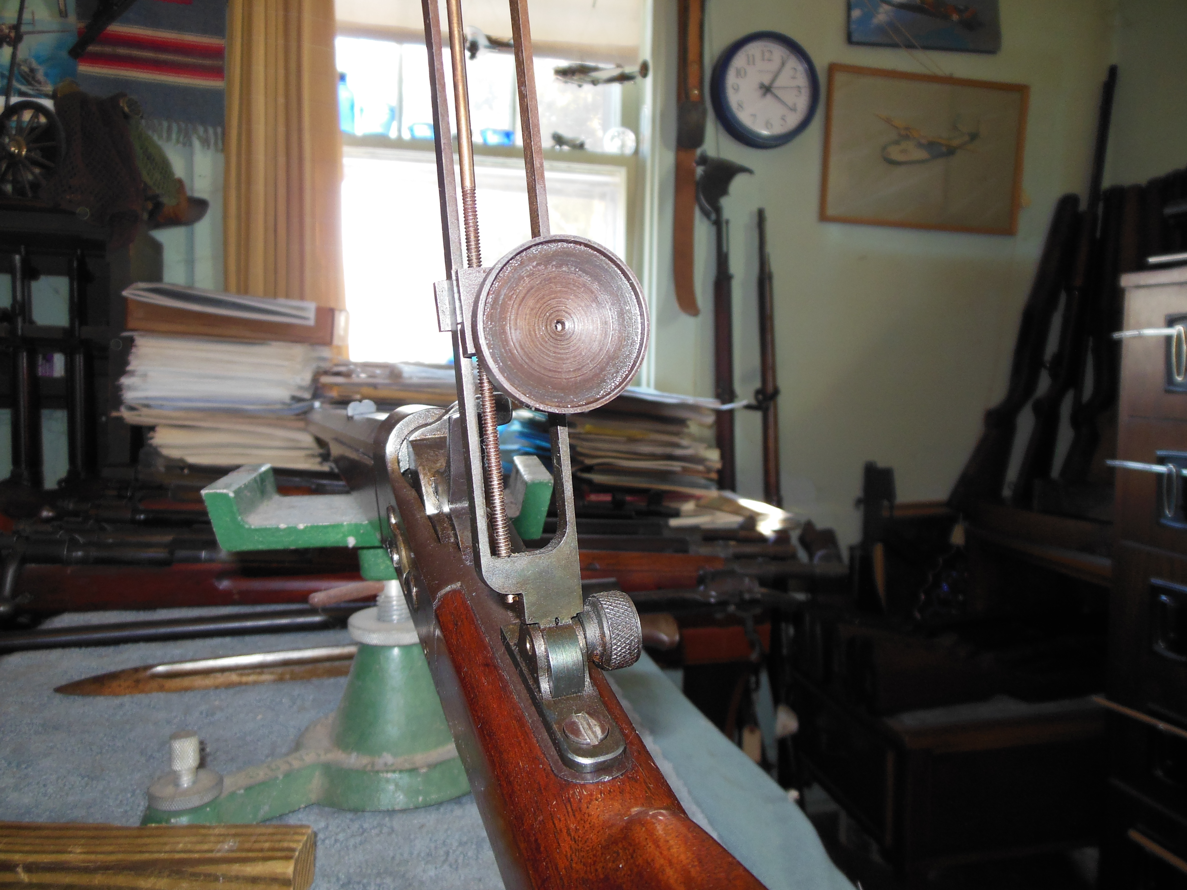

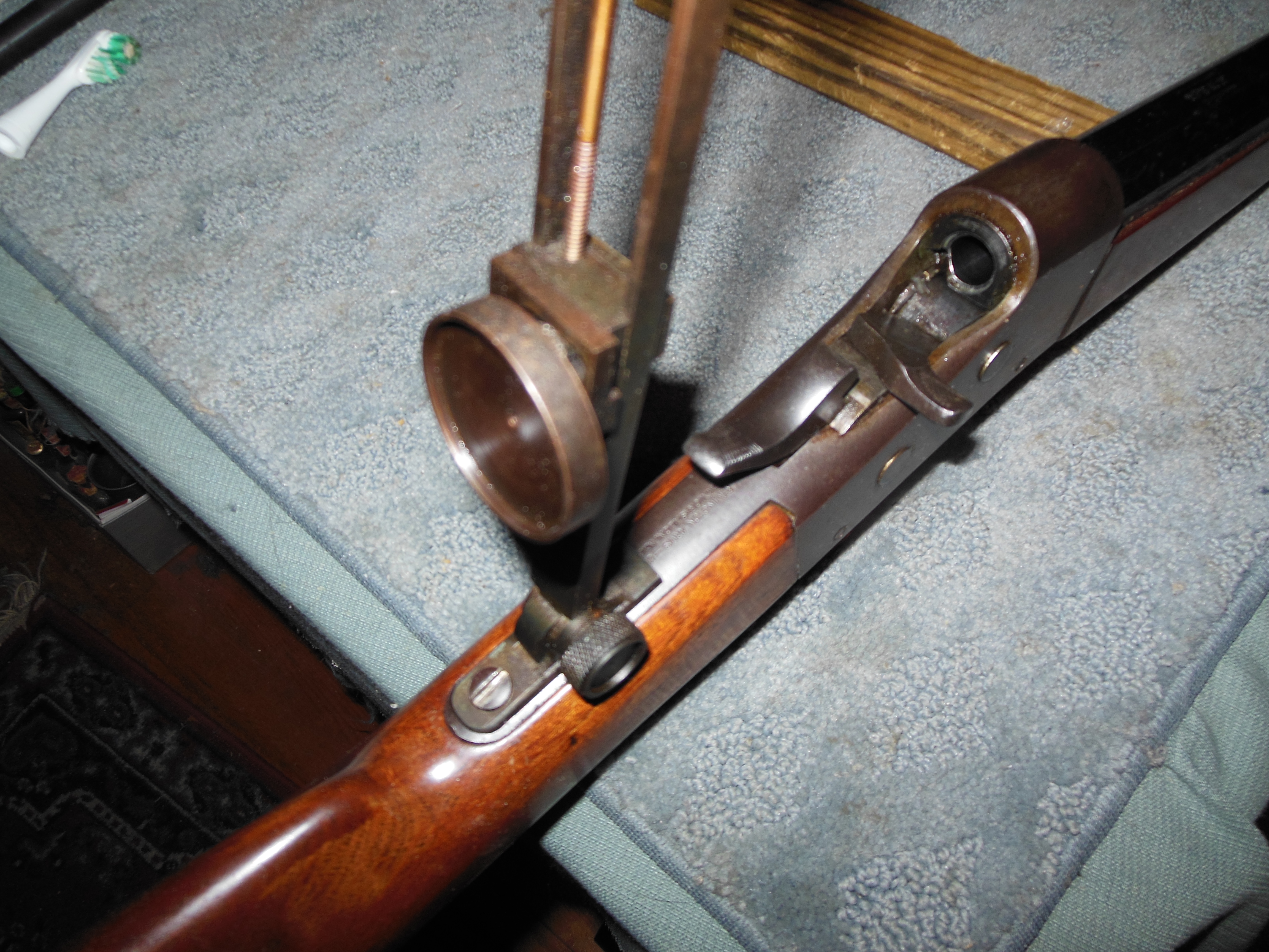

    I bought one that had been sporterized years ago and rebarreled it to 45-70. As I was shooting alot of black powder reloads with the heavy 500 gr lead bullets, I decided to make
    a simple but effective tang sight, When the bullets hit the small three inch steel plate at 100 yards, I marked the sight and so on to 200 yards. I was also able to provide windage too.

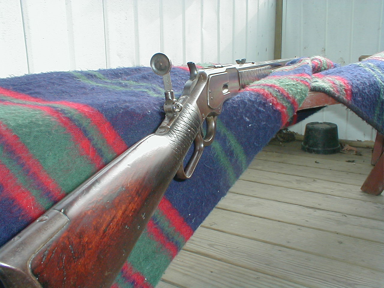

    What I would advise, is to buy a reproduction Lyman No 2 tang sight, like the original in my Win 1873 photo. You will need a gunsmith for installation. A good gunsmith should also be able to provide some choices for a front sight

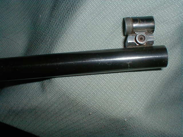

    Can you post picture of your front sight ? Like to see it !
    ---------- Post added at 08:12 PM ---------- Previous post was at 08:12 PM ----------

    front sight photo
    I used a Winchester M70 target front sight with different inserts. It is mounted on a small scope block.
