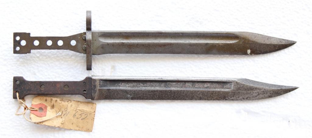

    The design of having only 2 holes in the tang is not new. I was just looking at a Blade production component I got from eBay many moons ago and realised it ONLY has two holes in it as well. Unfortunately there are no markings on the blade so I can't date it but it’s a No. 5 type Blade..... So it could be for the No. 8? or maybe a late Stirling? or ? I don't know. The profile at the rear of the blade is No. 5, not L1 Series and the holes don't line up with the L1 rivet positions. There is an official looking tag attached to it and on one side is marked VPN 652 in pencil and 618 in pen on the other side.
    The No. 5 blade originally came out of Englandicon.
    Top: Partly complete Australianicon L1A2 Bayonet.
    Bottom: British No. 5 Type Blade.
