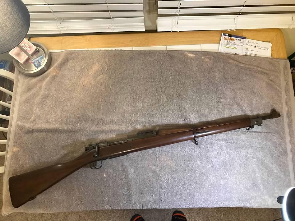

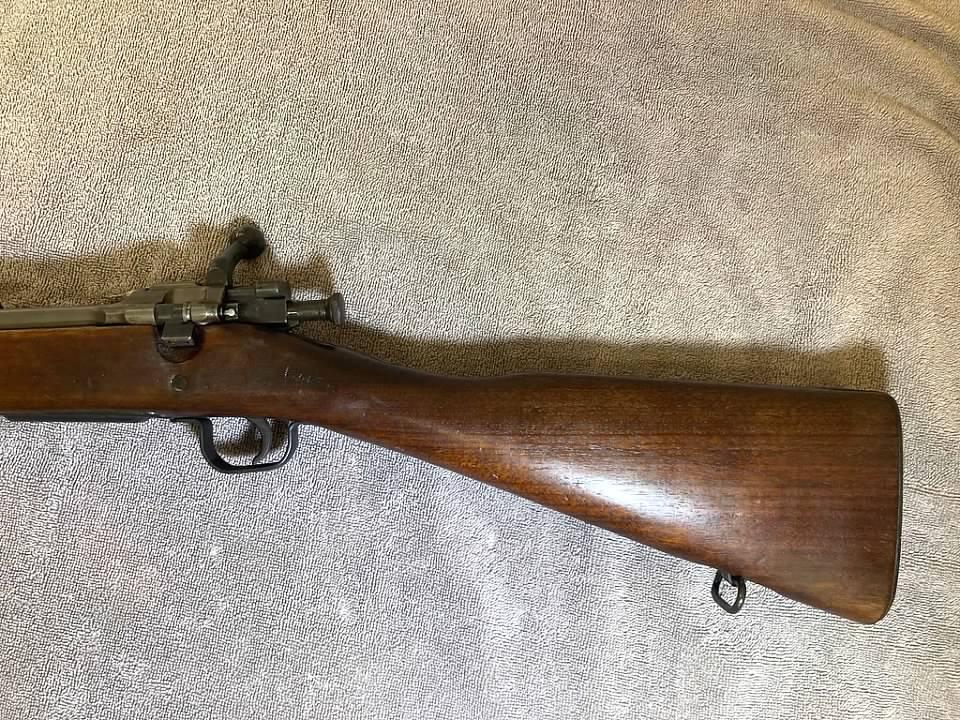

    picture of the left side of the rifle would help. color of the park, and the poor job of being serialed on the bolt could be signs of USMC, the stock looks to be a 1903A3 stock, 1903A3 stamped trigger guard. as well.

    Ok...thanks for starting info. You have piqued my curiosity on this one....here are some additional photos (sorry for the indoor pix...ran out of daylight!). Any more information in helping me understand what I have would be appreciated. Barrel is marked 'SA" 1929 with the ordnance bomb.

    You have a rifle that was originally issued to and served in the USMC. The serialized bolt, for example, is likely indicative of USMC issuance. The rifle, however, underwent overhaul in late WWII at what is believed to be a division of General Motors and lost substantial originality. The stock, trigger guard, and bolt sleeve/firing pin assembly are a replacements from an M'03-A3 rifle.
