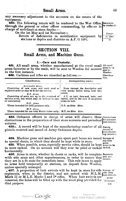

    The EY mark appears as early as 1904, long before grenade projecting came back into fashion.

    What's para. 457 all about?
