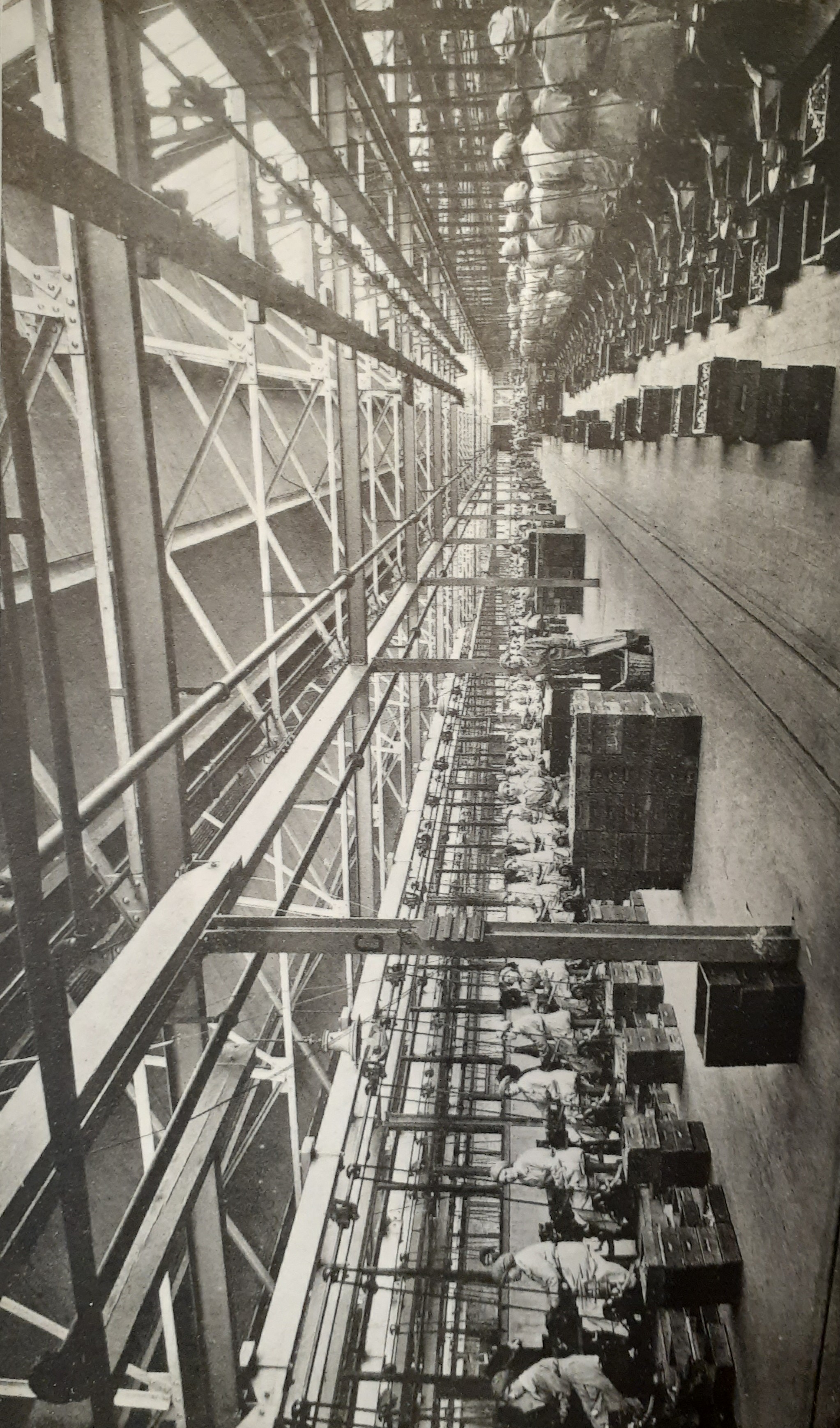

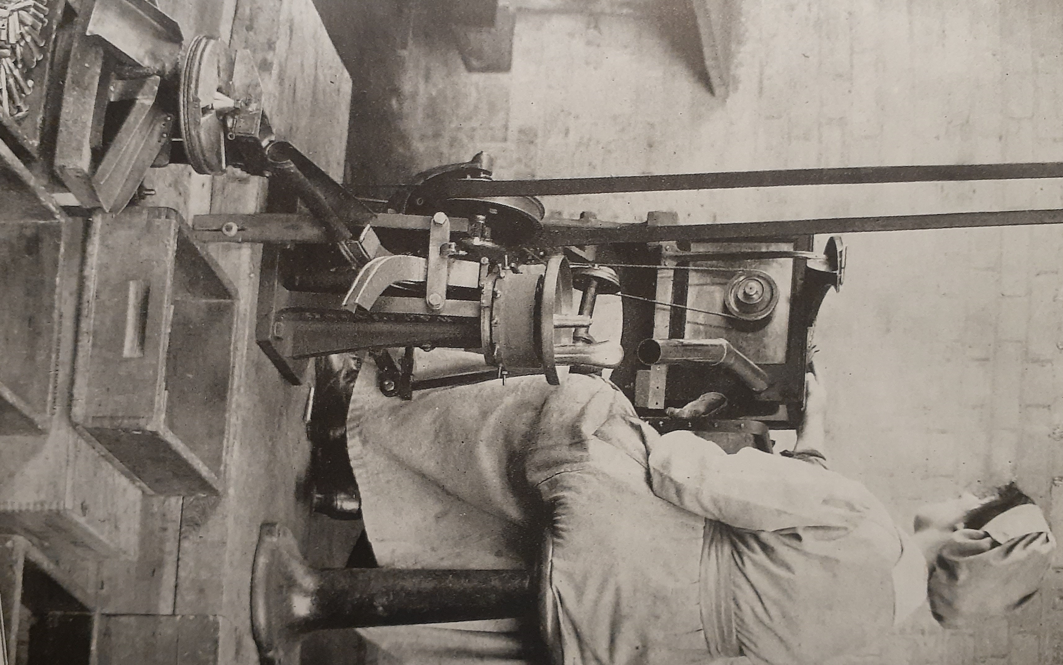

    There are some 11 pages (A4) of notes on proof testing and accuracy, and accuracy measurement in the "Textbook of Small Arms 1929" pages 237 onwards.
    This not only includes the FoM but things like pressure variations, velocity variations, hangfire time, extraction forces, 'sawdustproof' and 'casualty proof'.
    With a further 14 pages on the inspection of the Mk VII rounds.
    Every round manufactured was tested dimensionally (go / no go) visually checked and weighed by 1000's of ladies at the end of each ammuniton production line.
    "The inspection of SAA may at first sight be expensive ,and, in any case it cannot be too strongly emphasized that the inspection of SAA must be primarily be regulated by considerations of quality and not of cost."

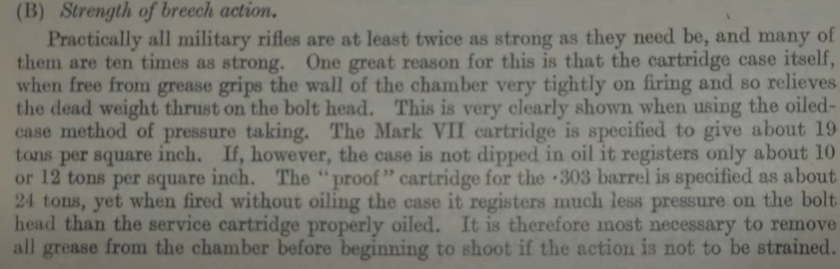

    What's the source of the quote? It reads as though it refers to the days of the Lee Enfield Mk.I and the sighting problems detected in South Africa(?)
    The tests recounted in the same TBSA 1929 remind us that where chamber wall adhesion occurs in firing without the presence of oil, grease or water to interfere there much less back pressure on bolts and bolt heads than we tend to assume. I can't find the text from TBSA at the moment, but here is an article posted by Ed Horton in 2009 that goes into some detail: Rifle Chamber Finish Friction Effects on Bolt Load and Case Head Thinning Calculations done with LS-DYNA
    Chamber wall adhesion alone tends to negate the oft expressed concerns about the strength of the action and its "unequal" proportions on either side. The importance of dry and clean chambers and ammunition seems not to be as widely known as it should be however.
    The flexibility and resulting "compensation" turned out to be advantageous.
    Overall events have proven that J.P. Lee and his later assistants did a fine job, though it certainly took a long time to incorporate some of the later improvements.

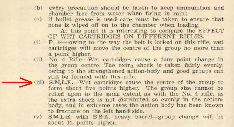

    Interesting that other period documents warn of the effects of firing wet cartridges, and note that the SMLE has been known to fracture on the left hand side from the additional, unequal, pressures.
Name:	Wet SMLE Cartridges Group Size.jpg‎

    06:08 AM
    And when we have oil ...............

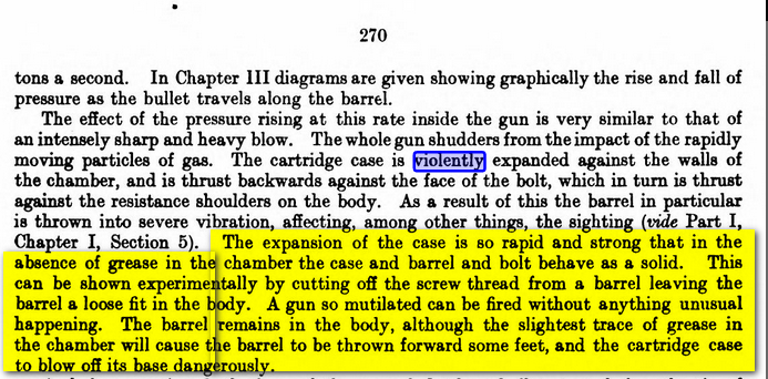

    Curious that the second text states that "...in extreme cases the action body has been known to fracture..." Presumably they meant to say the bolt body.
    The test done at Enfield wherein an unthreaded barrel inserted into an unthreaded body/receiver, with what we assume was a relatively close slide in fit, fired normally with absolutely clean chamber and ammunition, but was blown out of the rifle if there was any oil on either chamber or cartridge case is detailed at the top of page 270: Textbook of Small Arms 1929 [Great Britain War Office] : [Great Britain] War Office : Free Download, Borrow, and Streaming : Internet Archive
    I would assume also that the barrel and body were not so close a fit to each other that the barrel itself expanded and adhered to the body during that test.
    No, I don't think so - In the past I have read reports of SMLE sidewalls fracturing.
    I think the examples of fractured bolts has generally been found to be poorly cast (granulated) steel in the bolt body.
