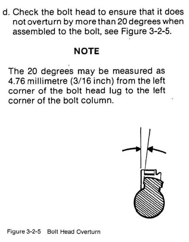

    Correction to my last: 16° max for run of the mill No.4s and as few degrees as possible for the L42A1.
    And in many of the manuals is quoted as 20° and that is the dimension picked up and published in the Canadianicon manuals.
    I wonder if the 16° was the maximum that Armourers were allowed to accept during replacement etc, but the 20° is the maximum allowable 'in use' after wear & tear ?. If it exceeded 20° then it went back to the Armourers to be replaced.
Name:	Bolt Head Wear 1.jpg‎

    The 16° and L42A1 comment was Peter's statement quoted by you elsewhere, and I therefore took it as the last word.
    i know, but it occurred to me that it may be similar to bolt head sizing / headspace where the Manufacturer and the Base workshops MUST get it to headspace with a No2 bolt head - a No3 bolt head was not allowed to be used except for field repairs to keep a rifle in use.
    Maybe Peter's 16° was the 'most' that he could accept to ship out.
    This could allow for wear and still being within the usable specification of 20° as shown in the various manuals.
    It is simply idle speculation, but would seem to be sensible, as, if they sent it "back out" on max tolerance, it could be back in the workshop the following week.
