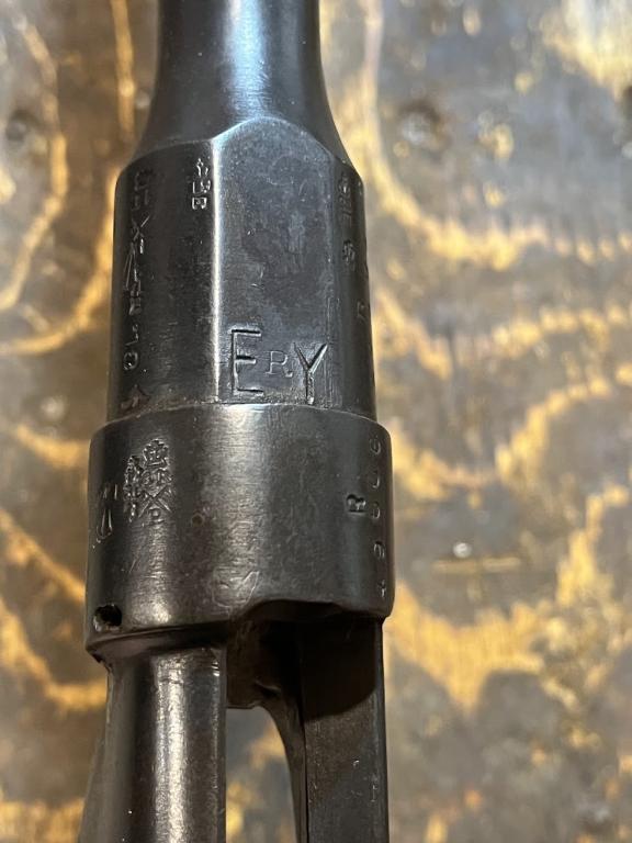

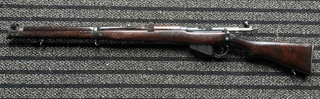

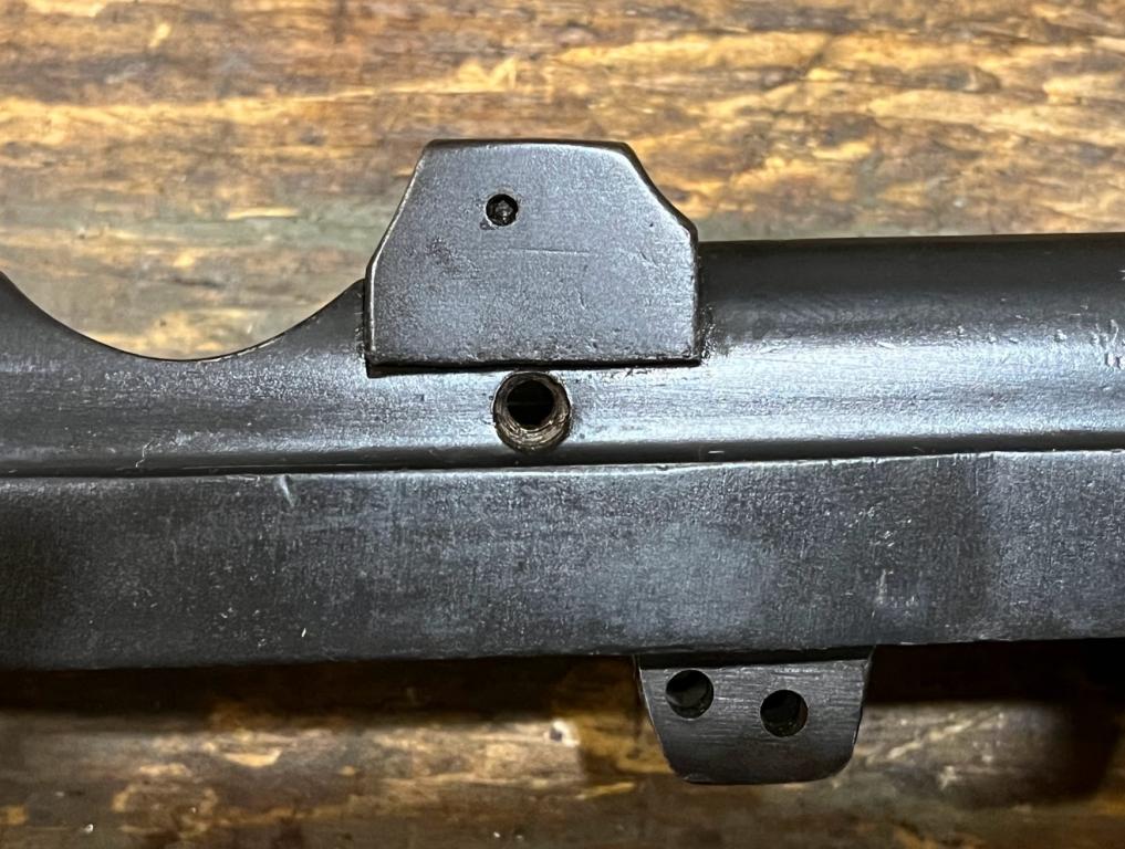

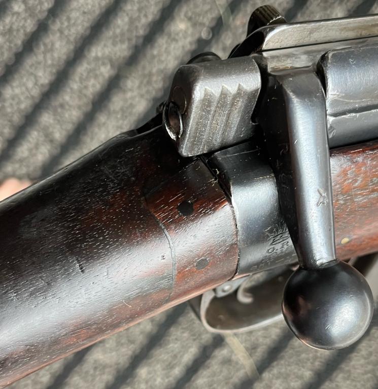

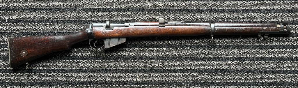

    Hoping for some insight. In another thread, I showed an SSA SMLE I bought that has great furniture, etc. but the barelled receiver was badly pitted. Today I happened upon an interesting sporterized SSA that is EY marked, sitting in an MkIII (sporterized, and not MkIII*) stock set, and with a grenade firing re-inforcing screw (not bolt). It has other issues I'll need to fix (like riveting a replacement charger guide back on - will likely rob the SSA one off my rusty action), but rust is not one of the issues with this new gun. I bought it on a whim thinking I may be able to swap it in for my badly rusted and mismatched SSA barelled action, using the other original parts of that SSA.

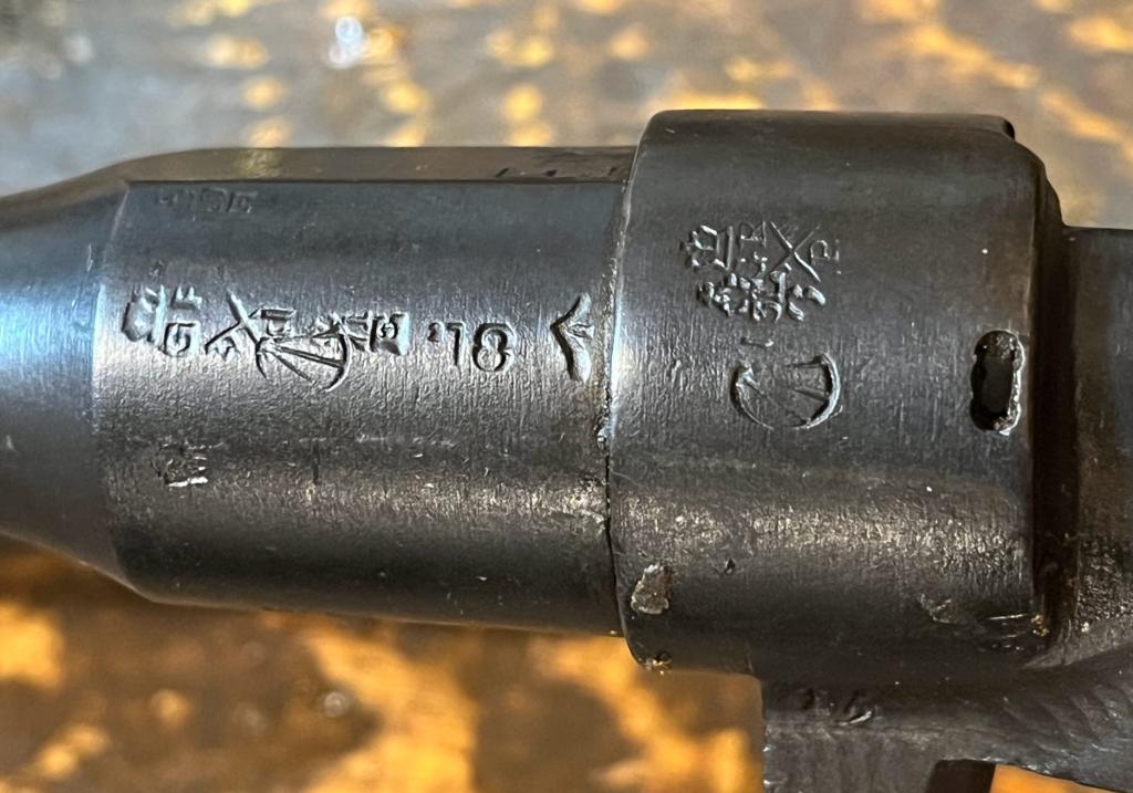

    Then I got to thinking - this "new" SSA barelled action (essentially) I have inbound is actually a fairly rare gun. It's Britishicon service, with a cleanly marked EY knox form. EY stamp on butt. Has original steel buttplate (typical of 1918 SSA/NRF rifles). An early type of grenade firing re-inforcing screw, etc. Clearly at some point it was set up as a GF rifle, but for British service (not Indian), typical of many EY rifles in Brit service.
    So if I restore this sporter using the parts off the other rifle, might be an idea to restore it as a proper grenade firing rifle of the period (circa 1918).

    So my questions... I've not seen a re-inforcing bolt quite like is on this sporter. It looks early to me, and not very "hardware store bolt". Would this maybe from the 1918-ish era?

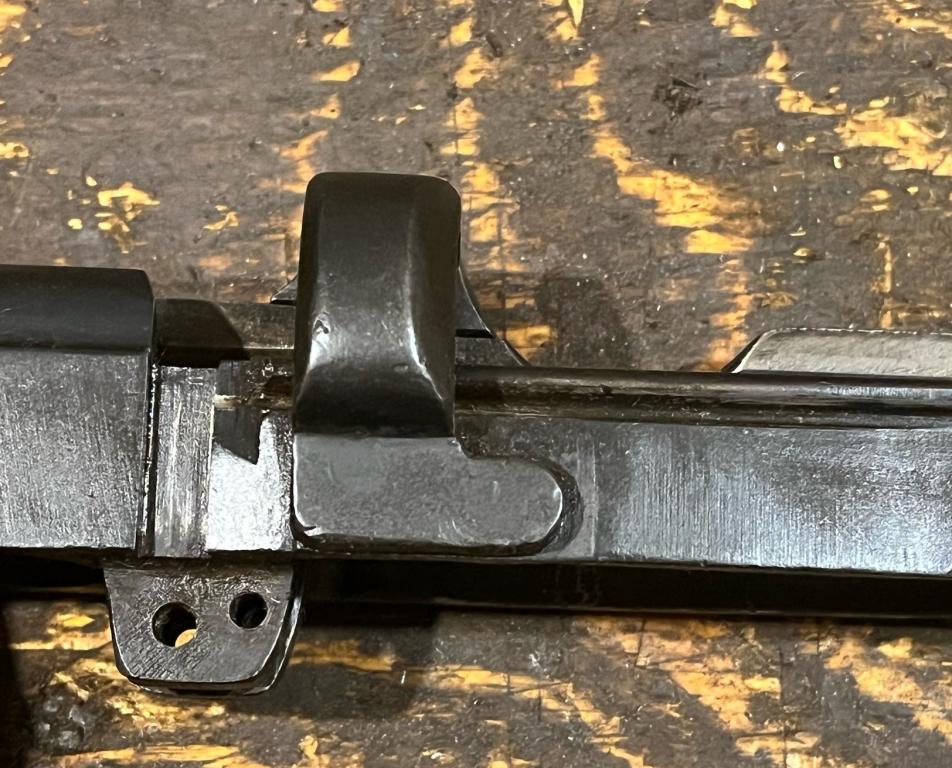

    Some pics of the inbound rifle needing restoration:

    Got the rifle in. It's a Canadian issue SMLE, and since I bought it in Canadaicon, solid chance this is where it last saw service too. No import or export marks on it, no ENGLAND stamps or british commercial proof marks.

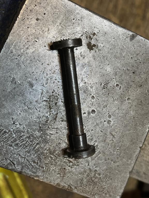

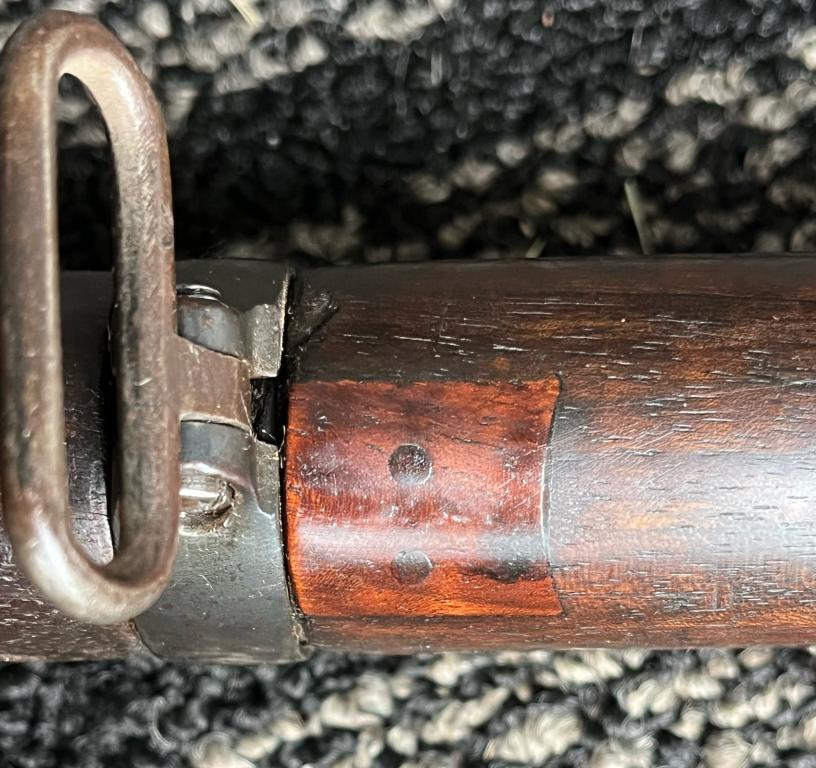

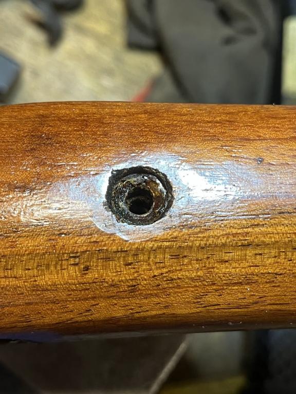

    This is the reinforcing bolt I took out of the sporterized forestock. It's not a hardware store screw or bolt, looks to be purpose-made as a stock reinforcing bolt. It's blued, and the "nut" is shouldered.
    Here's a shot of the inletting in the forestock for it, which is square bottomed (i.e. it was machined to have a flat bottom, not just counter-sunk with a drill bit like bubba would do. Both sides are similar.

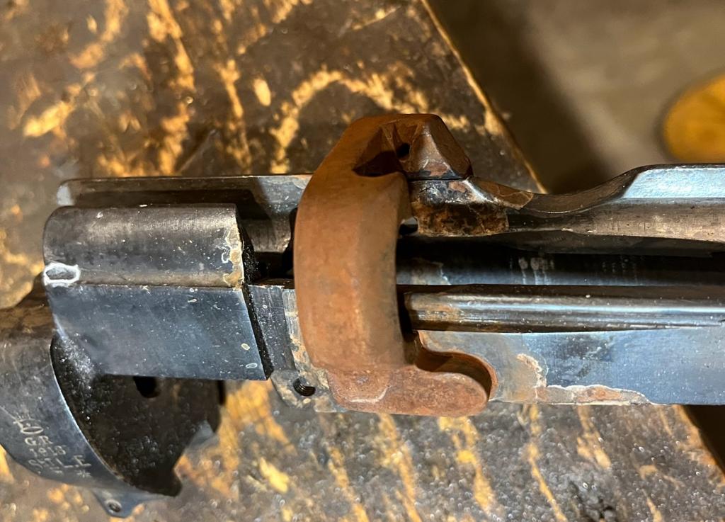

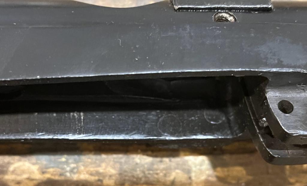

    The barelled action is a bit of a conundrum, really. It is clearly a low miles gun, and had never been refinished - the inside of the receiver was still n the white from the original factory rust blue job. Bore is nice, does not close on a SAAMI NOGO. Even and good locking recess contact. The only thing I could find wrong with it is the bolt would sometimes not close - the upper lip of the bolt face would catch maybe 1 in 5 times cycling the action - a couple thou of overlap on the front of the receiver ring was all that was hanging it up, surprisingly. I looked at a half dozen other SMLEs in my rack, and the receivers all had a slight chamfer there, where the bolt head is supposed to slip under and into the front receiver ring. This one did not have that - like it missed a machining or hand finishing step at the factory. Makes me wonder if that is why it got EY stamped, as I could not find anything else wrong with it - and I have the gauges to check for the most part. I very slightly broke that edge with a small half round file, and now the gun cycles 100% reliably.

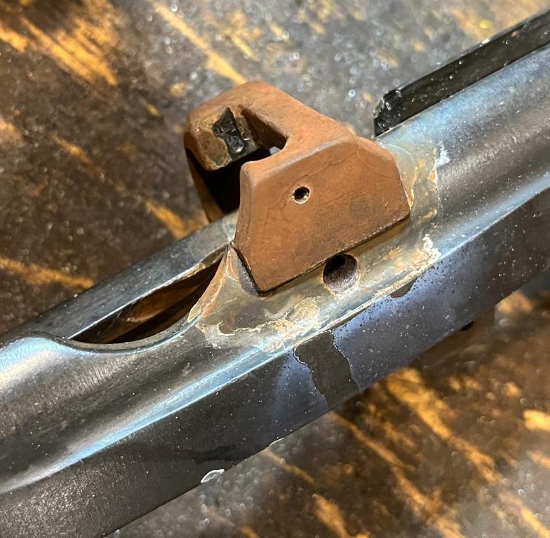

    Then I set about addressing the missing charger bridge. Luckily I had another thrashed 1918 SSA barelled action that was badly pitted sitting here, so it has donated its charger bridge. Machined new rivets on the lathe, flared one end in a rivet mandrel and installed the new bridge. I build an inner anvil in the mill from some scrap stock (nothing fancy, just a correct thickness block of mild steel) to fit inside the magazine recess so I could support the receiver on an anvil, and then riveted over the rivet heads with a ball peen. Dressed flush with a file, sanded to 400, and then rust blued the bridge (it had all its finish gone) to match the rust blue finish on the rest of the receiver. I think it turned out acceptably.

    Here is the rifle as it now sits, complete with 2 small wood repairs I made in European walnut with maple dowels to fix wood that was chipped out. Both are dovetailed in and glued with 2 part clear epoxy mixed with fine walnut sanding dust.
    So... to install the re-inforcing screw and wrap the front of the rifle, which I think is how it left service, or not to?

    So of interest, I checked , and apart from being longer, the stock reimforcimg bolt I took out of the original spotter is the same as a bayonet grip screw except longer. Same thread, diameter and head diameter, etc.
