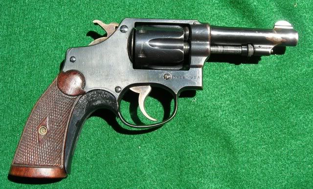

    I would not go beyond 2.5 grs Bullseye. Factory load as a reference point.
    S&W No. 3 Hand Ejector 3.25" barrel
    90 gr Sierra JHP .312" 2.0 grs Bullseye CCI 500 Aguila brass
    11-Sep-05 T = 82 °F
    Ave Vel = 508.4
    Std Dev = 35.05
    ES = 160.2
    High = 598.4
    Low = 438.1
    N = 30
    about 2" low
    centered
    90 gr Sierra JHC 2.5 grs Bullseye CCI 500
    22-Jul-05 T = 96 °F
    Ave Vel = 707.3
    Std Dev = 26.79
    ES = 85.88
    High = 756.7
    Low = 670.8
    N = 12
    Elevation good Windage left
    98 LRN Aguila Factory Ammo
    9-Oct-05 T = 64 °F
    Ave Vel = 654.5
    Std Dev = 19.64
    ES = 70.29
    High = 682
    Low = 612
    N = 28
