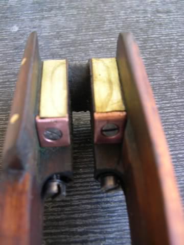

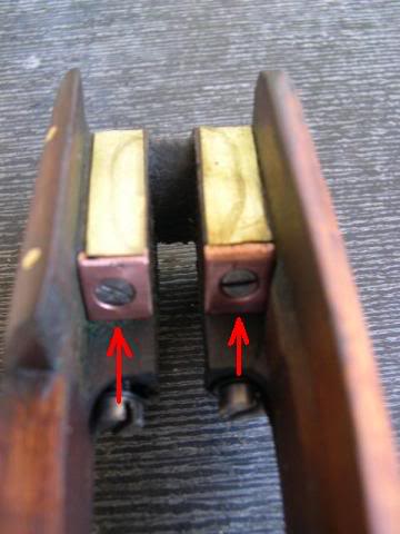

    Below are photos of an Australianicon range rifle and the modifications made to bedding the No.4 from the “Canadianicon Marksman” showing the same shims added for constant up pressure that are shown in photo # 86 of the article posted here.
    Below is a better view of the Australian range rifle, the up pressure shims and the adjustment screws for tightening up the draws area.

    I have several reservations about the Australianicon method of fore-end fitting using the copper thrust blocks. It concerns the fact that you have small screws holding the blocks in place. These small screws are inserted DOWN the grain and it will be impossible to tighten them without stripping the threads. I appreciate that there is 'tightening' and 'tightening' but the fact is that the screws must be tight! I have seen many Australian No1 rifles where the screws have stripped in the oily fore-end. Not even oily fore-ends either, simply in the softer wood!
    As Ed says, this part (we called it the fore-end 'nip') is critical to the fit of the fore-end and subsequent accuracy. I also have my severe doubts about any form of mid-barrel damping/bedding too, even if it is correctly bedded at the muzzle too. It's all to do with vibration and redundant harmonic that I won't go into here. It's also interesting in this regard that during the whole of the life of the No4T rifle, the strict criteria for fitting a fore-end was NEVER changed or relaxed, even in the heat and height of war. It's also interesting that during all of the trials, a properly set-up No4T ALWAYS out-performed those others with other methods of stocking up.
    When I patched fore-ends at the draws, (called the 'draws' as it was the camming action of these that 'draws' the fore-end towards the rear) I used oak if it was available and inserted the patch so that the grain of the hard-wood patch would run parallel to the .6" or so length of the two draws. Easy to get the knack once you've done it a few times. We did many No5's like this too (using a local hardwood in Malaya). Not for sniper or local competition use I hasten to add, but because the wood was constantly wet/damp and the fore-ends got a constant battering too.
    Just a few thoughts to provoke a bit of thought............

    I'm still a bit miffed about you wild colonials moving the steering to the wrong side.........
    Good to see the picture of the hardwood patches but it shows the grain of the wood continuing along the original grain line. When I did the No4T's (and my own rifle of course.....) I made sure that the grain line went along the line of the draws.
    In view of the necessity of good draw fitting, I think I'll do one of the pictorial 'lessons'. Can I use your illustrations Ed?
