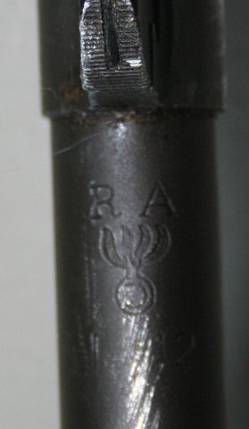

    Hello Nick, I'm a home guard memorabilia collector. This is just a possibility. The majority of U.S. rifles sent to the U.K. and adapted for home guard use were P-17 U.S. Enfields in 30-06. The red paint was required so the home guard volunteers wouldn't try to load .303 into 30-06 chambered weapons. Most just brushed it on with little effeort for a neat job. Several thousand Springfields were also sent. The red band painted at the handguard is a fair clue. Is there anything else painted on the stock? Rarely, some home guard units would also paint .30 cal or 30-06 or cal 30-06 on the butt stock - usually in white paint. *Just saw the pictures. I think the Britishicon crown marking is also a supporting clue. The 12/1941 date barrel throws me though. It's very late. Most of the U.S. goods showed up in 1941. Was it rebarreled in the U.K. later? I'm puzzled. Just checked - BNP under a crown is Birmingham nitro proof.
    LDVolunteer: No, the barrel is an original Rem barrel ("R.A."), w/ Rem proof dated 12/41.

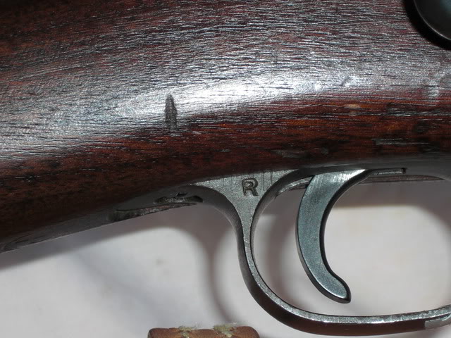

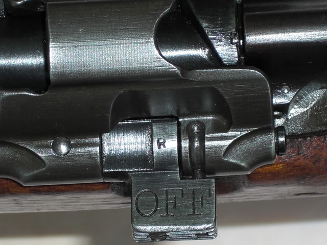

    A few more pics to vet this "302":
    An "R" stamped in the rear right (bolt side) of trigger guard.
    An "R" found on the mag cut-off.

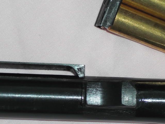

    I asked earlier about the extractor because during a brief sight-in at the local range, that red paint attracted a self-described 1903 collector/"expert" (I think he was trying to be helpful ...) ...
    He thought the rifle was all correct, but insisted the extractor had been replaced at some point with a Springfield or RIA because no "R" was immediately visible during his cursory once-over.
    I had greased up the bolt and the bolt raceways before shooting that day, and during cycling grease smeared on the bolt and on the smooth parts of the extractor.
    After cleaning, I found this:
    I assume that resolves the issue? No?

    Looks good, in my book! Now if you ever find her "sister".....

    I note the "R" stamped on the top rear corner of your extractor. I have not seen one in that location. But, I'm not the least bit surprised. The "R" is usually on the bottom. Thanks for the picture!
    The approval dates for the changes you cited are somewhat dubious. Remington rifles do not necessarily reflect those change approval dates. The rifles themselves show that elimination of lightening cuts and grasping grooves all occurred at the same time. And the rear guard screw holes were drilled through at about that same time or perhaps a week or two later at the most.
    The Red Star article we wrote focussed exclusively on the uniqueness of the Red Star rifles. Space did not permit addressing the common peculiarities of early Remington rifles in general.
    Hope this helps. And congratulations on such a splendid find!

    Thanks, John. Good to know. Now I'm interested in where the "R" on the extractor of Rick's "302" is located, since our serial #s are close, ... just curious as to whether, perhaps, mine is a factory odd-ball ...
    Maybe Rick could check and weigh in on that ... Would be interested to know if the extractor of anyone else's Rem 1903 has that stamp in the same location?

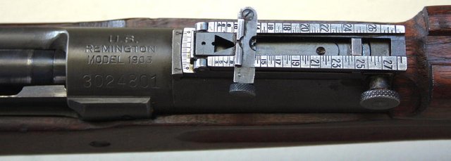

    I agree with John that going by "firm dates" is usually not possible with Remington M1903s. For example, it is true that the M1903A3 was adopted as standard on May 21, 1942. If you visualize hundreds of M1903A3s suddenly appearing on the assembly line the next day, you'll be wrong. Often, these changes took weeks or even months to happen. In the case of the 03A3, the first examples (to my knowledge) didn't appear for a few months, and due to targeting problems with the new rear sight, high production wasn't achieved until nearly the end of 1942.
    The same is true with other changes - they were often slowly phased in. John sometimes uses the term "floor sweepings" to describe earlier parts showing up on later Remington M1903s. An example of this is the "lightening cuts" on the fixed rear sight base. They generally were phased out about 3,020,000. However, they continue to be seen on some later rifles. I have noticed several on rifles up into the 3,051,000 range, and I once had a Remington in the 3,084,000 range with them. When these changes were introduced, we were in the middle of a war and they weren't about to dump a whole bunch of parts and hold up production, waiting for the new parts to be produced. Going back to late 1942, when there were problems with the new M1903A3 rear sight, it was decided to continue with Remington M1903 production until the sight was perfected.
    If you are looking for nice, neat, dates when changes took place, you won't find them on Remington M1903s and better take up butterfly collecting!
    Regarding barrels and dates, it was very common to have barrels with manufacture dates as far as three months before the indicated receiver date of manufacture. My rifle, 3,024,801 (pictures below) has a 1-42 barrel, which is a little closer to the serialization date. However, three months "before" is often seen. Both our rifles were made in February, 1942, but a 12-41 (or 1-42) barrel would be normal.
    As far as the "drilled through" rear tang, #3,024,801 doesn't have it, a 3,040,000 range rifle I had did and a 3,051,000 range I have didn't...and so forth. See the picture immediately below:
    I'm sure John can correct or add to what I have said.

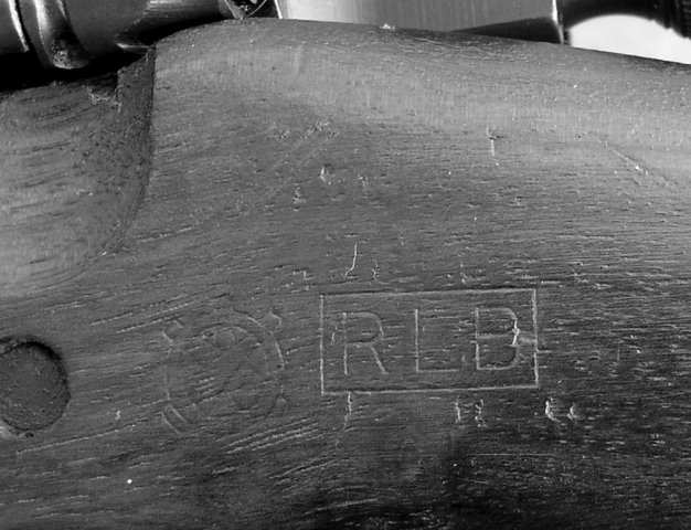

    Now, let me "brag on" #3,024,801. It is very similar to your rifle, as far as specific features. It is still one of my favorite rifles and my first really "nice" M1903. I got it about five years ago from a really good friend, who gave me a great deal, in exchange for some help I gave him in identifying some other M1903s he had.
    It has a 1-42 Remington barrel and a decent RLB inspection stamp. It is one of the "Red Star" rifles. The only flaw is that it has a replacement handguard. You can see from the picture that the red band doesn't match up. The handgurd was replaced during Britishicon service. This was far from unusual.
    You can see it doesn't have the British proof marks because, as you learned in the article, it (and 199 others) was imported "out of the ordinary".
    It has the "4-3" stamp, as well as the four subinspector symbols ahead of the front tang.
    It came covered in grease, but not the "deep" grease found on the CMPicon rifles, and I cleaned most of it off in an evening. It was in excellent condition and had seen little or no wear. The bore is almost perfect.
    As you can see from my "signature" to the left, I use a picture of this rifle as my "avatar", so you can see how much I like this rifle. (OK, I had to give a little "dig" abou my afghan!!)
