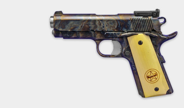

    iv stripped, beadblasted and refinished a lot of 1911A1,s. dipped them in acid, rubbed the dog do out of them sanded the surface down, ground on them , done things to a slide youd never thought would be done.
    the hardened area always comes back.
    they are surface hardened, but no amount of time, air or finish will change the color.
    with time, the original finish may fade or darken, but the hardened areas will always be hard, even 1911A1,s that were blued and polished, if you look close youll still see the dark spots, if you phosphate the pistol they will look just like the one in my picture.
    NM hard slides will be completely dark, as slide is completely hard, and not just the end and slide latch area.

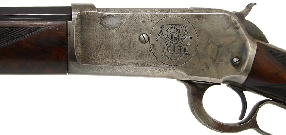

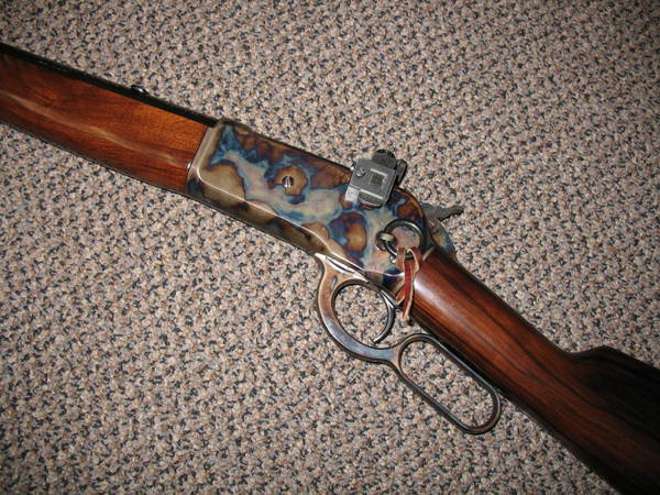

    before and after fading winchesters
    yes, the surface hardness remains.
    (restored case colors)
    worn 1886 case hardened bone/charcoal fiinish (original)
