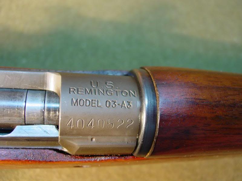

    I have read where many people ask how an original 1903A3 looked when new, so I have added several detail photos hoping to help.
    (The rough milling is a trait of A3's)
    ~ Harlan
