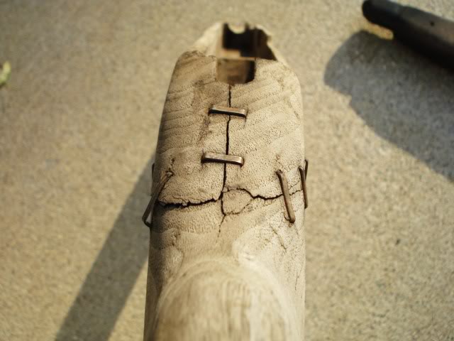

    Quote Originally Posted by cafdfw View Post
    Charlie tried to sell 'Frankenstock' to me too Rick, describing it as having some minor arsenal repairs that gave it 'Character'
    (I think he's been been spending way too much time reading George's ads!)
    To be fair and to give him a chance at revenge I'll put some pics of a really interesting carbine I've got up someday.

    Harlan and cmbtinfantry,
    'Frankenstock'
    Will come a live and will have a memory !!
