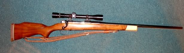

    yes, go to any of the gun broker . com types and just get a action, since you are going to customize it
    this rifle started out as a GEWicon 98 1916 model 98 and was probably a WWi bring back, bought the action for 25.00 at a show
    shilen barell, timney trigger, gentry 3 pos safety, custom stock, glass bed action, replaced all screws with allen sets
    used weaver 3x9 from gun brokers. com, good mounts
    blue job from a gunsmith all the rest i did, and oh yeah the bolt was replaced by same gunsmith
    as you can see it shoots well, this rifle was and is a gift to grandson when ever he does something to warrant it, so far he is a typical (still love the kid, but worthless) teenager. maybe some day he will get slapped and realize he needs to work to get things
    but back to rifle, cheap, no, took a lot of time, but it do shoot
