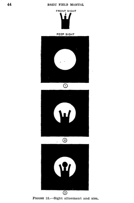

    Quote Originally Posted by MILSURPGUY1917 View Post
    my group at 100 yards set at 200 is 3-4" high
    If you use a six o'clock hold on a 6" bullseye, then you are just about right on, MILSURPGUY1917. Your rounds should be right on the X ring to an inch above.
    From the field guides that I've read from that period, the six o'clock hold was standard:
    From the BASIC FIELD MANUAL
    U. S. RIFLE, CALIBER .30
    M1917 (ENFIELD)
    If your rifle is zeroed at 200 yards: using the 200 yard ladder setting, your rounds should hit about 2" higher at 100 yards than they will at 200 yards.
  5. #14
    Legacy Member Randy A's Avatar
    03-16-2025 @ 10:25 PM
    263
    07-07-2025
    03:28 PM
    Sight picture
    He's right the manual does require 6 o'clock hold. Here is the site you can download it from. It looks like you might have to copy and paste in your browser. It can also be found at the bottom of the wikipedia site on a M1917 enfield search.
    FM 23-6 Basic Field Manual: U.S. Rifle, Caliber .30, M1917, 20 October 1943
