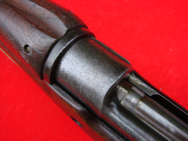

    Ran across this pic. of the star on a Winchester P-1914. This rifle also has many Britishicon proofs. JLS

    just FYI my P14 eddystone does not have the star , my 2/18 winchester M1917 does , no longer have my remington so cant check ,
