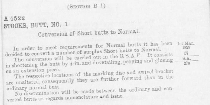

    If you think that welding receivers is shocking Mr. Laidler you should have seen how frightened I was when I found out the Britishicon played with their butts.
    I know what you are going to say, butt Badger wouldn’t let me post any real photos.
    (they used weldwood wood glue)
