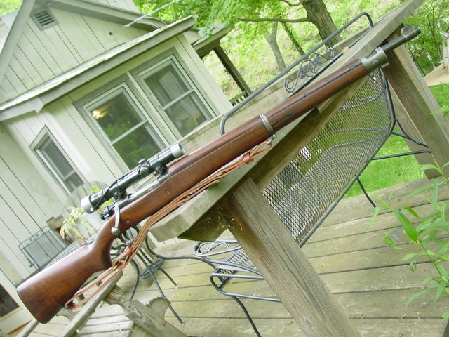

    I made this from a sporter. My barrel was full length and the whole thing cost me $400. PD
