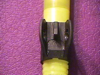

    painter777's Avatar
    Central Michigan
    5,493
    06-14-2025
    05:30 AM
    You have a WINCHESTER barrel !!
    Does the front sight look like this left one ?
    Winchester on the left........ Rock Ola on right......
    Thumbnail style milling.......... Winchester on the bottom..... Rock Ola on top..
    Another Winchester frt sight....... with heavier milling thumbnail pattern..
    Fun EHHHH ?
    Charlie-painter777

    Trapper's Avatar
    Feb 2010
    04-12-2010 @ 01:02 AM
    11
    06-14-2025
    05:30 AM
    Thank you for the site pictures. I'd say closer to the Winchester but not exactly..
