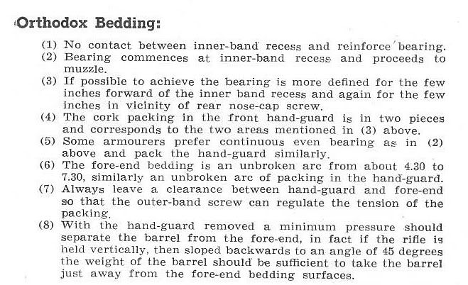

    Below is some "Sweet" information on "Orthodox bedding", the nose cap, spring and stud and inner band spring and screw are removed for this test of item No.8 below. Item No.8 explains how "tight/loose" the bedding in the draws area should be to allow the barrel to move away from the fore stock and allow the spring and stud to function and push upward on the barrel.
    Also note the "Inner Band Screw" is only tightened until spring compression is felt. DO NOT over tighten the inner band screw, this can pull the barrel down too tightly and cause the rifle to shoot high. (Don't ask me how I know this)
    Below, 1945 Enfield Australianicon parts manual (with "proper" nomenclature)
    Lou, always remember the proper Verbiage.
