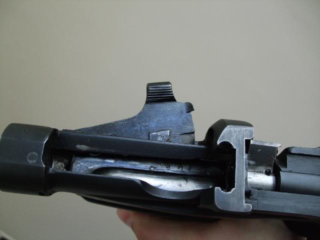

    As the action had undergone some major work by Bubba, i cleaned up the Breeching up ring, and reblued this part along with the top of the charger bridge and the bottom of the mag. (rust blue) (recipe at bottom).
    You can still see bubba,s work regarding the hardened pin,or screw he has used to plug a hole he drilled, the bluing took to the soft center but reluctant to to take to the side, i had stop the process there as the match was perfect.
    Last 2 pics above show the action with the mag cut off, i purchased this with screw, and the plunger and spring for the nose cap last year at the War and Peace show,from:
    D S Solutions DS-Solutions
    Very helpfull and freindly to deal with
    Rust Blue: I use a salt solution (Salammonaiac), area to be done has to be clean, apply with a paper towel etc, and leave to rust, in some cases i leave a soaked towel on the area until dry than remove, once rusted, boil in distilled water approx 20 mins, the area then needs the black oxide removing with a soft wire brush, steel wool or scour pad. the whole process has to be repeated approx 3 or more times for best results.

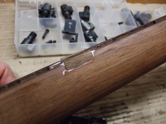

    That was the Fore-end done, while looking for a butt i found the original fore-end and on a closer inspection i found an old repair, hard to see in the pics but its there, and would say was done when in service and not by the previous owner.

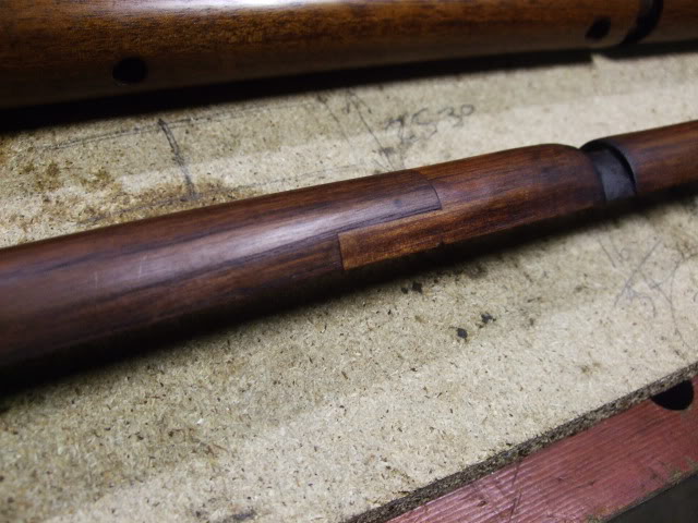

    The next bit was more of an experiment, i had an old forward hangaurd which was broke, which i was going use with a repro rear handgaurd i was going to get from EFD.
    I decided to square up the hand gaurd and have a go of splicing into a rear hangaurd from a No4. i didnt have anything to loose as if it did go pear shaped i could still use it.
    pics below show how a Mk111 set would be and the rear gaurd from a No4
    First job was to square off the end and mark out, then a bit of trimming.
    Next was to square up the No4 rear gaurd, and mark out.
    At this stage it was a case of trim, fit ,trim, fit etc
    That wraps it up for this stage, still a lot of work to do, the hangaurd needs the cut out at the rear and the barrel clip fitting, then its a case of glueing and sanding, linseed oilicon applying etc.

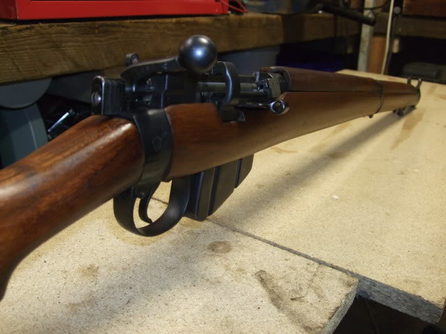

    With the barrel on hold thought i,d see what it all looked like with the action.
    Where i left off last time the handgaurd was in its finishing stage, and i did the cut out at the rear. (still to finish this and the barrel clip but left it until i knew what barrel was going on)
    After a few coats of Boiled linseed oilicon,
    Two things i had to remove from the old fore-end, the stock bolt plate, and the gaurd screw bushing.
    after fitting these to the new fore-end it was a case of putting it together to see how it looked ...
    The butt i wasn,t happy with (first thing to be replaced when i find one) if i do use it, will need to remove some material to allow the safety to operate and to cut the recess for the butt disc.
