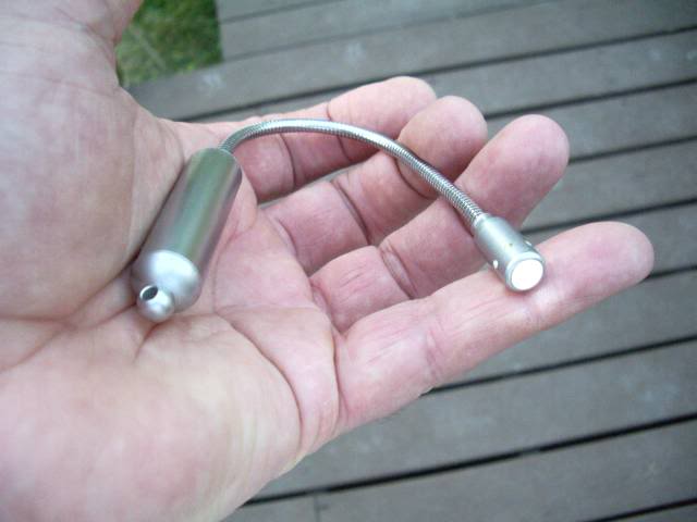

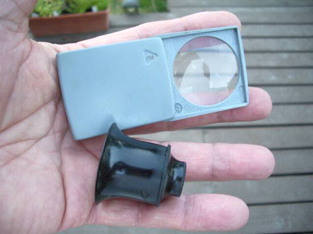

    What ever happened to the good old days when a little imagination and being dirt poor (or a really cheap bastard) and making due with a few simple things around the house.
    If you want to look inside your bore you need the cheap bastards bore scope, first you need a bore light.
    Then you need one or two magnifying glasses.
    Now turn on your bore light and place it in the chamber, next take your magnifier and look inside your bore at the muzzle end and you will see a close up of the inside of your bore.
