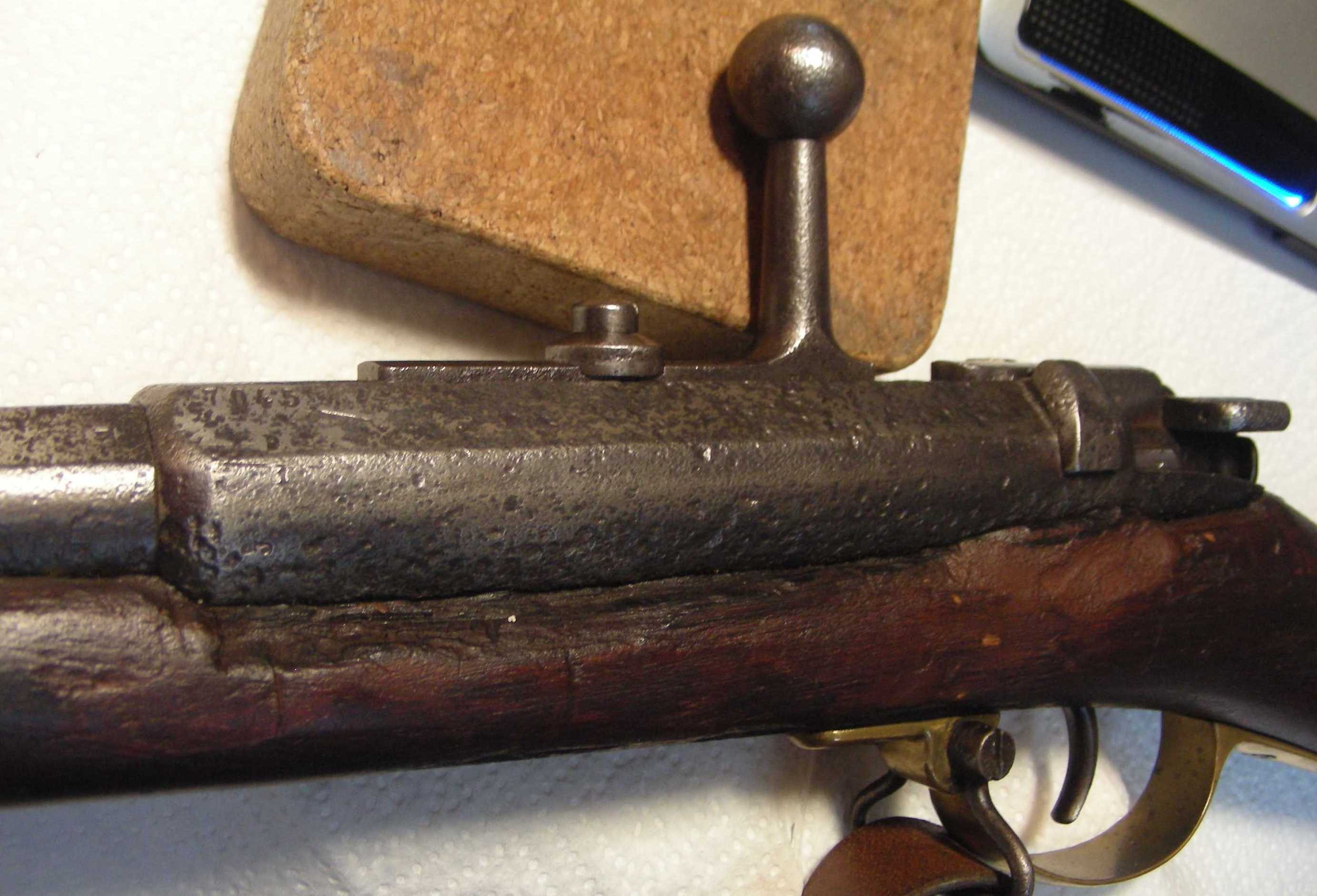

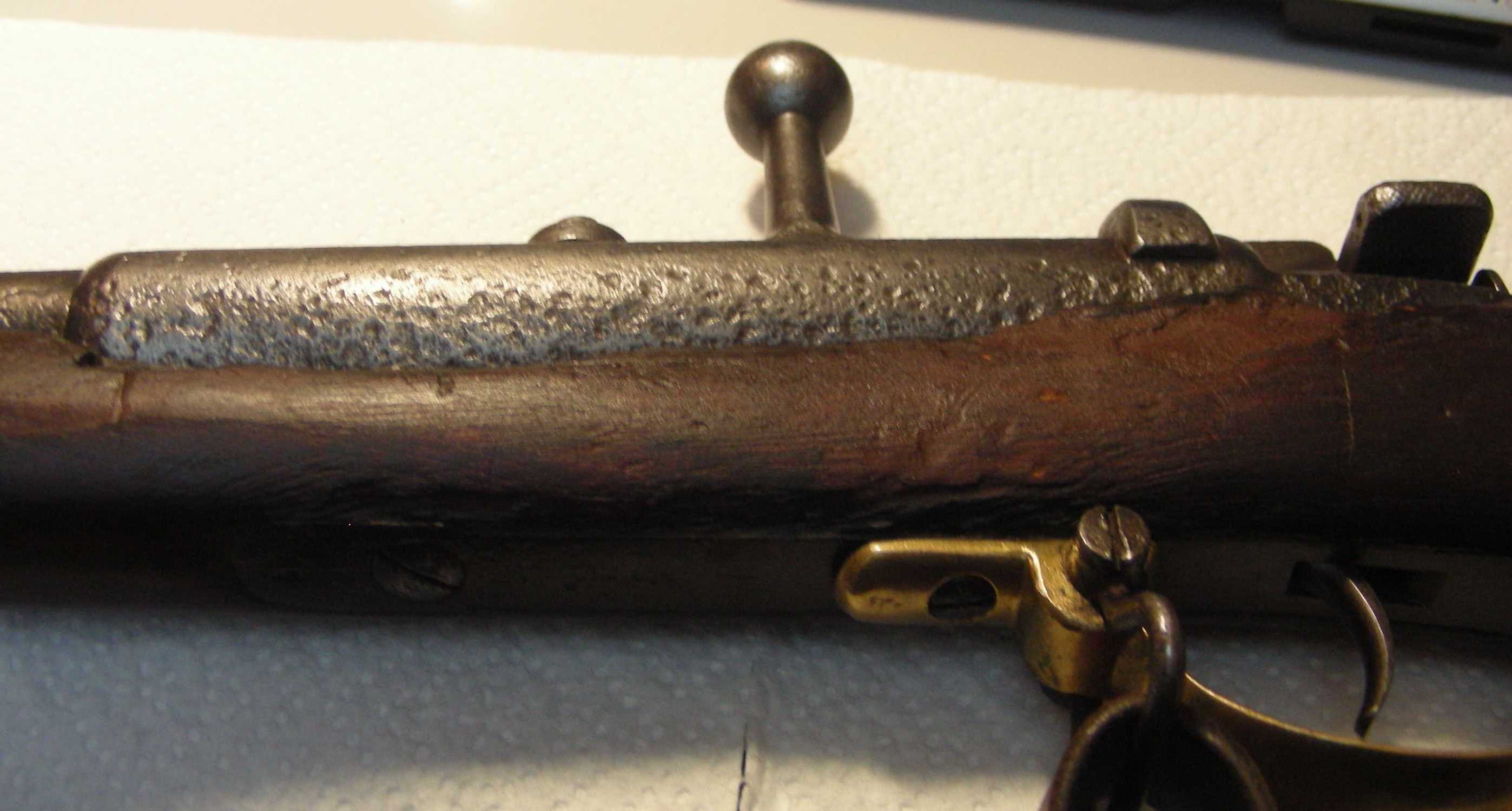

    A friend at work has offered me this rifle for “cheap”.
    He helped somebody clean out a wet moldy basement and salvaged it from the trash.
    I’m thinking maybe offering him $50 but I’m not sure if it’s even worth that.
    It took some work to open the action and the hammer will not fall hard enough to detonate a primer.
    The buttstock is not badly dented and would probably clean up nice.
    The is rust is pretty bad, especially on the end of the Barrel.
    Also the cleaning rod and sling are missing.
    The stock has a crack that could probably be repaired but would require some filler where wood is missing
    The sight is rusted in place and cannot be adjusted. A good soaking in WD might work it loose?
    The finely detailed manufacturer patent marks would probably be lost.
    What do you guys think?
    Give it a try or run for my life?

    Seriously, any untouched BPCR is worth 50 dollars/pounds/euros. Even if you can only clean it up to make a good-looking wallhanger. And that rifle is obviously untouched. The lettering is clear under the grime. Surface rust is annoying for a collector, but purely cosmetic if you are looking for a shooter. No woodworm or rot visible. What really matters is how it looks INSIDE the barrel. That is the make or break criterion.
    For heavens sakes, give the guy the 50 and I'll talk you through the basics. But PLEASE don't start Bubbaring unless the barrel is really kaputt. And that is a bit more subtle than just looking down it to see that it is black (it will be).
    Quote Originally Posted by killforfood View Post
    Is it worth restoring?
    Yes, it certainly is, but only if you make a proper shooter out of it. Let me have that thing in my workshop for a long weekend, and I'll turn it into something that would make you regret not having kept it.
    OK, that doesn't work, because of geography. So get it and start learning what you can do with apparently hopeless cases. The learning effect will be worth the 50 and a few hours of your time. Get it and let's have some more pics, starting with an overall view.

    The Model 1879 Argentineicon Rolling Block was chambered for the .43 Spanish cartridge.
    Components should be readily available from reloading suppliers. Lee even offers a Pacesetter die set. Easier and cheaper to feed than my Egyptian!
    And the frozen backsight can be unfrozen without brute force. The V on the sight leaf looks very crisp, so I think the sight will turn out well.
    The wood can be freshened without being chemically hammered into submission.
    The weak hammer action is probably simply the result of the action being full of fossilized muck. Could be a weak spring, but plain muck is more likely.
    When I got my Martini Henry the firing pin would not have squashed a paper bag - it just crept up to the block. After cleaning out the "yakolene" it now works perfectly. So you may be lucky too.
    It's the bore condition that is the real question. Contrary to received wisdom, just looking down the bore will often not be enough to make a judgement. I have learnt not to trust my eyes alone.
    Go and get it, and report back!
