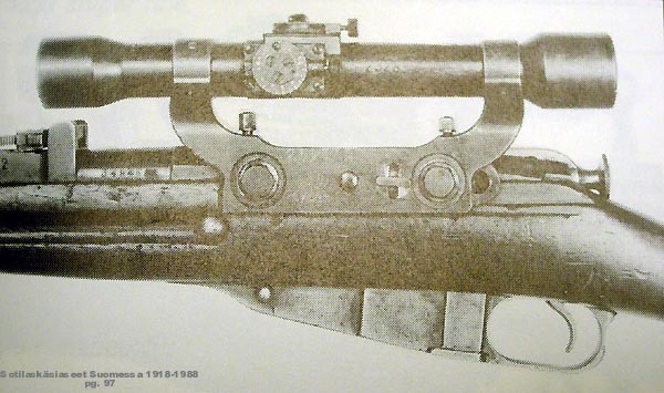

    I suppose another possibility is that you really have an ultra rare m/28-30-33 sniper rifle, though this is probably not likely give rarity. (pic borrowed from www.mosinnagant.net)

    I wish it looked like that, but it is just as odd looking, maybee more. I'm going down to my shop and try to get some pics going (don't hold your breath) I reall stink at this stuff-SDH
