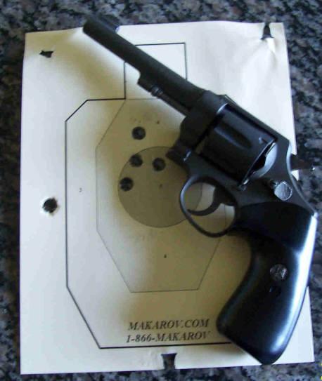

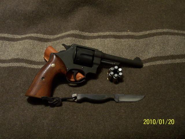

    Some old pics
    I put 48 rounds of 255 gr cast reloads through it last night w/o a hitch. It shoots straighter than I can hold it still
