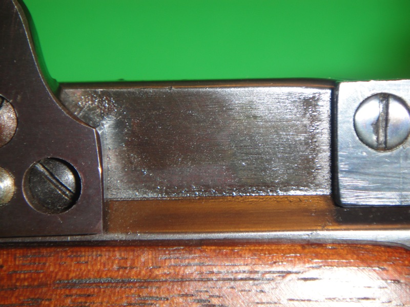

    Not directly related to the 1941, but here's an example of a metal plug on a Long Branch, before they turned it into 1 of 20 experimentals. There's a metal plug on one side of the receiver and it's been buffed clean on the other side. (see pics)
    When Claven2 was over visiting and checking out this rifle, he noticed it.
    (Click PIC to Enlarge)
    Regards,
    Doug

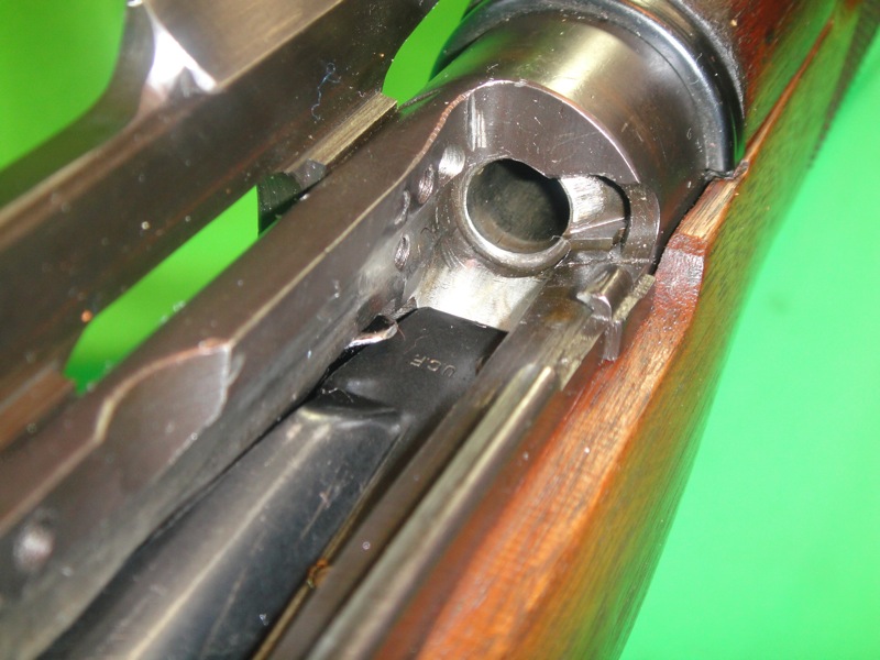

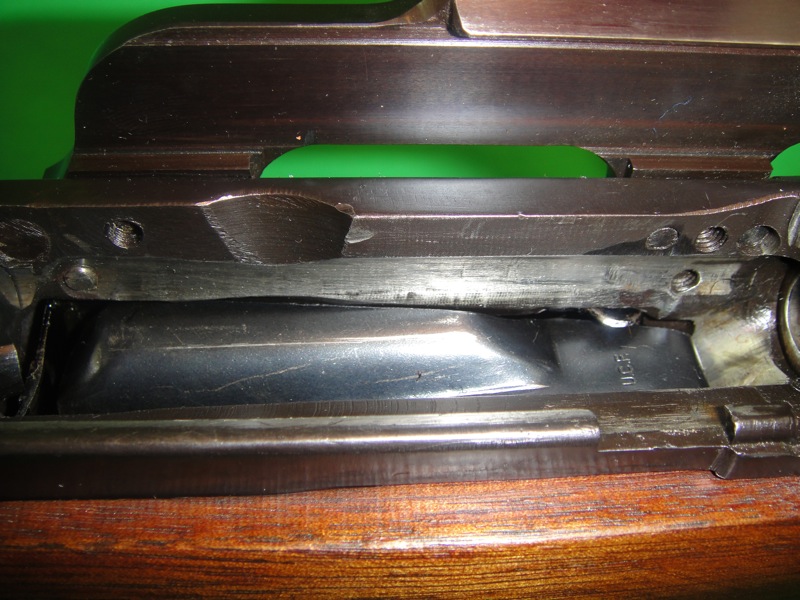

    The hole
    would it look like the hole in the socket of this 1931 No4 trial rifle?
    This was a range rifle at some time.

    That looks pretty close to what I am talking about. Same location. Now, what about the Savage question...?
