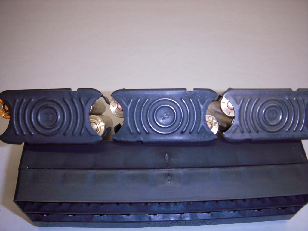

    I also had problems when I first started collecting and shooting Garands, the only en blocs you should use would in my opinion be USGI. Even the ammunition bought through CMPicon has occasional en bloc problems, these are usually European manufacture that the Greeks contracted for.
    To give a better answer I think it would help if you described what initials are present in the circular stamping of the rear outside of the en bloc. Here is a link that may help you identify the manufacturer.
    Enbloc Stampings
    As for the rough texture of the en bloc, use a scotch brite pad or steel wool to polish it smooth, I always check my en blocs and load each one to ensure a smooth performance at the range, even the ones packed in a bandolier get unloaded, inspected, touched up, then replaced for use.
    I foolishly bought a box of 20 en blocs from CTD several years ago, the only redeeming value I received was the practice involving about every malfunction an en bloc could cause. Take my advice and use GI en blocs, and polish them up a bit and you shouldn't have a problem.
