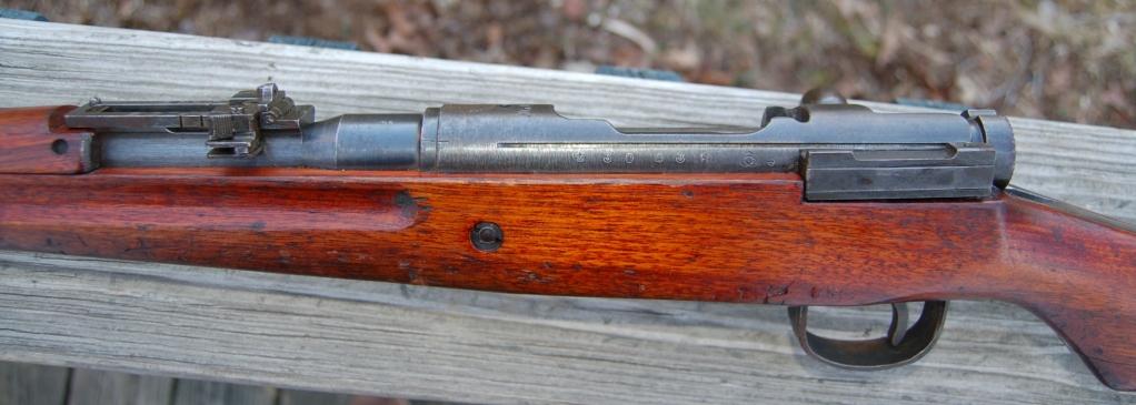

    I spent about 4 hours on this today cleaning it up. Scraped off the hard rust with the flat of a screwdriver to break it loose and used a combination of a wire "toothbrush" and fine steel wool to clean up the metal after getting the grease off it with Rem-oil and a regular toothbrush. Took the bolt apart and clean it out along with the rest of the interior. No rust on the interior mechanism. Stuff definitely looked like cosmolineicon. Stock was sticky and dirty and I wiped it down with one cleaning of a BLOicon soaked paper towel and then dried it off. Came out pretty nice.
    Bayonet did not come with this rifle sale, I picked it up a year or so ago and it's been waiting for a rifle ever since.
    I can't tell what the series marking is for sure. Doesn't look like it matches anything but looks closest to either 21 or 35 of which neither was produced at Kokura Arsenal. Best possible match that I can tell is series 22. Confirmation or correction would be appreciated as well as whether it need the aircraft sights and mono-pod.

    Looks like series 21. Kokura made series 20 to 25. It would have had a monopod, dust cover, aircraft sights and long cleaning rod.

    Thanks, I rechecked the listing and not sure why I thought 22 was the earliest Kokura. I'll keep my eyes open for the accessories. Doubt I'll find a monopod anytime soon.

    Congratulations Aragorn. Yes, series 21, which means early production, with all the trimmings. And it has an urushi finish. Whatever else you do, preserve that finish. No funny stuff with stove cleaners in the bathtub, or any of the other dubious methods I have read for ruining wood surface and stability. In fact, just wiping over it with linseed oilicon was about the best you could do. A very good purchase for $90.
