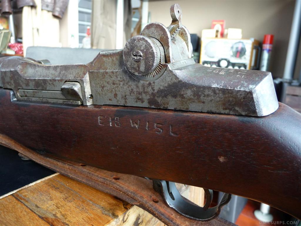

    There is a number carved in the wood on the left side just above the trigger, E16 (it may also be E18) W15L..... I would love to know what that stands for...
    Elevation setting, windage setting for the rear sight. Normally written elsewhere on the stock. Thanks for the lowdown. Priceless.

    @ Jim, mysterie solved. That gives the rifle a real personal touch to me. Have you seen these corrections carved in the stock before? Try to look at my pics, you can find my album at Photo Gallery (at the top of this site)>photogallery home, album M1icon garand from Daanvdt.... I put it there yesterday. Thanks again!

    Normally the sight info is written inside the stock or perhaps inside the butt trap door. The carved part would be frowned upon. I'd love to have a go at cleaning that rifle up a bit just to have hands on the history.
