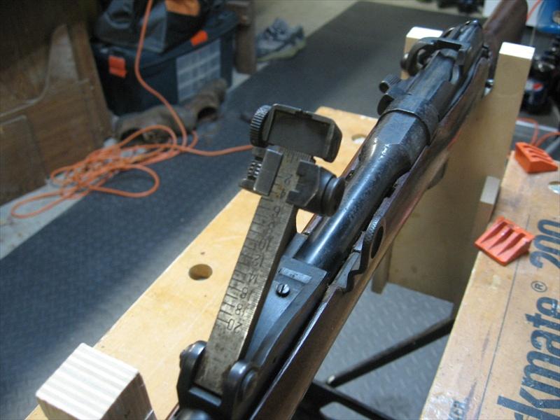

    I have the makings of a good collection of enfields but at the gun shop the other day I picked up what I thought was another No1MkIII (no star). It has the cut off, the windage adjustable rear sight, the forestock is kaput, but I got it to have as a restoration project, so it will be getting a full length one anyhow. All of the following pictures were taken prior to cleaning
    Here she is.
    (I know, someone has put the sight protector on backwards)
    At the shop I noticed the big things, like the crack, and that none of the numbers match. The bolt, receiver, barrel, and rear sight all have different numbers. Good news is, the bore is in fairly good shape, there are a few little pits, about a dozen. Also before disassembly I checked the headspace and it checks out and the crown is good too.
    Now we get deeper into things. The RH wrist has the GR below the crown and BSA Co below that. There is no date stamp, or SMLE MkIII stamp. On the top of the receiver “A.G. Parker & Co. Ltd Birmingham”, and on the knox form, “AGA Ball Burnished”. (Later found out from smellie what ball burnished means)
    I see that this is starting to get long, so I’ll continue with a bunch of pictures and captions, and finish with a paragraph or two.

    I'm not sure what you mean by: "trade rifle". It looks to me like an SMLE that has been made by BSA for the government. (The Crowned GR, Government inspection marks and Broad Arrow mark.) It was later bought out of service and turned into a target rifle by AGP. (As you have spotted, the posh target rear sight has been removed at some point.) It was probably at this time that it received its civilian Proof. The civilian Proof Mark is a Gunmakers Company (London) Military Proof and so the rifle was Proofed for civilian sale sometime between 1916 and the 1954 - probably "between the wars".

    Rifle is definitely a trade pattern SMLE III made for commercial sale. Likely early post WWI era by the serial number prefix. Never had a date on the receiver either it's correct as is. Forestock style will be the late WWI style dimpled forend relieved for cutoff.
    I'd say you got a good'n!
