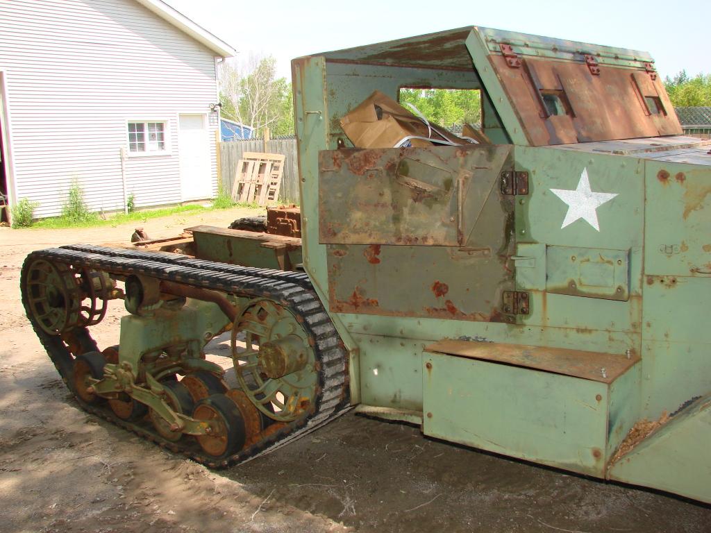

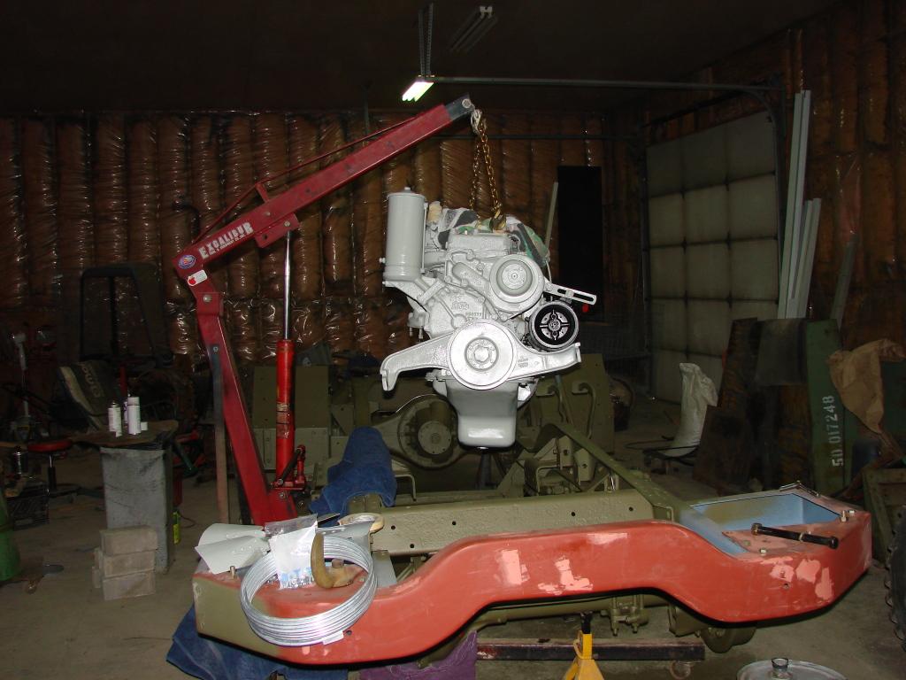

    Well I hope you enjoy looking at the progress of my halftrack restoration as I am building it.
    Im trying not to replace every part but when you get in this deep its hard not too. every part is either reconditioned or replaced. Its like restoring an old car, but to remove and install some body parts etc a hoist/bobcat with forks is needed

    I didn't touch it for awhile, sat in my shop and I did research all summer. During that summer I did locate NOS tracks that came out of Israel. They were made in 1994 (stamped on them) There military were still using half-track into the late 80s, and had bought the equipment to make the tracks. I understand the fellow who owns the molds will still make them for a minimum order.

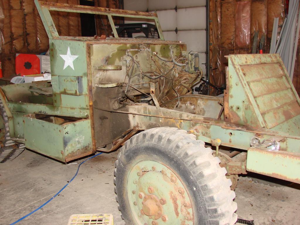

    I started to strip her down in the fall of 2011. I had to purchase a plasma cutter as there was way to much to cut off with torches.
    Since last summer I also started collecting the parts I would need. Turns out there is still alot of NOS stuff out there, still wrapped in cosmolineicon. I'd say 70% of what I can get is NOS parts, with the rest being reproduction.

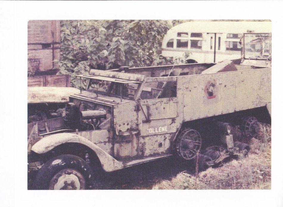

    Here is a picture from Southern Parts in the US. They surplussed off alot of military parts/vehicles. Look closely at the doors! This was shoot circa 1970
    and now mine
    Not the same halftrack, but the doors did come from that one!
