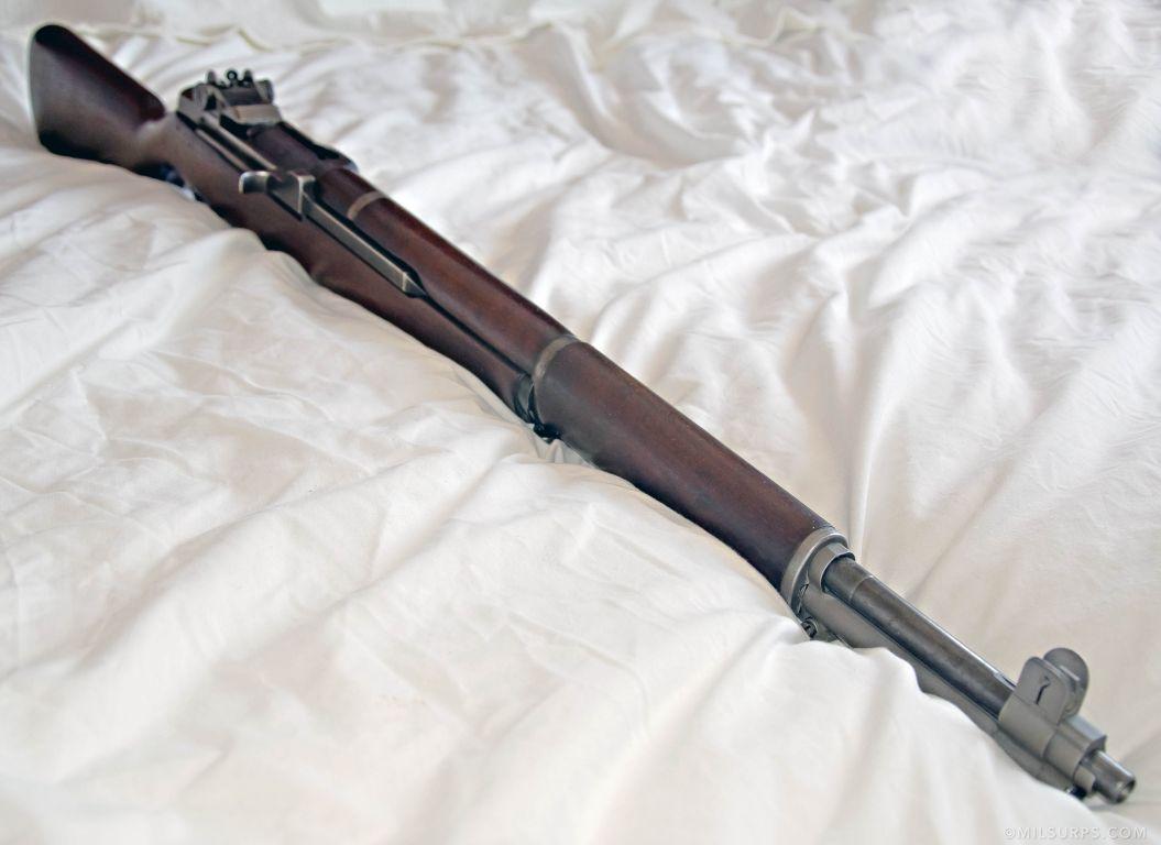

    M1 Garand Identification
    Hi
    I have just purchased a deactivated (I'm in the UKicon) M1icon Garand.
    Details;
    H and R Arms Co. serial number 5700101.

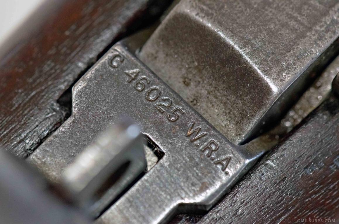

    Trigger assy marked c46025 W.R.A

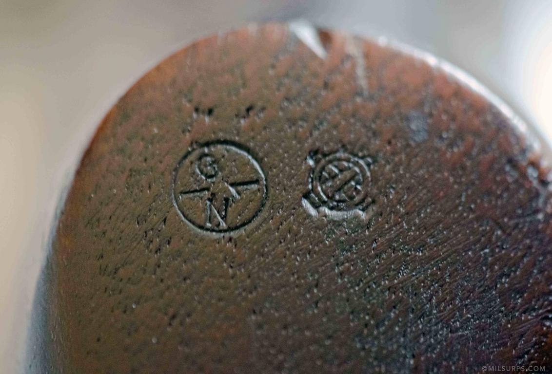

    Cartouche stamps on walnut stock are -
    -ordnance wheel with crossed canons
    -Circle with what looks like GIN1 in it?
    There is no P in a circle?
    The end of the barrel has 'x' stamped all across numbers so I cant read them?

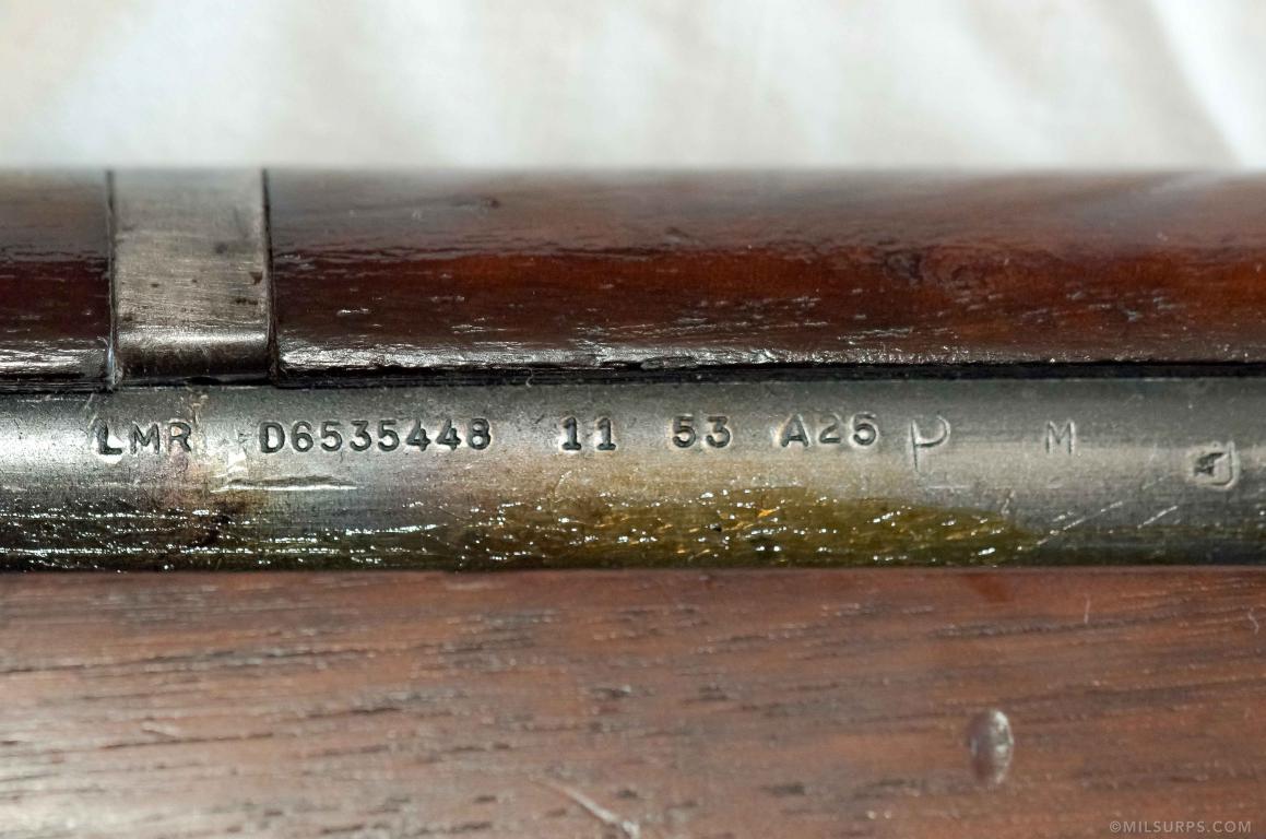

    When bolt pulled back, the following is visible on the barrel;
    LMR D6535448 11 53 A25 P M (The 'P' is larger than the rest of the characters.)
    The bolt has the following;
    D28287-198A
    A-9
    Can any one give me more details about this Garand?
    Thanks.

    Hard to say if the 11-53 LMR barrel is original to the rifle. The majority of the LMR barrels found to be original to late HRA rifles seem to be dated during 1955. Keep in mind that many LMR barrels were used during rebuild programs. Is there a punch mark either within the loop of the P or close to it ?? The P being the one on the barrel. Barrels installed by HRA will have the punch mark in this area. Barrels installed during rebuilds should also have a punch mark in this area but it was often overlooked. What I am trying to say is that the lack of a punch is a good indication the barrel was installed during a rebuild. If it has the punch you will have to look for other indicators of a possible rebuild.
    May 2010
    07-12-2024 @ 04:15 PM
    Northern Illinois
    577
    Joseph Budde
    04-25-2025
    11:47 AM
    Like this Joe?
    Legacy Member Joe W's Avatar
    07-20-2021 @ 09:25 PM
    S.W. Florida
    720
    04-25-2025
    12:47 PM
    YES, thanks for posting the picture Sgt.

    **update** bolt details are
    d28287-19sa
    a-9

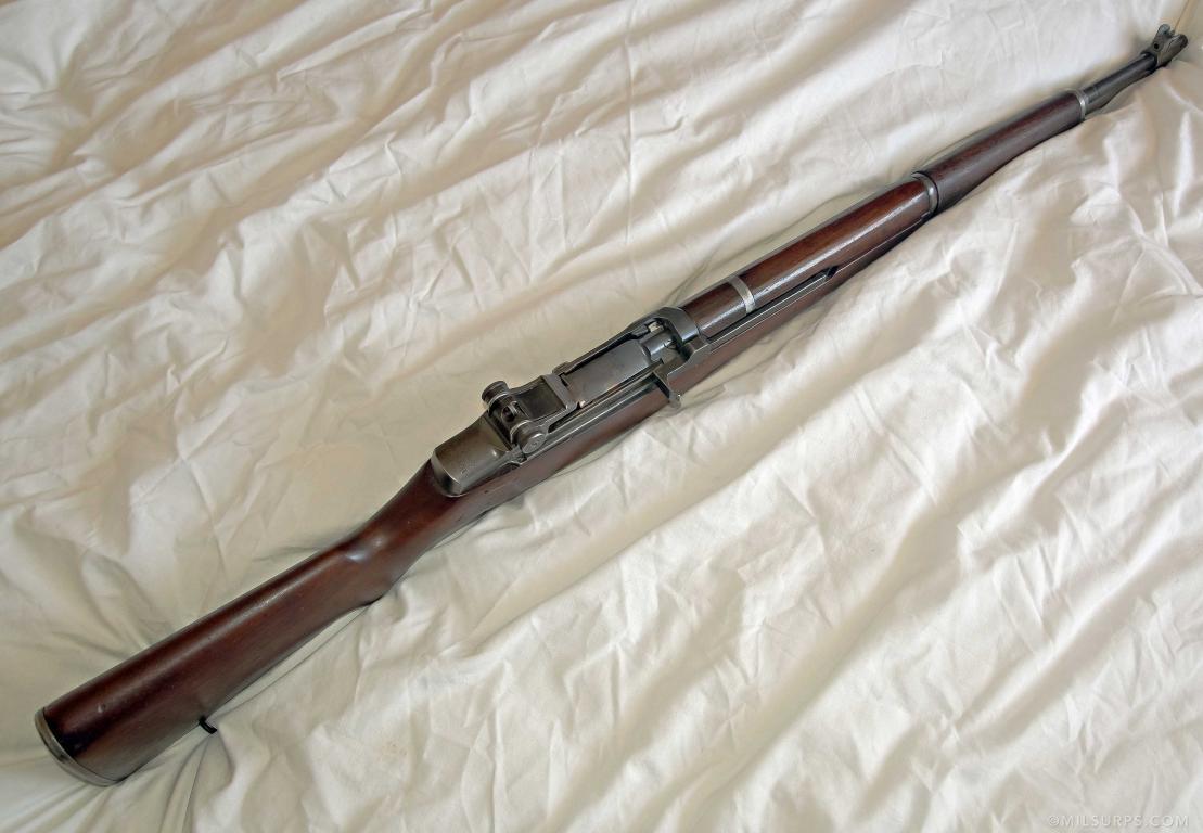

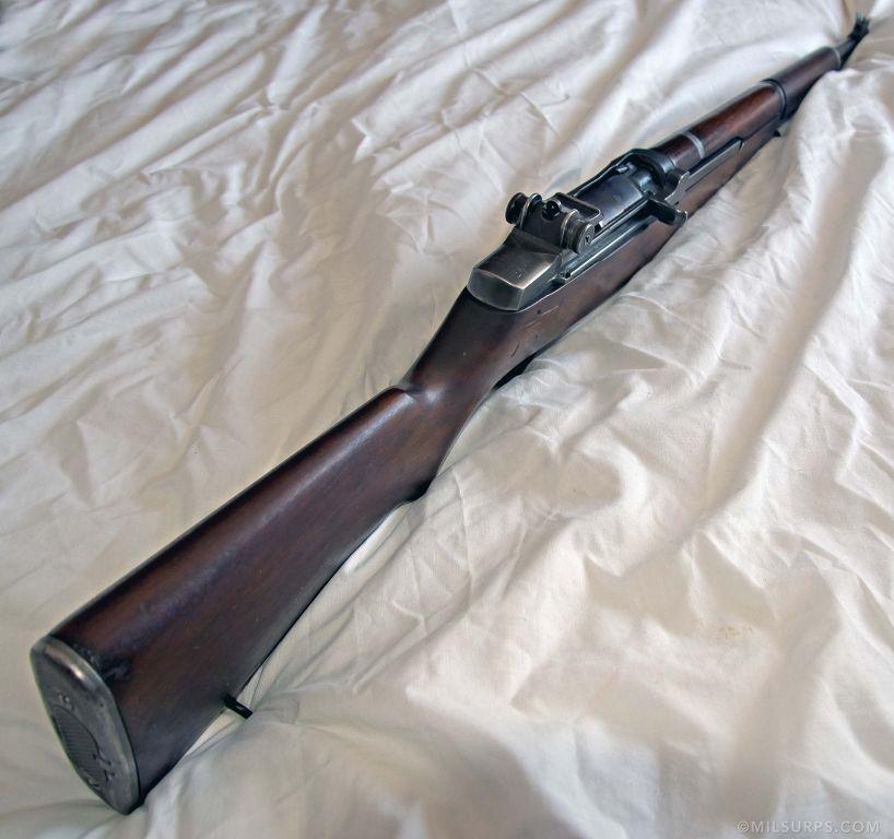

    Here are some photo's:
    Thanks for all your replies so far, appreciated.
    Yesterday @ 03:38 PM
    Nothern New Jersey, USA
    608
    04-25-2025
    12:47 PM

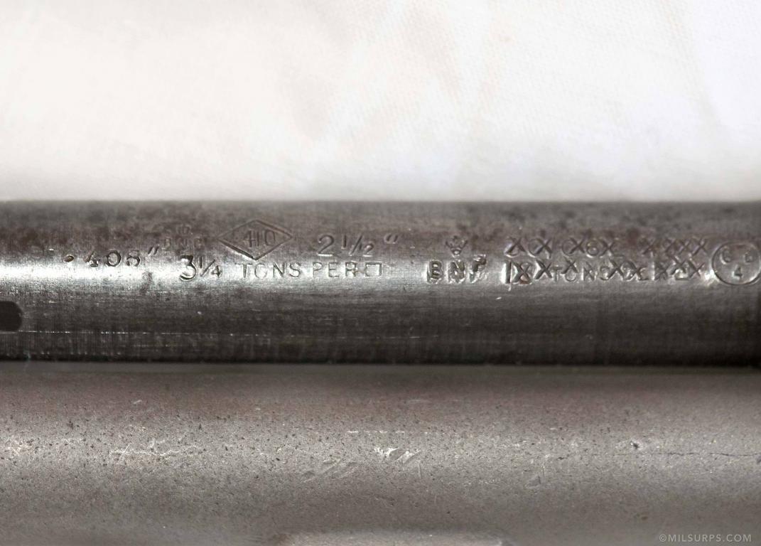

    The "XXXXed" out barrel stamping are import markings into the U.S. by Arlington Arms, Arlington, VA. Next to them are commercial Britishicon proof marks. Most M1icon rifles imported into the US by Arlington came from Korea. The rifle may have obtained its replacement LMR barrel while in Korean service. In any case the barrel was on a rifle that was imported into the US from Korea, and was on a rifle proof fired in Britian, not to say it was the same rifle.
