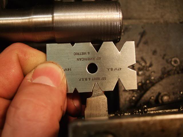

    Quote Originally Posted by Brit plumber View Post
    I also need to learn how to cut threads on the lathe rather than using a die on the lathe and turning the chuck by hand (I have been watching Utube vids to get the idea)
    BP, I can give you a few pointers regarding threading on a lathe, one thing you need is the gauge below, cheap as chips and saves a lot of tears, used mainly for lining up the tool so its square to the job.
  10. Thank You to bigduke6 For This Useful Post:
