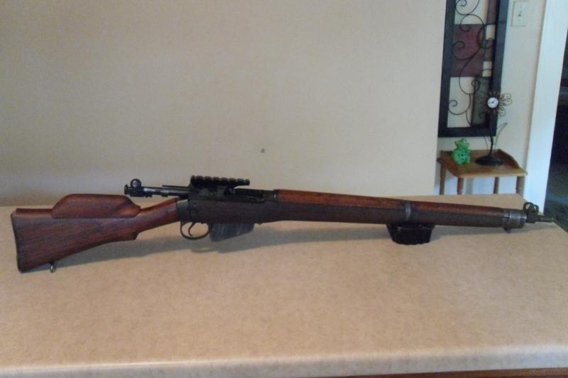

    back to the build.
    here she is back to what she is suppose to look like. got all the paint off and cleaned up.
    i still have some fitting to do on the cheek piece before it is put into place.

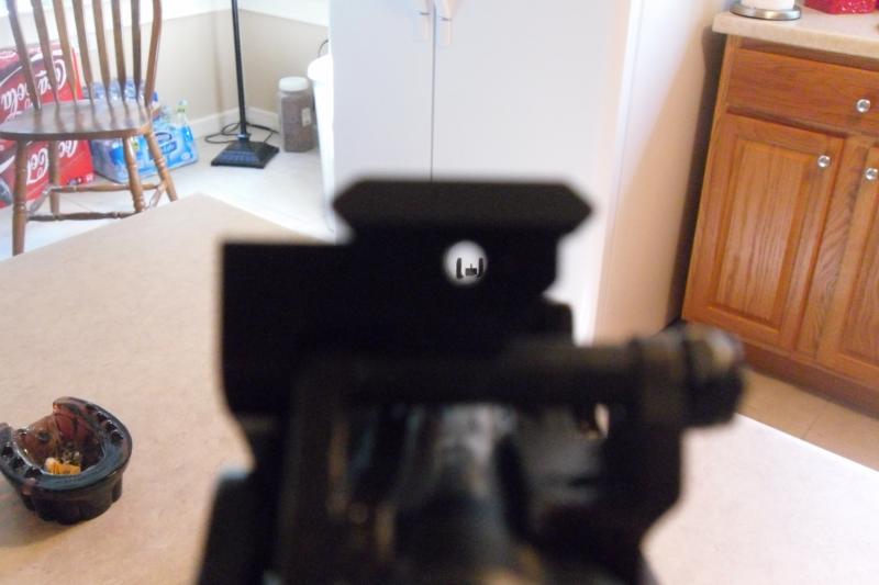

    here is how the site bolts on
    cool thing is i can take the bolt out with the site on the rifle. unlike my T no 4
    here is the peep sight. now i don;t know if it is a peep site , but i will find out when i start shooting the rifle again. looks like one to me.....but what do i know.
    now, i just need some ultra low rings and the scope. but i still need to bed the action.

    That mount was made 15 minutes from me, I met the guys and they are very good guys to deal with.It is the best alternative as it still is set for a 300 yard battle site. The last bracket just went for over $600. yikes. I have pictures with a weaver K3 if you want to see it mounted...

    Awesome. from comparing it to my other enfield sites . I thought it looked like a 300 yard sight. Tell those guys i am as happy as can be with their sight. Yes please post a pic.
