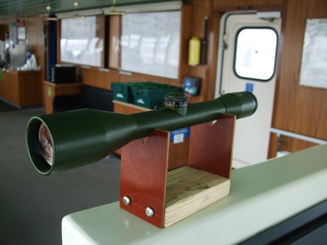

    Not an Enfield scope but it did the put the No32 into retirement..
    Just a bit about the scope, Its a Schmidt & Bender PM 6x42 off an L96 and I was offered it last year but had lost contact with the seller, so was a bit of a supprize that I received an email from him a few weeks back, the deal was done, so I,m just looking now for the rifle to go with it.....

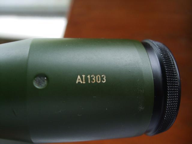

    So just a few questions, the serial No on the scope is, AI 1303, (didnt know about till it arrived) is this the rifle serial No it belonged to or just the scope number ? may sound a daft or obvious question to some but I havent a clue. I thought the L96 may come as a complete package ... rifle, mount and scope.
    Second question, a thread or post from a member showed a pic of a bracket for the S&M scope on a L42, anyone info regarding that, was this a bracket made to test the scope well before the L96 arrived ?
    Anyway a few pics,

    The scopes came separate from S&B and were matched up at AI for delivery to the Army. The scope number does not match the rifle number. The scope number didn't feature in the CES at all BUT sometimes the rifle and telescope were both numbered on the left side clamping plate of the bracket, such as R-1190 T-1034. It was on the clamping plate so that if the telescope was changed, then it was a simple job to change.replace the clamping plate. I sold an L96 bracket for this scope on that auction site a couple of weeks ago. Shame you missed it.
    Your BIG hurdle now - and some say impossible hurdle - is finding an L96. Have you ever heard of rocking horse manure?
    These scopes are the same as the bog standard commercial version except for the colour and the drums. But the L96 drums will fit/interchange. So on that basis, it is a very simple matter to make one of these up. In Military terms, they were called TELESCOPE, straight, sighting, L13 A1.
    There was a later 4 - 12 x replacement called the L17A1. But it didn't last long and is now obsolete, along with the L96. All gone to the big furnace in the sky. The UKicon MoD owner the IPR to the design of the L96 and private/commercial sale was prohibited. But some Police Forces who felt the need for snipers (oh...., don't ask.....) purchased some but the MoD quickly put a stop to it. To be honest, this tele wasn't the first choice either, That went to a Bushnell telescope that was 10% of the price but......... Just a minute, I seem to recall that there was a thread about this little Bushnell a year or so ago.
