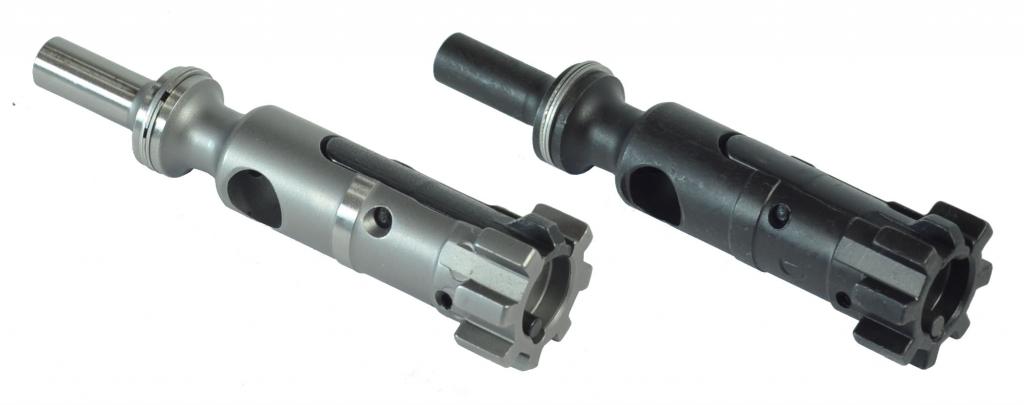

    JP EnhancedBolt™ on left as compared to a Mil-spec variety bolt on right.
