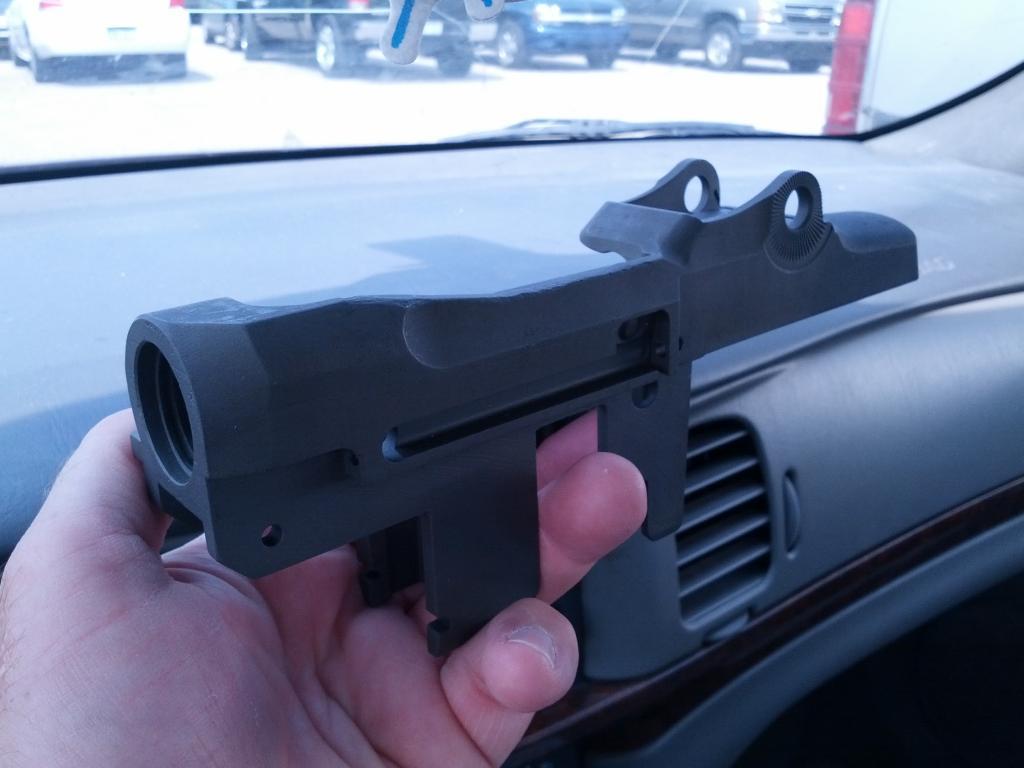

    However, I would like to show off my NEW (to me) M1icon Garand receiver. While I have a .308/ NATO kit to convert a Garand, I won't spend it on this receiver, as I would like to actually dress it up USGI.
    I am told that the Serial Number: 224,357, is an April make of 1941.

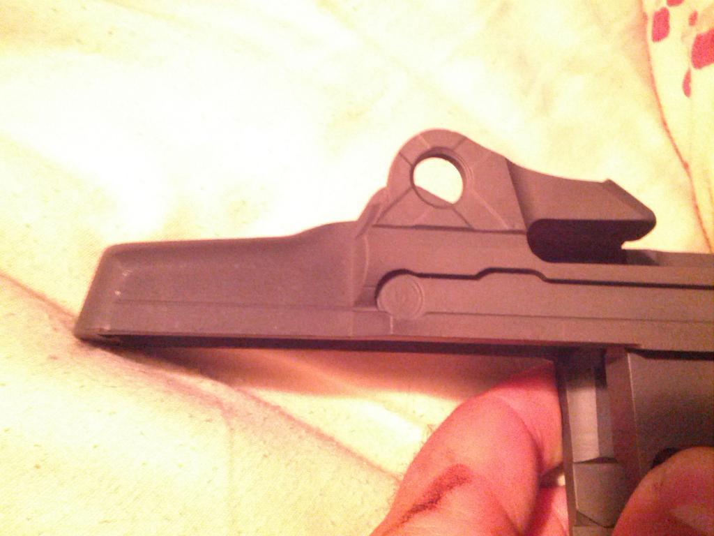

    What drew me to it, was the two tone nature of the beast! According to the seller, this was the earliest SN that he had encountered with the two tones. I had never seen a two tone before, and was at a loss as to what it was until he explained...
    I am told that the two tone nature, is due to a lead annealing process used on some receivers. Especially for grenade launching purposes, until a change in steel was done.
    Here are some photos...
    Two tone heel

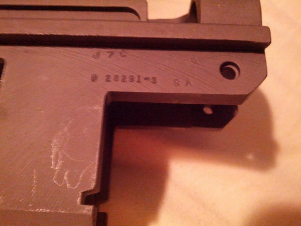

    Drawing numbers and heat code:

    After the grenade launcher was developed, earlier receivers were annealed whenever they came in for rebuild. Some were also done at depot levels. That means you could find a two-digit with two-tone, I've seen 3-digit receivers that were annealed.

    Thanks, Joe. Whatever the merits (and I have my own opinion), Ordnance changed to a less brittle steel. To be perfectly accurate, earlier receivers with the original steel were annealed. The change was made at the time of the development of the launcher.
