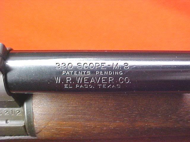

    Hello to all from a relative "Newbie" to this site. Really impressed by all the threads I've been reading. Have a question regarding the scopes used on the 1903-a4's....
    Recently acquired a very nice 1903-a4 from a family member of a WWII (or Korean War?) vet. Rifle looks as if it was never issued and has a rather rare "Z" prefix serial number, which according to info I've read, dates it to Jan-Feb '44 manufacture or issue. Rifle came with original staked Redfield scope mount, but no scope or rings. Have acquired correct 3/4" scope rings and am trying to figure out which scope was originally issued with this rifle.
    I understand that the Weaver model 330-C, which was a commercial model, was originally selected as the scope for this rifle, and was later assigned the military designation M73B1. I have read that early Weaver scopes for this rifle were marked either model 330-C, M73B1, or even model 330 M-8. However, the models 330-C that I have seen have adjustment knobs that were friction-locked, whereas the military specs required "click-adjustments", which only the model 330-M 8 has. I assume that the M73B1 is the same.
    My questions are; Is the model 330 M-8 the correct "early" scope used on the 1903-a4? At what point in time were all Weaver scopes marked M73B1? Given the manufacture dates of the rifle I mention, what was the correct scope for it at that time? And at what point in time did the Lyman Alaskan take over as the standard military issue sniper scope in WWII for the 1903-a4? I have a chance to buy an Weaver 330 M-8 and want to make sure it's correct for this rifle.
    Thanks to all for any & all input. --728shooter

    1. No Weaver scopes were marked 330C. The weaver scopes, either the click adjusted 330 C or the Screw adjusted 330 S (Silent) were simply marked 330. It's possible the commercial packaging may have been marked as to the style of adjustment and reticle.
    2. Remington was behind the eight ball on A4 deliveries in early 1943. The main reason for the delay was Weaver's inability to deliver scopes as fast as Remington could build rifles. To meet the delivery schedule Weaver rounded up as many 330 C scopes with Crosswire Reticles and as many 330 Scope - M.8 with tapered post reticle as it could find in US commercial channels. These commercial scopes were mounted on rifles and delivered to the Army. Based on scope serial numbers the aggregate quantity of commercial scopes may have been as many as a few thousand units. Thereafter Weaver ramped up production of the 330C but added military nomenclature and a serial number to the side of the tube with electro-pencil.
    It is unclear just exactly what the commercial nomenclature "330 Scope - M.8" signified. Regular 330C and 330S scopes were both catalogued with crosswire and post reticles. 330 Scope - M.8's are encountered today with both click and screw adjustments.
    3. By about serial number 5000~ (early mid 43) all Weaver 330C scopes were marked "Telescope, M73B1" in electropencil or rolled stamping on the W&E plate.
    4. A "Z" Series A4 would most likely have been issued with a scope stamped:
    Telescope, M73B1
    Pats. Pend.
    W.R. Weaver CO.
    El Paso, TEX USAicon
    The words Serial No. would be stamped on the side of the tube and the actual number NNNNN applied with an electropencil.
    The adjustment knobs may have had plain flat tops or the resettable zeroing plate anchored by a small screw. Abetter guess could be made if we had the full serial no.
    5. Although the Lyman Alaskan was approved for use on the A4 in Dec 42 and later militarized as the M73 none were delivered prior to the end of A4 production. It was never the standard scope for the A4 in WW2. About 1956 an Ordnance directive was published which specified that the primary and alternate scopes for the A4 were the M73B1 and the M84 respectively. At the same time units were authorized to use any remaining M73, M81 or M82 scopes on hand in the event the primary and alternate scopes were unavailable.
    6. A 330 Scope - M.8 would be most appropriate on a very early A4. However keep in mind this was a piece of commercial gear pressed into military service and not an official piece of "issue" equipment.
    Hope this helps.

    You might want to post photos of your rifle for us. Whether it is "unissued" or "unissued since rebuild" might give you more choices in your scope selection.
    Bruce Canfield (August 1999 American Rifleman Q&A column) believes that the M8 scope was produced only for a military contract, after the M73B1 scopes began to be delivered.

    Neal Myers, Thank You very much for your input & comments! I will try & post pictures when I get the A4 out of the safe to install the scope. As to your comments about "I suspect that few A4's were stolen from the military"...., I have a feeling that this was one of them. The young man I purchased it from made it sound that his uncle "procured it" by rather clandestine methods....
    Interesting that some of the CMPicon rifles were classified as either A or B grade. I'll have to check mine to see if only the only the left windage screw is staked. However, given the background that I received, I can't help but believe that this was a war bring-back rather than a CMP rifle. As for the lottery rifles, I believe this young man obtained it well before 1999...
    The M.8 scope I have looks exactly like the one you show in your pics except that the "data" info is located directly under the turret knob plate, as opposed to being further down the tube as shown in your photos I have Weaver S-29's that are similarily marked. I know that Weaver scopes from that era had a variety of ID stampings, I just wonder if the type ( and location of such) can identify as to the time frame to when they were manufactured. Strange that the M.8 designation was produced "after" the M73B1 scopes were being delivered.....
    Thanks again, --728shooter
