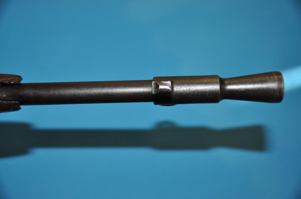

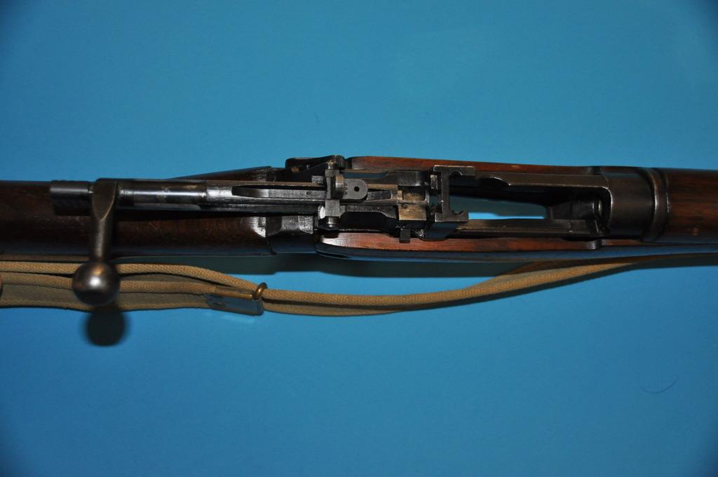

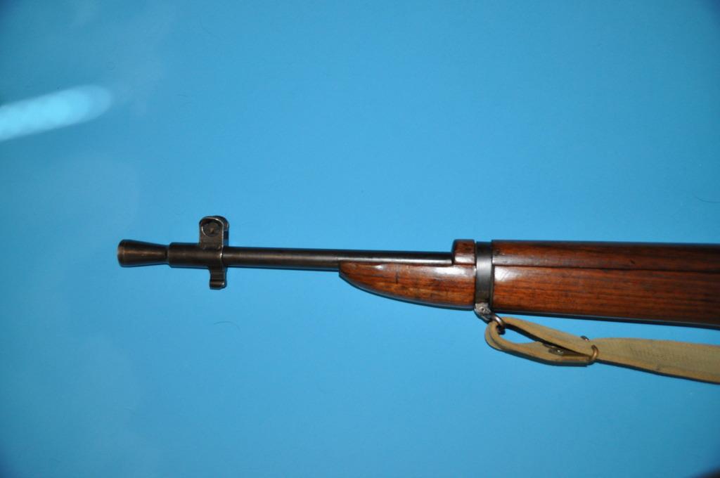

    So I put a deposit down on this one today, picking it up soon. I'm not that great with the No5 but noticed the bolt knob and the incorrect double aperture. Now, the bolt DOES match the rifle. It IS a No5 action, confirmed by serial and the lightening cuts.
    The barrel (and flash suppressor likely) doesn't match.
    Thoughts?
    Obviously some interesting things going on here.

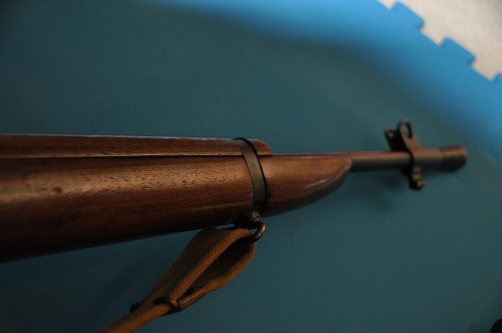

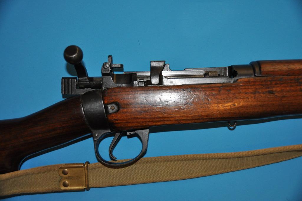

    From memory of a long time ago, it looks like it's got a load of standard No4 parts on it such as the backlight, wider No4 type trigger guard and a home made fore-end made from a cut down No4 one. You CAN use a modified No4 one and we had them issued but they were patched and pegged to suit.
    No doubt some of the experts will come in with more little niggling faults. Realistically speaking, No5 bolts are just the same as the different styles of fore-end end cap. It don't make any difference at all. Just differ by drawing number only.

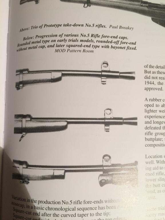

    I don't think the foreend is a DIY, it matches Skennertons book pretty closely.

    It's not even close to the book. Without effort, as soon as I looked, I could see it's got too much sweep upward for an original... Look at the comparison of the measurements from FH to wood...from wood to band.

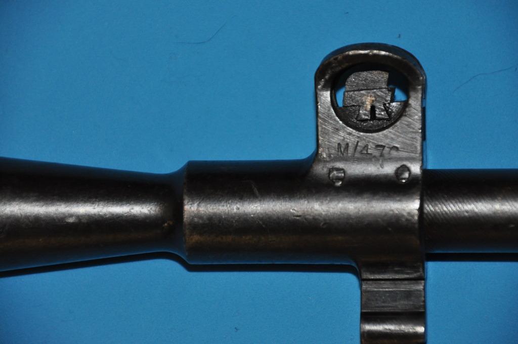

    Why do you think the barrel doesn't match? the flash "eliminator" is BSA manufactured.
    Remove the upper handguard and see if the barrel has lightening cuts.
    Is the receiver a BSA or a Fazakerley?

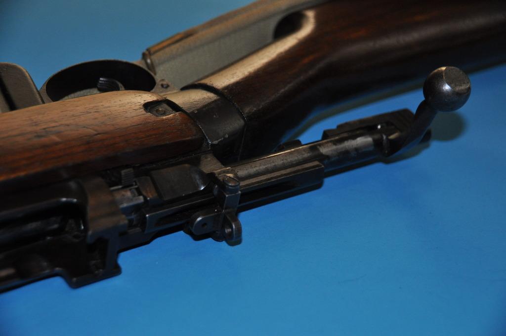

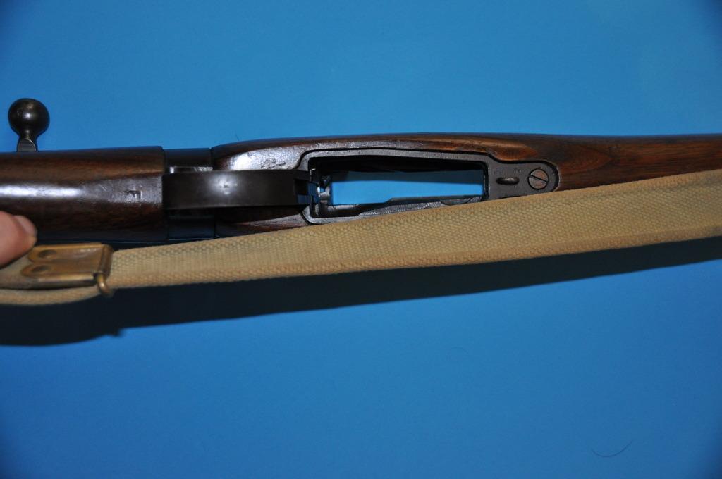

    See your photo, 8. What is that gap through the fore-end - left edge of photo - through which I can see the barrel? LOOKS like a No4 fore-end been reshaped to No5 configuration but the remains of the lightening groove hasn't been plugged and pegged. And the curvature doesn't look anything like the curvature of the fore-end in the book you show (middle pic). That's only my opinion of course, based on absolutely nothing more that experience and on that basis alone, I say that your fore-end doesn't match the book pretty closely.
    On the other hand, your fore-end could be one of those converted fore-ends supplied through Ordnance and used by us in Malaya/Singapore where the wooden insert has come out. But that said, it doesn't look like the one I have got on my lap as we speak.

    Yes, most people who modify No4 forends tend to be too scared to really take some meat off & so have a very noticeable sweep upwards at the front end. Also, the barrel band recess in the replacement forend looks rather inexpertly cut - it's too wide.

    solid bolt knob is correct?

    Do my old eyes deceive me but in photo 8, the fore end taken underneath, you can see where the No 4 wood was cut too far forward and the lightening cut in the timber can be seen.
    I have seen some genuine ones with solid bolt head and others with the smaller No 4 bolt drilling.
