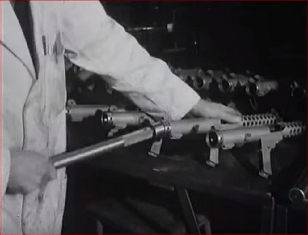

    Interesting film clip.
    I have not seen this reamer before.

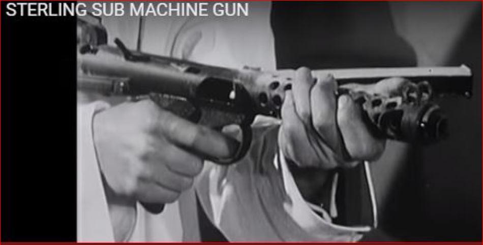

    Do I detect the cocking handle to be back to front before the blown sand test? Have a look. It's the pattern gun that used standard No4 foresight blades for cheapness and standardisation. Alas, shortly after this innovation, a REME Craftsman earned himself a large reward for designing the adjustable blade we all now see.
    That tool is the standard body GO gauge. Used after the spot-welding and induction brazing operations to ensure the free running of the breech block

    A GO gauge! Thanks Peter.
    Yes. The cocking handle is back to front.
