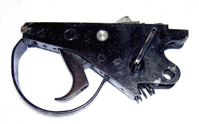

    Thought I had seen all the wrong ways to assemble a Sterling. Then along comes this new one.

    It looks like a flat wire spring from the magazine catch(?). What is it supposed to do? It looks as though it is simply inserted between two parts that don't move. The trigger guard frame and the sear cradle spring base. What a well thought out and manufactured self contained trigger mechanism. And as it later transpired versatile too.

    Yes, it’s the magazine catch spring. It doesn’t do anything that I can tell. Just put there by someone who didn’t know where it really belongs. I am sure you have seen “crunchies” do similar things.
    The engineers at Sterling did a very good job of making the Mk4 almost impossible to assemble wrong. I guess you can never prevent this level of…. er, “creativity.”

    Quote Originally Posted by Vincent View Post
    I can't even imagine it really Vincent...as a "Crunchie" myself, we knew what parts went where on things. Even a .30 cal in a bucket wasn't a problem... This would occur to me to be a later act by a civilian...someone with no actual knowledge. Not someone that owned and shot these regularly... I don't think it would even slip into place with that spring there.
    Yep, the Mk6 is a civilian semi-auto gun. Apparently, it was done by a “gunsmith.”
    It surprised me when I found it jammed in there.
    One of the Sterling companies claims to fame was that you couldn't assemble it wrongly. I have a feeling that the only part that you could assemble wrongly was the cocking handle.
    That’s what I thought too, but I was wrong. I have seen the return springs put in wrong. The small spring inside the big spring and the cup against the endcap.
    I thought this one was remarkable, so I posted the picture.
    You two would enjoy the box guns. It’s a gun someone completely disassembled to clean, then couldn’t reassemble. All the individual parts are in a box. Hence the name. They have a way of showing up at cocktail parties when the owners know you are into guns.
